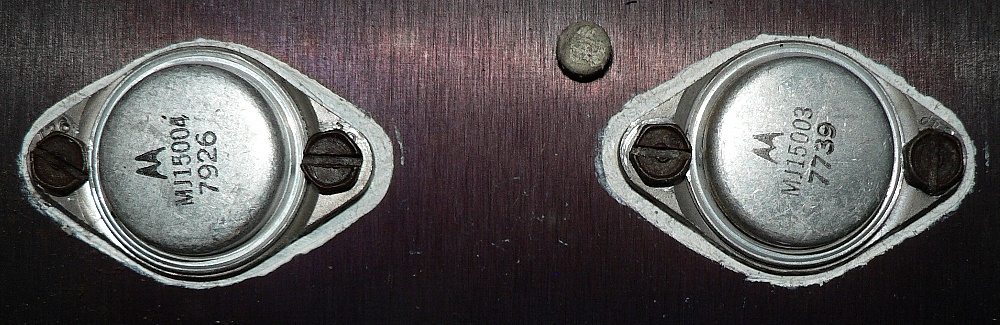

"I'd like to keep the same case (and pinout) and I believe these are different - I'd really like to keep the amp as original as possible."
The pin-out is identical, they use the same die. The 07/57 version were obtained on a selection basis from the same die that produced the 05/55, 06/56.
If you want the original package you will just have to bite the bullet and pay the price (I won't).

Hello Captain G. The rail voltage on the working board under load (or not) is 52 VDC according to my DMM. So far I have not been able to remove the rear heatsink panel that hides the O/P transistors: it's held onto the rear of the amp case by Hex head blind "crews" and I'm damn** if they will budge with the tools that I have. I'm going to try again with a tool a neighbor (40 miles away - we're in the sticks here) is bringing over this early afternoon - local time now is 12:20 so I'll get the part numbers up as fast as I can today. Thank you so much for all your effort and time.

Just a thought even though the amp with one board works and sounds just fine ... does that rail voltage seem a bit low? I have probes but no clamp leads yet ... maybe a poor probe contact?

I used a Model 2 Audire (100 wpb AB) for 25 plus years. The amp was an improved version of the Model 1. Both have oscillation issues that are ground related. Input cables must be 3 feet or less; otherwise the amp picks up RF and fries itself, usually just the outputs.
Later designs were free of this issue, but still have to set up and disconnected correctly. There is no protection circuitry. If you touch the speaker wires together, even if it has been unplugged for a short time, it will fry the innards, usually the outputs.
