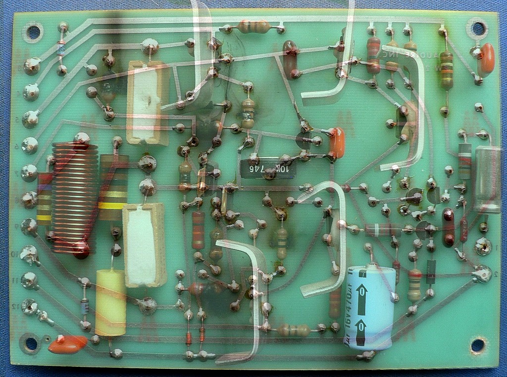

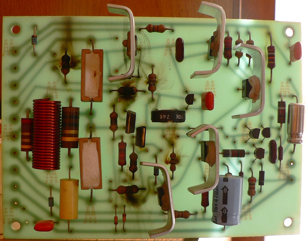

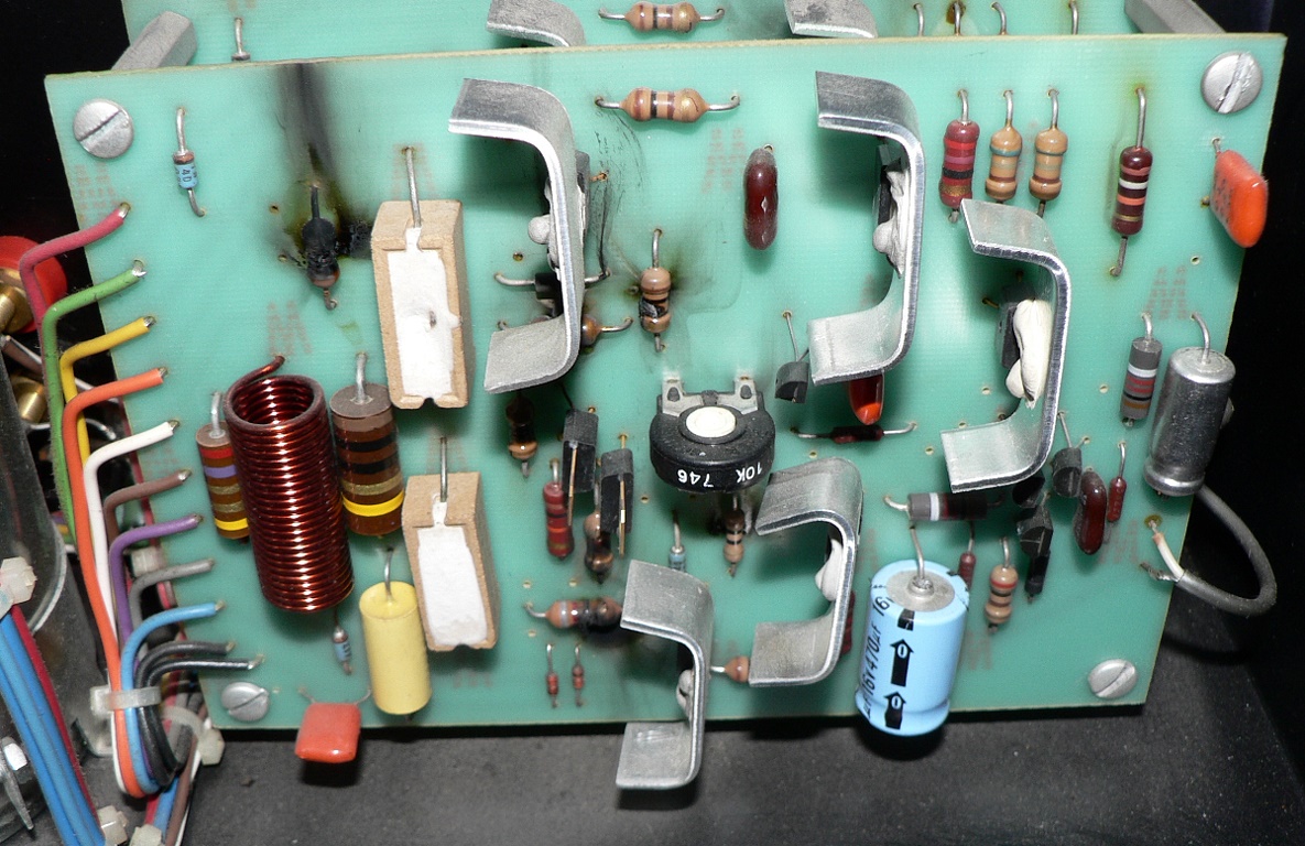

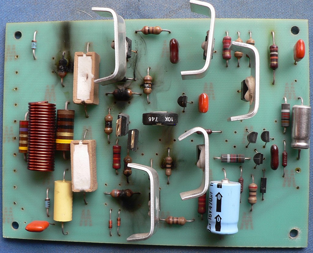

Oooops. Well the result is obvious 🙁 but I'm a bit stuck here. Firstly I don't have a service manual/circuit diagram to refer to and secondly (just as important and maybe more so) I don't know what caused the kaboom. I'm not tech savvy enough to look at the board and figure out where the problem originated but I know there are members here who can pull rabbits out of hats so I'd really appreciate your advice / suggestions. It's an opportunity to upgrade the components now that I'm repairing the amp (Audire 2) and all suggestions on improved components would be very welcome. Please remember I'm pretty new at this so if you can spare the time to download the photo and maybe put arrows on it with "here" and "here" kind of thing that's be especially great.

Set a digital multimeter if you have one to the diode measurement setting and check all transistors, in one direction you should get around 400-500 on the display and the other you should get open circuit.
If all some or combinations show dead short, you have found some broken transistors.
First off thank you Tekko. I do have and know how to use a DMM and VOM and can troubleshoot to a decent level. What I'm not good at (yet) is translating a board into a schematic and from that experience and 'know-how' understanding just where the functioning circuit broke down. As you can see roughly one half of the board was not affected and all the fried components are on the other half .. but I just don't have the technical experience to be able to say, "ah, yes, it probably started there when xyz failed".
Thanks too to a.wayne: the problem is it just happened after being taken out of (dry) storage: it was correctly wired (short speaker cables etc.) with all connects double checked before firing up (no pun intended - I'm a bit fastidious about things) and then it just when poof. I know the circuit has about as much protection as a paper hat in a thunderstorm 🙂 but I always thought that maybe that circuit topology worked so well because of that fact - i.e. not being laden down with obtrusive to sonics protection circuits. But then again, I am a newbie at all this.
I can replace all the burned out parts when I can ID them all (no schematic or facts available at this time) but since I'm going to rebuild the board I thought it a good opportunity to use in the appropriate places in the signal path those comonents that have improved sonic characteristics over those used way back when the amp was manufactured. 1% R's here and an 'xyz' cap there sort of thing .. or am I thinking wrong here?

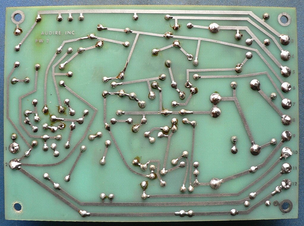

I'll strip out the board and take a photo with back-lighting to show the tracks in relation to the components - just hoping I guess that some member had prior experience with this particualr amp. BTW all resistors look to me like 5% standard old school types and the caps are probably at the end of their service life by now anyway. Fortunately the huge and expensive PSU smoothers look to be in good shape.

.... Just a few things
first the unit will need a serious recaping
then you might as well check if the cheap carbon resistors are drifted from original value ( can happen )
then i seems that the blown resistor belongs to the base of one of the outputs in this case expect both outs and drivers are to be gone ....
a few tips
*your remark on less protection is cleaner sound is correct
*often one thing that will take you to kaboom is the bases ( mounting kit ) of the output transistors they often get loose in the pin area not the screw
* it seems that the amplifier has no thermal compensation ( if it was mine obviously and surely i would change that )
*Practice have shown that in long run amplifiers that have vertical pcb's and no ventilation fail more often since pcb's cannot dissipate heat resulting soldering issues ( something that easily can be changed in your case )
* one thing that we don't do now days is to run cables from PCB to output transistors modern transistors are accommodated on the PCB since you don't have any other option but cables the only thing that you don't do is to twist B-C-E together that it shelf can be a number one issue to take you to heavy oscillation. keep some distance between the cables
* finally and in this scheme of amplifier an open trimmer ( or dirty ) may take you to kaboom if a safety resistor is not fitted to avoid this ( the amp looks too simple to have this function also )
that's about it i actually looked for a schematic and it doesn't seem to be possible to find .. if you can hand draw one that is correct many will give you some extra help except the above
kind regards sakis

Currently the amp is using MPS U57 and MPS U07 which I'll replace. I know these are slow transistors and really old: I wouldn't mind using faster >5MHz transistors but I'm concerned about the possibility of oscillation with faster transistors. I've seen various types suggested but (as usual) what works best in one circuit isn't necessarily best for another - and I'm just not tech-savvy enough by a long way to read this circuit and know what would be suitable replacements. Can someone please advise me. Many thanks, Mike.
