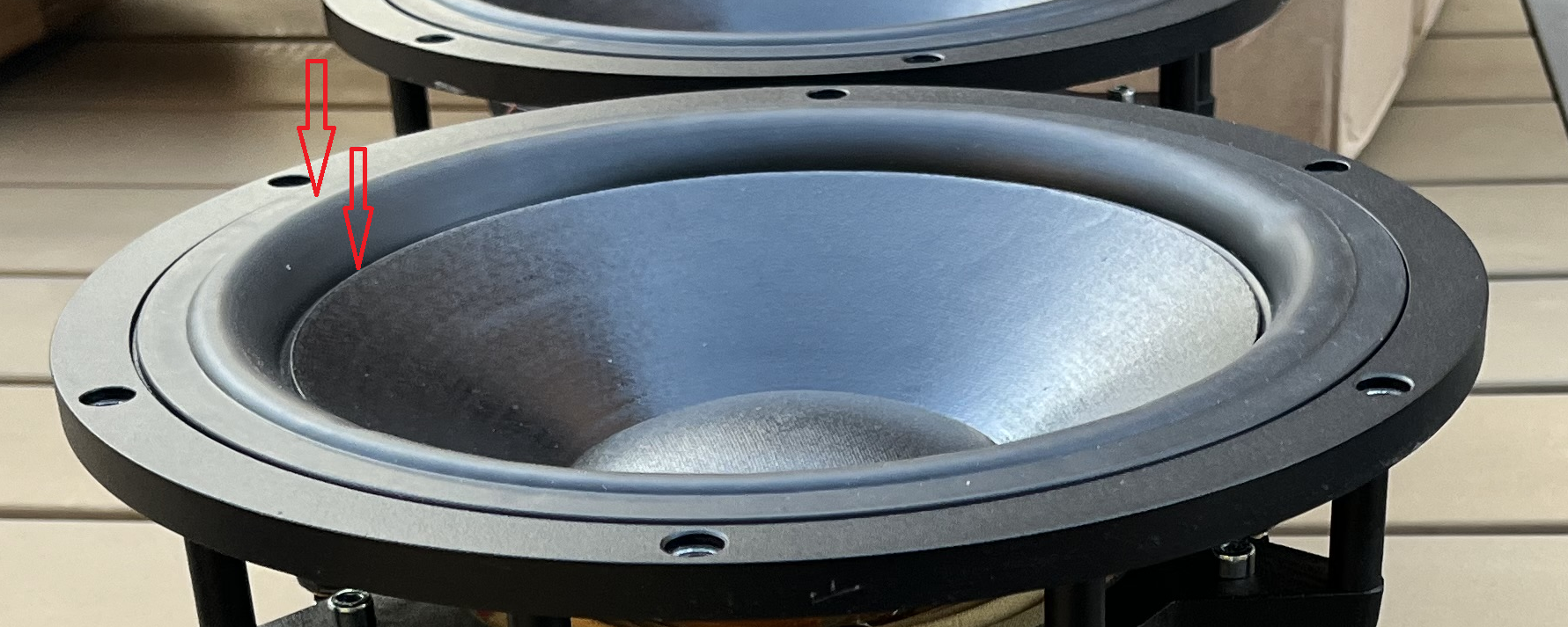

From the pictures it looks like these are damaged. The cones appear to have been pressed inwards for an extended period of time during storage resulting in a massive case of cone sag.

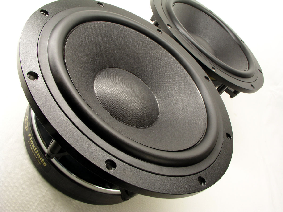

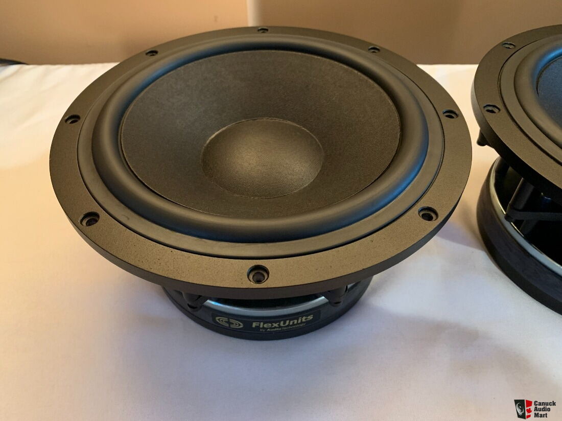

I am affraid 5th element is right , this is what a normal unit looks like , the cone is level with the outside border of the driver
a set of new surround will fix it

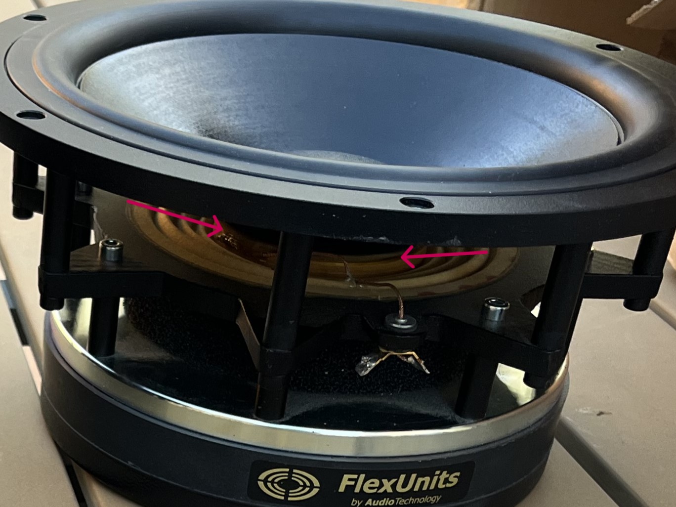

You can see the cones and spiders are sunken in from the pictures you have provided. The spiders are supposed to be flat but the part where the coil joins is much further in than the edge of the spider.
This doesn't usually affect T/S parameters all that much especially in woofers with long coils.

It looks very much like 5th element is correct from the pictures.
There appears to be cone sag

The problem is not the surrounds, but they might have lost they're flexibility.
The problem is the spider is sagging, it should be flat. Just compare the pictures i added (look at the red arrows).
That causes the cone to sit below where it should, the surround gets stretched and deformed. The voice coil is off center in the gap, and sits below where it should. Which will result in very varying BL(x) and other excursion related issues and distortion even if the drivers are physically working.
The sunken down surround is just the easiest place to notice it visually.
Does not matter if mr.Skaaning replied in a message, the visual signs are all there.
