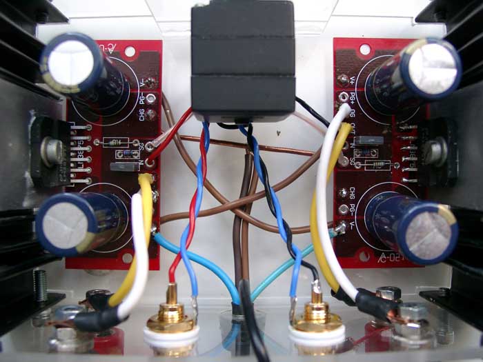

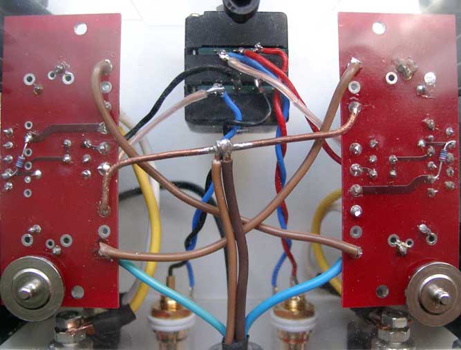

recently, i constructed another chipamp using Peter's boards and with similar connection as the Patek (with cheaper parts) ...
Unfortunately, there is no sond comming out of speakres except significant buzz in th eright speaker - the left channel is totally silent. I also noticed that the chip on buzzing channel is getting very very hot...
any idea what the trouble might be?
Thanks.
