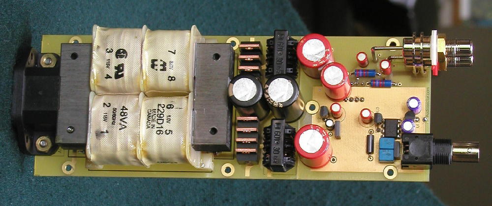

audio Sector nos DAC transofrmer
Hi Peter,
In your pics of the DAC your using a Hammond 48va 16v transformer. Would a 15v be ok since the board takes 5v regulators. I'm asking because you seem to be specific on you parts choices.
Thanks,
Vince
Hi Peter,
Thanks,
Vince
The transformer I'm using is 2 x 8V AC, which gives approx 12V after rectification, and then there is another 1V drop on passive filtering. As long as you get 10V before 8V regulator from your transformer, you should be OK.
