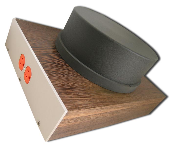

Quite by a coincidence, Audiosector has just came up with a new product: 😉
http://www.6moons.com/audioreviews/240_117/240_117.html

The one in a review works with 115V as well. Main idea there is the advantage of balanced AC power: http://www.diyaudio.com/forums/showthread.php?s=&postid=897011#post897011
