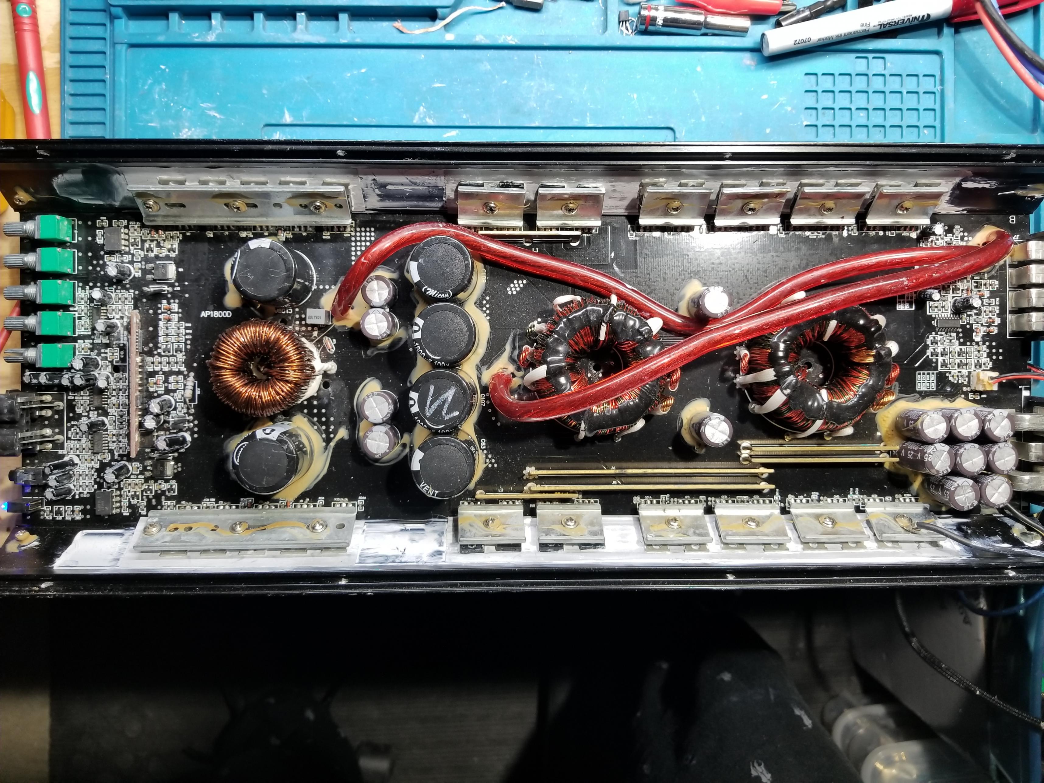

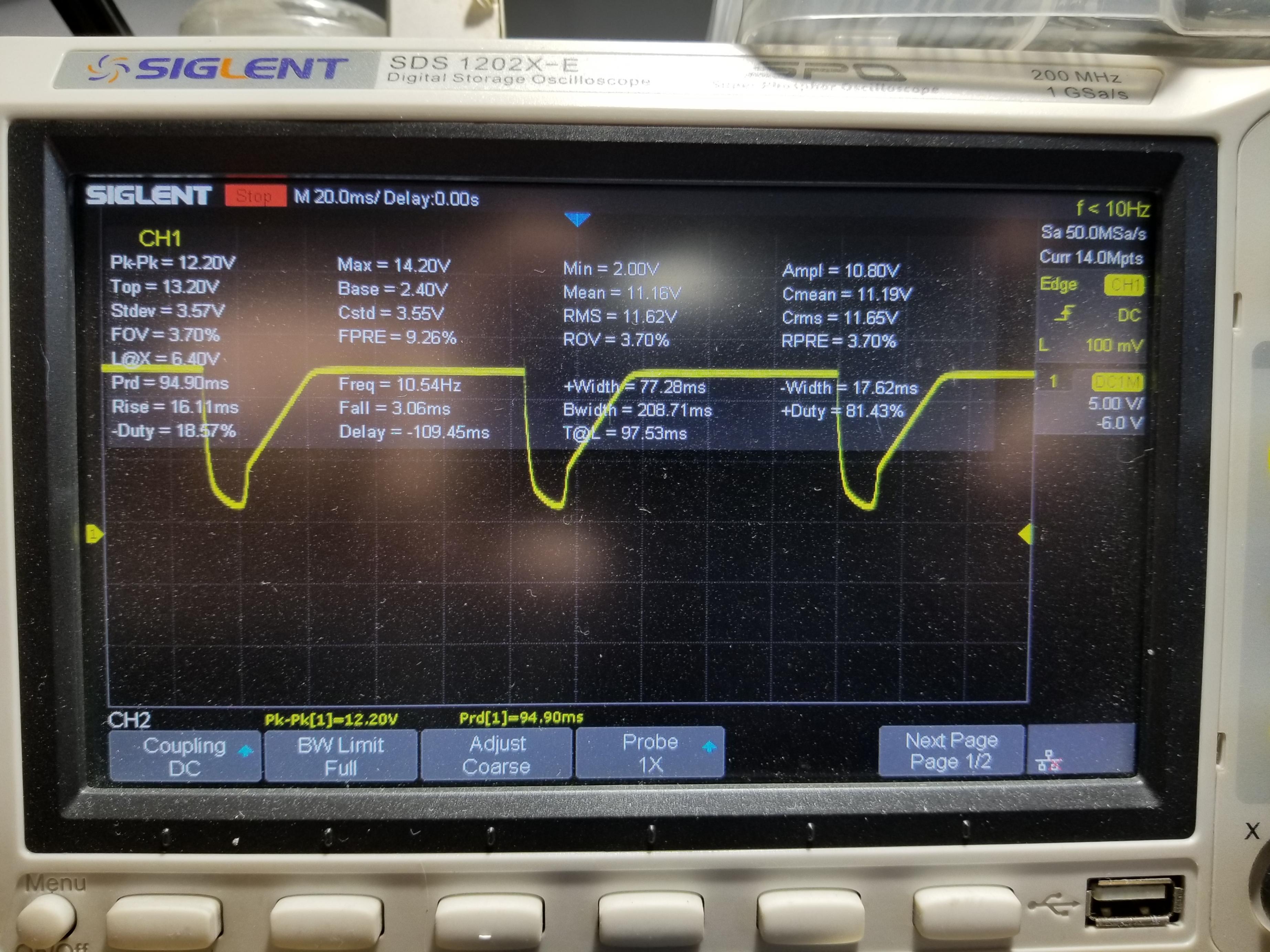

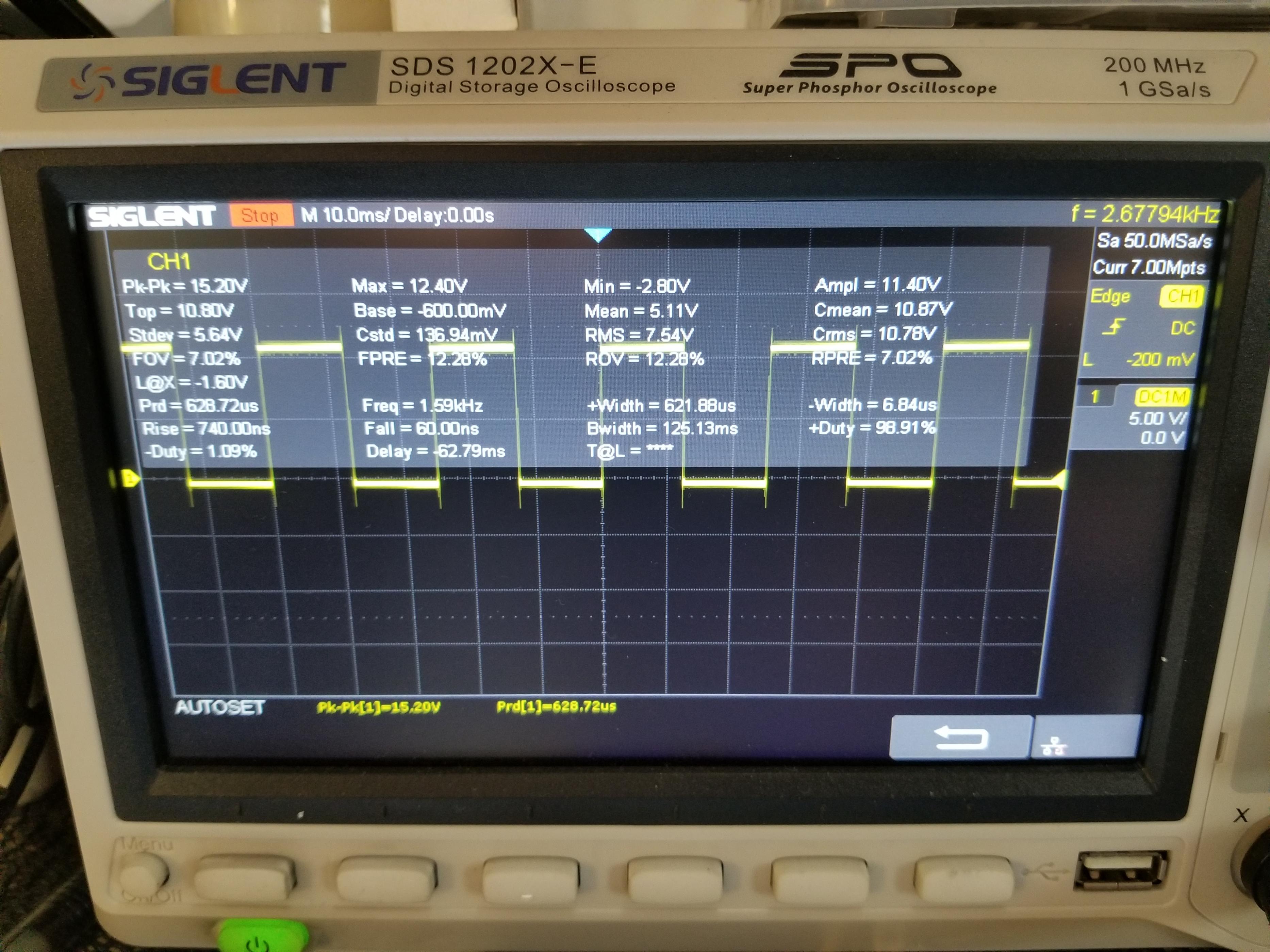

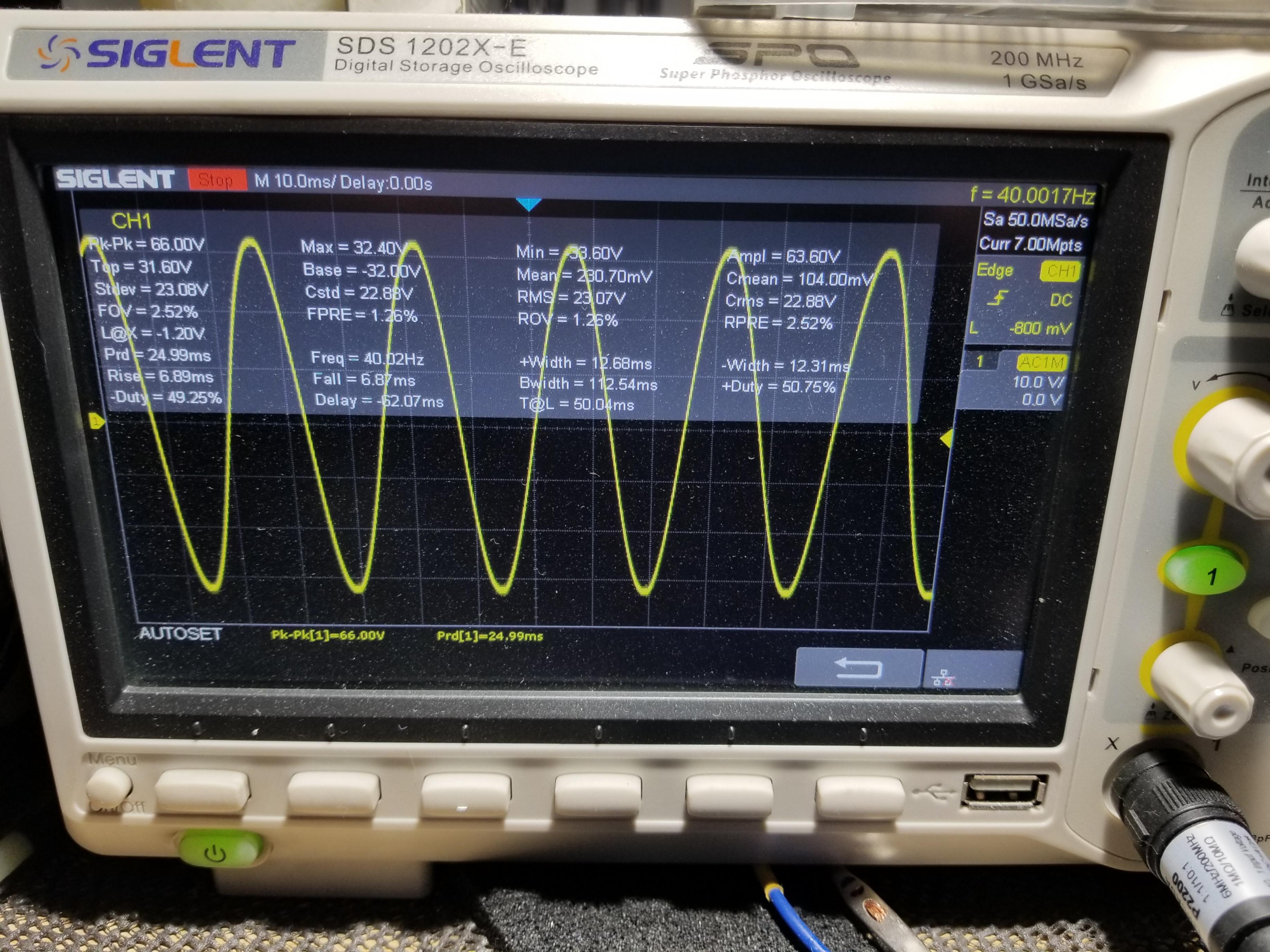

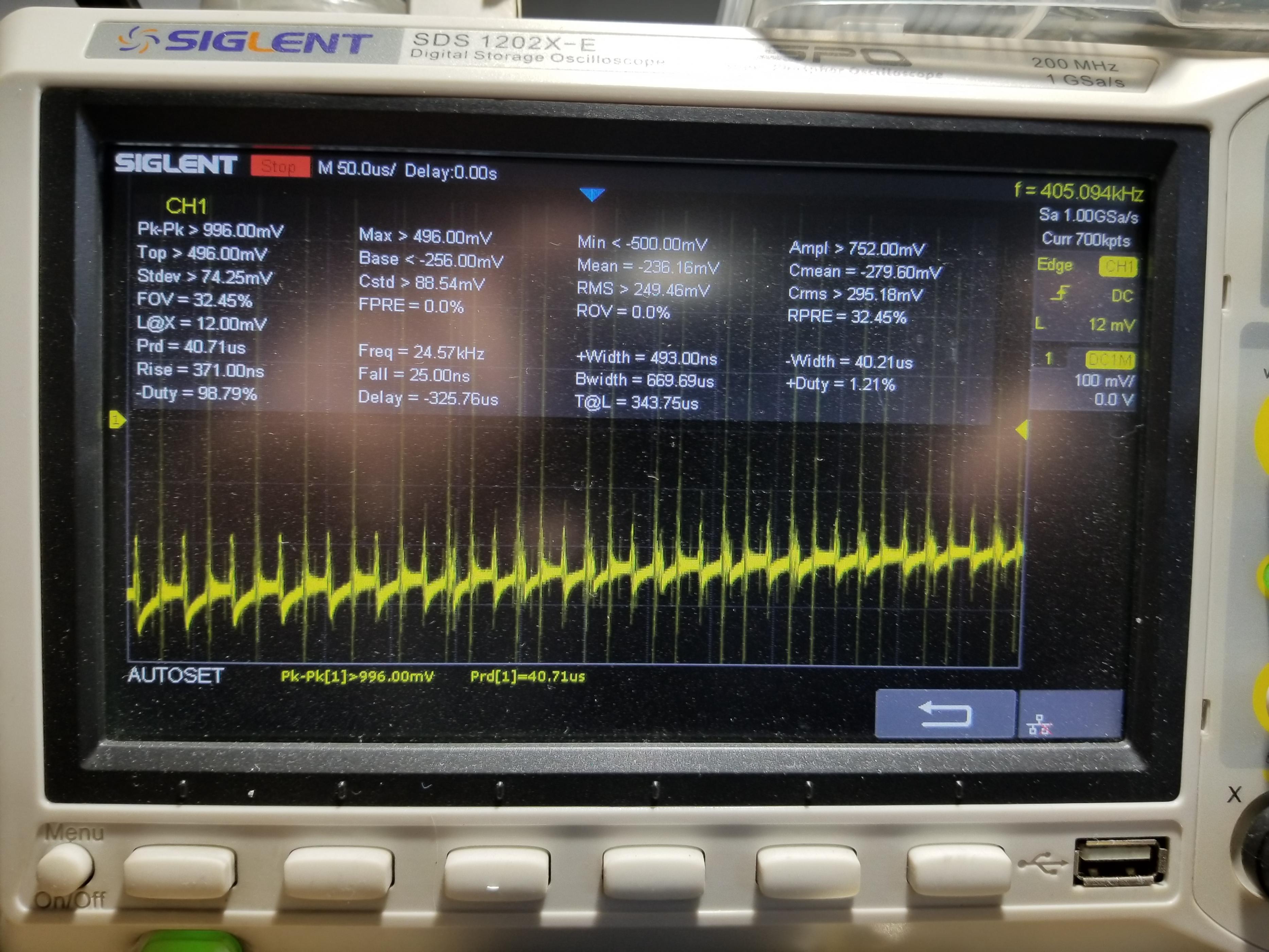

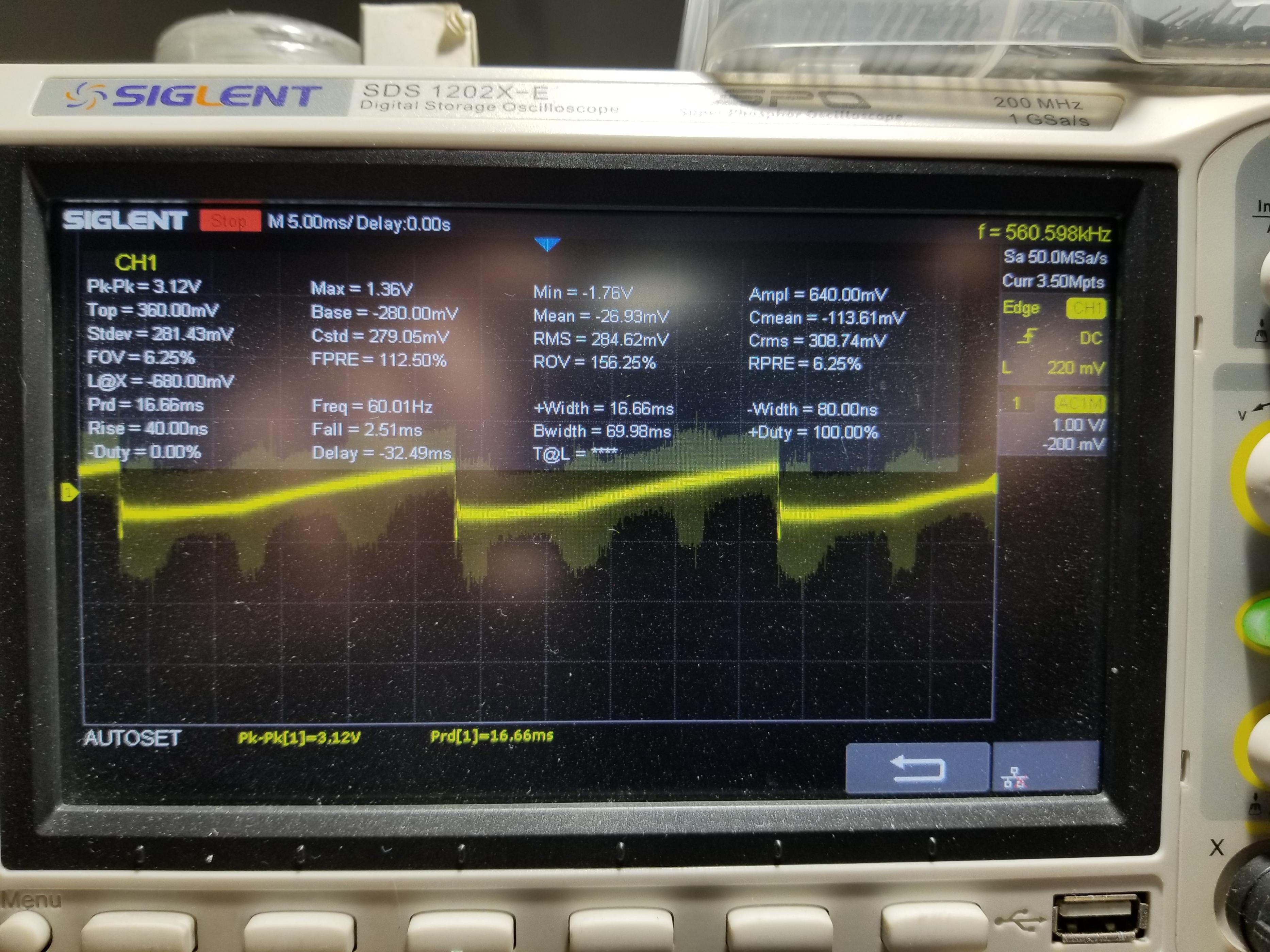

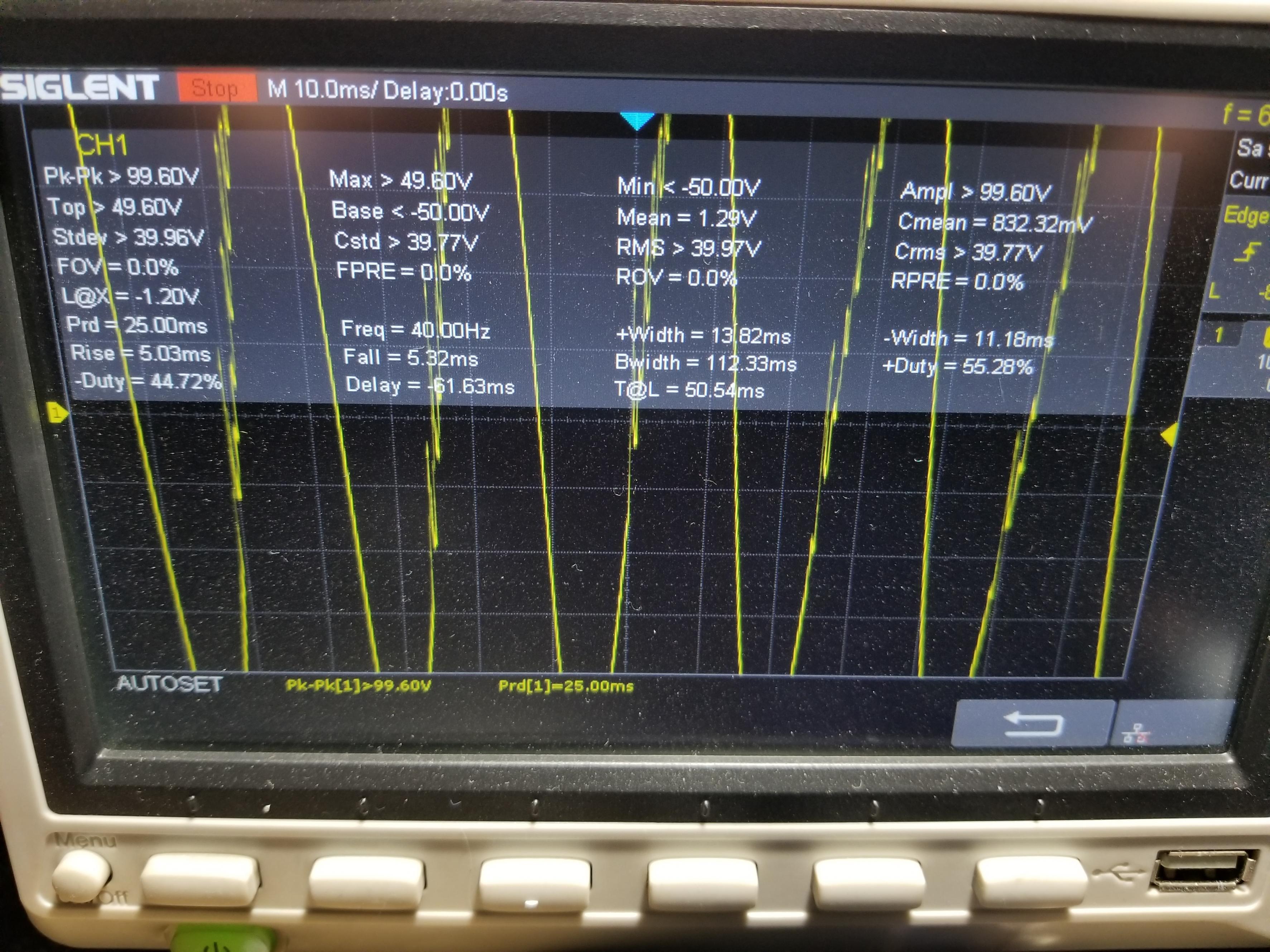

I have an audiopipe apmi 1800.1d that Powers up fine draws around 2.2amps of current at idle. All seems fine until I start to adjust the gain pot, the signal beacomes very strange. Sometimes it will even jump into protection. The signal despite 0 gain seems high to me. The gain pots have all been changed. As well as the power supply and output transistors.
