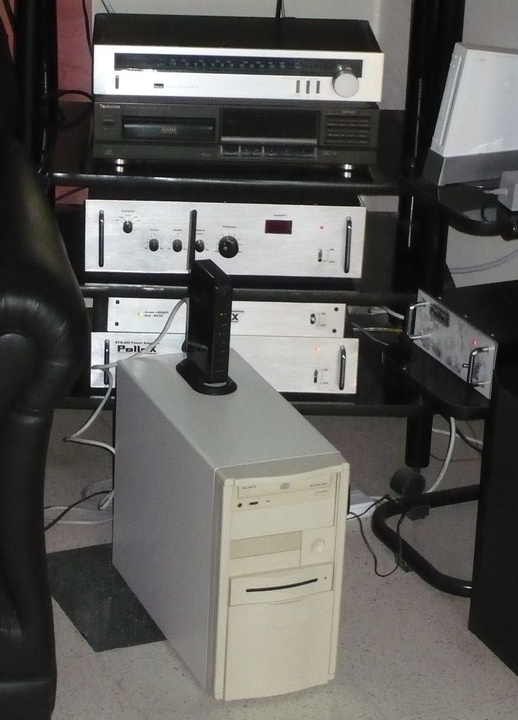

I've been working on this machine:
It is a Pentium II Celeron 333Mhz with 320 Mbytes of RAM and 8 Gb HD. It is running MPD 0.18.x on Ubuntu 14.04 Server Minimal Install and I can manage it using SSH and my cell phone can handle the MPD interface .
This pile of crap wasn't able to run W2K without a lot of swap, and now it is wirelessly connected to my home network and it can play music without any swap at all (don't ask me about the sound card I'm using, because it is even older than the PC... it is a SB AWE-64 ).

Yep.... I love Linux.... and it took about a couple of hours to complete...
