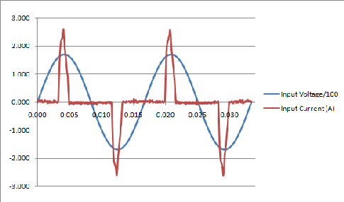

So, how does a standard amplifier power supply (tx-bridge-caps) actually kick junk back onto the mains ?.
I can see that the impulsive power draw (caps charging periods) will cause mains supply peaks flattening which could then affect/effect other items connected to the same mains circuit.
With snubbering of the secondaries, is there no oscillatory behaviour of the secondaries to feedback to the primary side supply ?.
With sec snubbering, does the transformer/primary appear as a resistive load during the charging periods, and only cause mains supply circuit IR losses/droops/flattening ?.
As I understand it, the sudden current demands and sudden current shutoffs causes half cyclic IR drop (no big deal), BUT also excites harmonic ringing in the mains supply system, due to parasitic reactance in the supply system.
So, this pulsed load ought not by itself present as a problem, except for real world conditions, ie MEN distribution system cabling and cable routing, including proximity to metals.
Ringing on the mains is a consequence/by product of the pulsed load, and it is this mains supply modulation that finds it way into audio gear.
Different mains leads could well change the coupling between the pulsed load and the reactive mains supply, and the (minor) changes in mains harmonics then affects/effects the other audio gear on the circuit differently.
Just ask Mark Johnson, the cure for ringing is snubbering...... at each connection/interface to the supply chain, ie amp mains input, wall socket, meter box breakers, street wire mains entry connection !.
The question is what snubber values across the mains are appropriate ?.
Has anybody tried any of this ?.

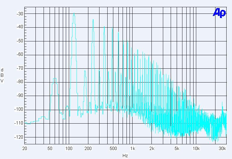

Attached is an FFT of the noise from a power supply. Odd order harmonics are created by transformer saturation. Even order harmonics are from rectification. The HF bounce is from the filter capacitor's resonance. This is passed by the transformer back to the AC line, limited only by the transformer's bandwidth.
I have lots more measurements but they pretty much all look like this whether you are measuring voltage or current before or after the transformer.
The AC source is a low distortion (.05% or less) power amplifier driven by an even better signal source.

So what's up with that graph? Shouldn't the line frequency be referenced to 0dB with the resulting harmonics falling off to the right? Just wondering (or wandering! :D).

If -30dBV on that plot corresponds to 32 millivolts of unwanted "signal" on the power supply rail, and if the circuit being powered has modest PSRR of, let's say, 30dB, then the equivalent unwanted "signal" at the input is 1 millivolt. Big enough to completely swamp out a phono cartridge input, even a high output MM cartridge.
Conclusion: when building a preamp, use one or more stages of well-designed, well-implemented voltage regulator(s) to drop the mains noise significantly ... AND/OR design high PSRR circuitry, much higher than 30dB.
Conclusion: when building a power amp, apply additional filtering / regulation / capacitance multipliers to the first stage(s) to increase their PSRR ... AND/OR design high PSRR circuitry, much higher than 30dB.
Mark,
Unbelievable (For this thread) you got it all right and I completely agree with your conclusions.
Please note a second R C stage can drop the power supply noise by easily another 30 dB. This should hint (like a sledge hammer to the side of the head) that preamp power supplies should have different designs than those for power amplifiers.
