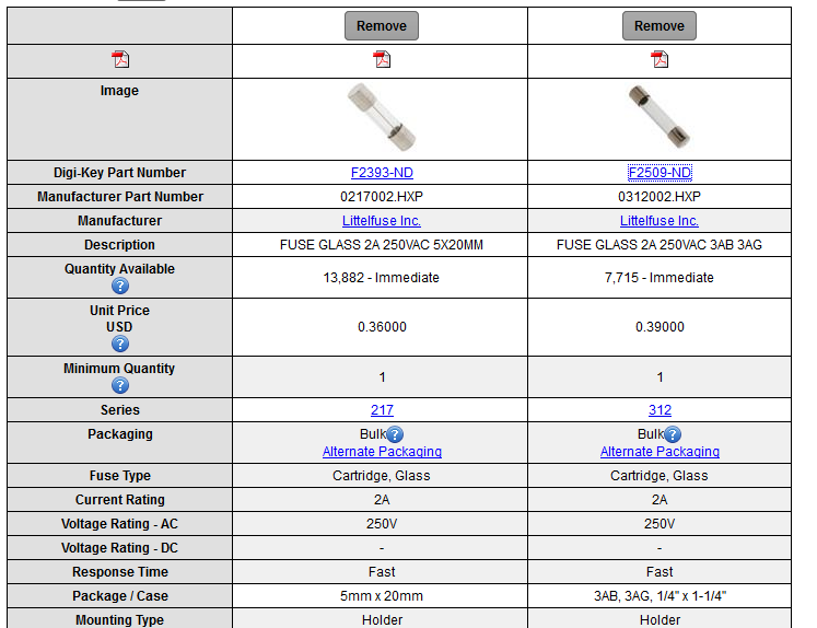

.... the smaller 5 x 20 size fuses, which have slightly less resistance as a previous poster mentioned.
Is that correct? The resistance determines the fuse rating through I(squared)R, so a particular fuse rating determines the resistance, not the physical shape, right?
Hi Jan, I hope it is safe to trust manufacturer's datasheets; maybe it's even safer to be skeptical and only trust one's own measurements.
But if we do decide to trust manufacturer's datasheets, then the stated "cold resistance" for a 2 amp, 250V, 5x20 fuse is different than the stated cold resistance for a 2 amp, 250V, 1/4" x 1 1/4" 3AG fuse ... from the same manufacturer. One of them is 1.69x the resistance of the other.
Here are the two fuses whose datasheets I read, to extract the "cold resistance" numbers. Anybody could do the same; it takes no special skill or insight to look up a couple numbers in a couple datasheets. Other DIYers may wish to perform the same pair of lookups for other fuse manufacturers, such as Eaton / Cooper-Bussmann. It isn't difficult.
