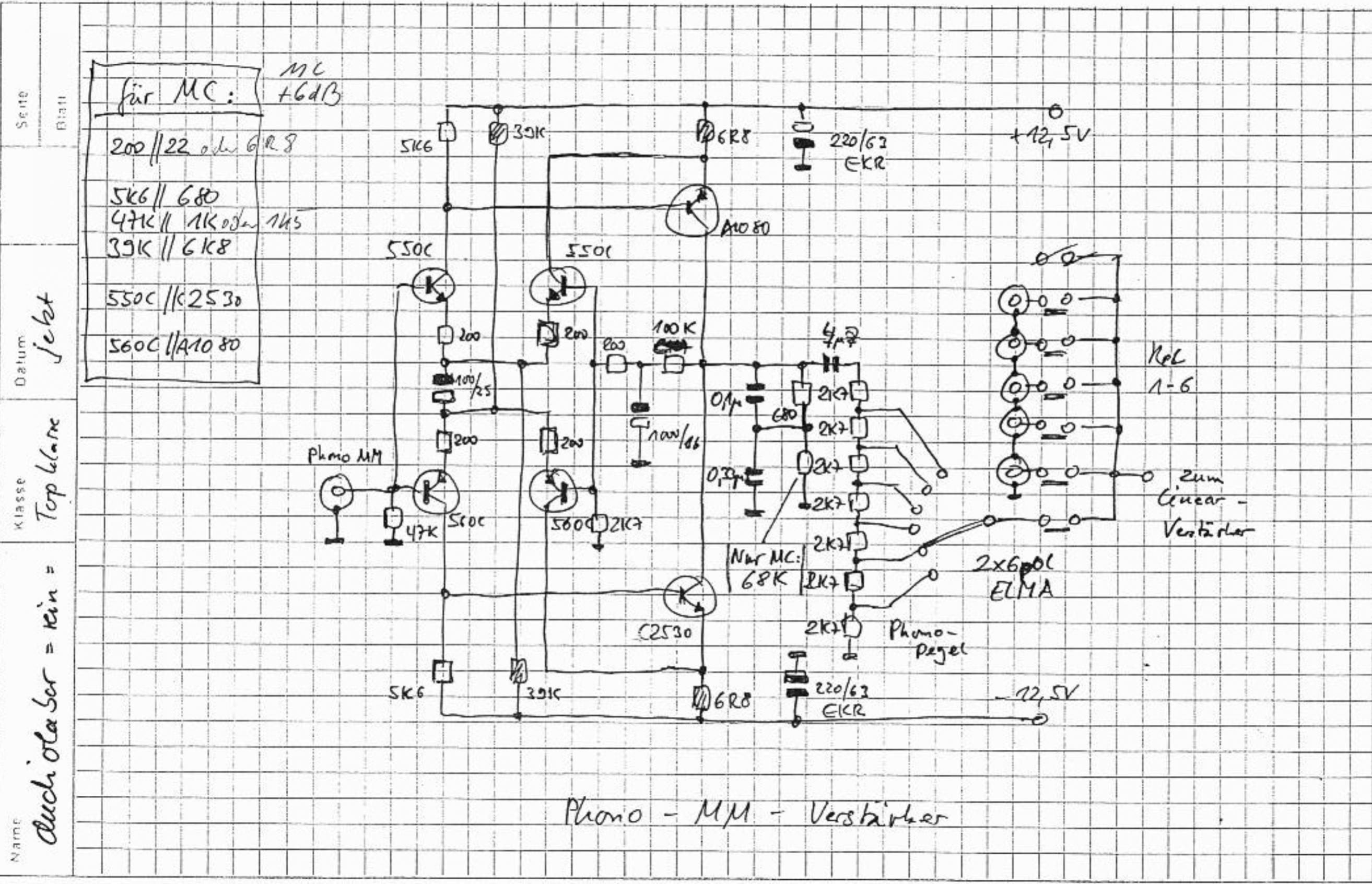

Looking at the schematic I think both MM & MC share the same phono input (although there are two pairs of RCAs). I will probably need to use impedance/capacitance plugs to match the cartridge and use the gain control to adjust. So I think the default is 47kΩ.
