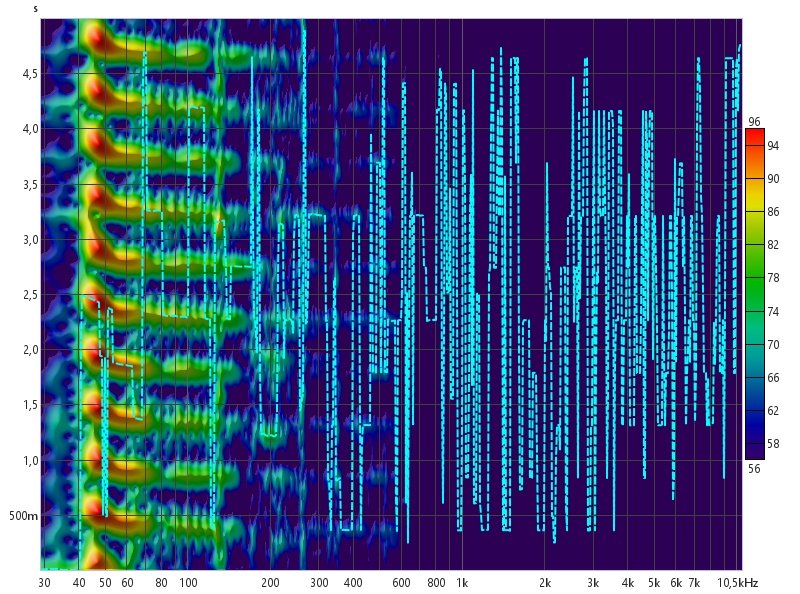

Perhaps. This is what I recieved on recordings with 24Mhz xtal and xo on XMOS in SMSL, it uses external clock to generate audio signals and external clock for DAC. Difference in peak energy time, predominantly after 2KHz and up.
Pointless to post measurements without details about the measurement setup.

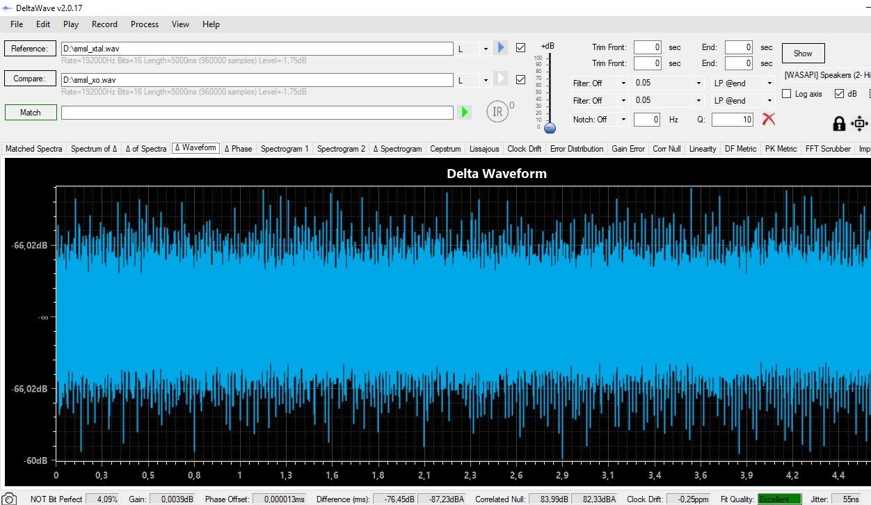

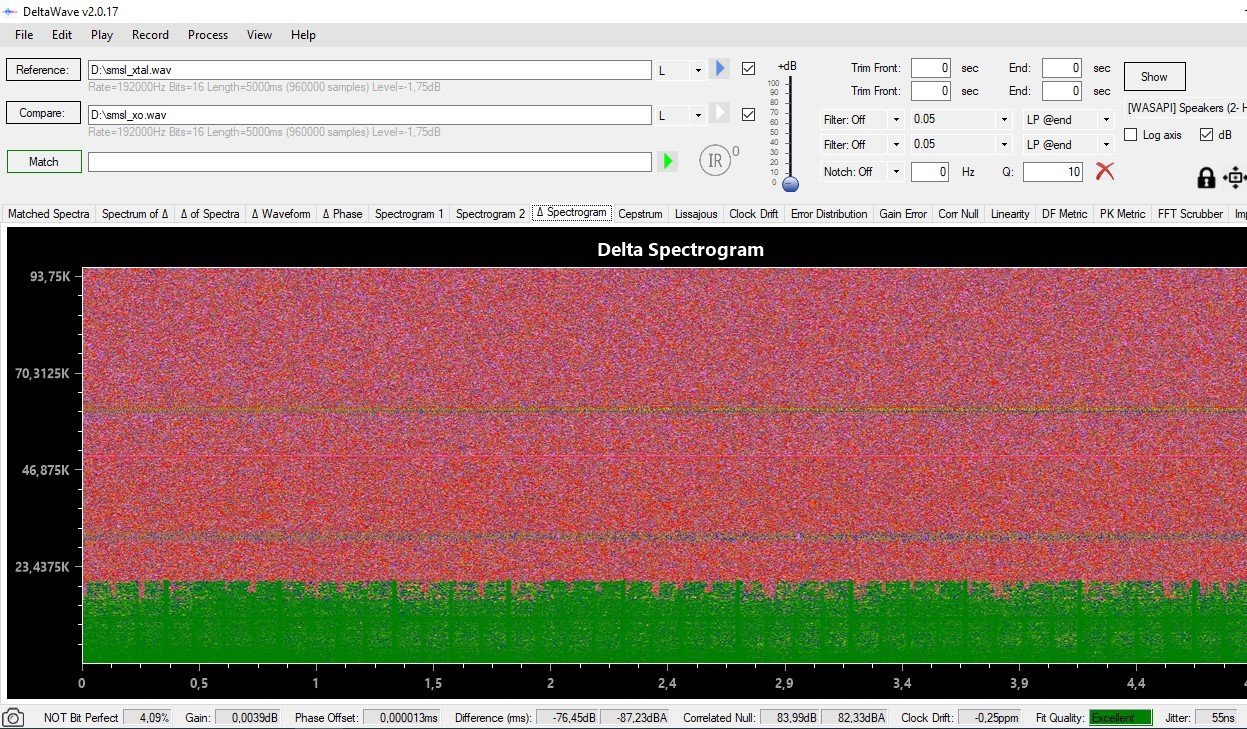

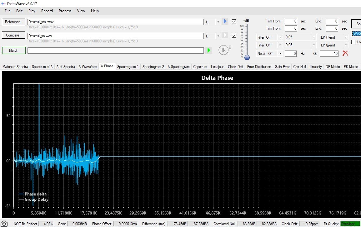

I suppose that I can help with improving device in start post, so let it be one more post about clock swapping here. So, we have one measurement instrument. It is WM8782S + SA9227 with NDK clocks, both with linear supply, we don't care about it specs because we search the difference between recordings at its inputs. As I said, the main difference in sound stage, and this wonderfull tool Delta Wave shows it. It is all about phase characteristic of sound, that's why it doesn't belong to SINAD measurements. So here a screens between difference in measurements (in real life it much better, after recording with this setup it is worse). XU316 XMOS with 24MHz xtal and xo in SMSL DAC with external MCLK. The DAC is already upgraded, with good linear power supplies.
about phase ? If you want you can make such a recording and jugement and hear by yourself, it is not difficult. It tells very muchdo not tell much.
you can made it byself, just swipe xtal on XMOS board and record it.Can you post both recordings together with the original.
Your recordings seem to be very short and there are odd spikes in delta phase. So just to double check can you make 60s recordings and post them.
