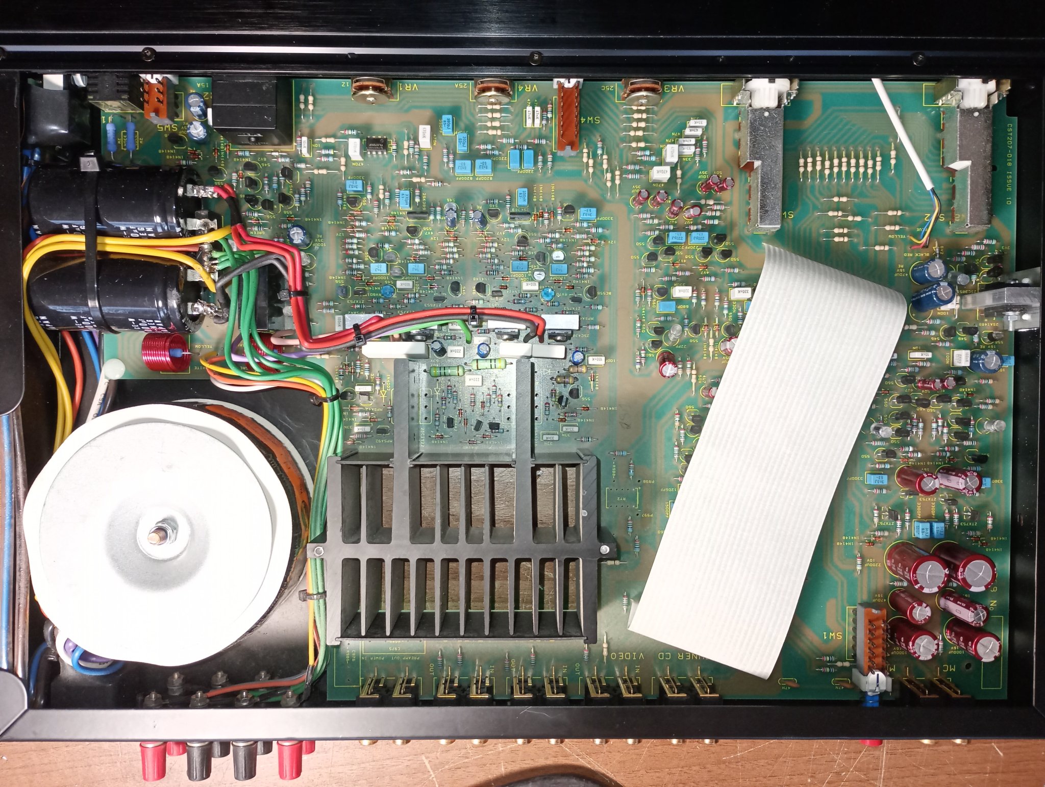

Audiolab 8000A popping fuses
Image of the entire amplifier board as well as hi-res output amplifier board.
I also put the scope on the power amp input - (junction of the 100k and 4k7 resistors) to look for the switch-on pulse from the pre-amp as described in the maker.pro thread I referenced in my previous post. Sure enough, at about 4 seconds from power-on there was a 100ms 12v (!!) pulse into the power amp. I expect that would overdrive it horribly and potentially trigger oscillation?
Googling about problems with Audiolab 8000A/P/S, history shows that everyone has had problems with decoupling capacitors on the amplifier at one time or another - these are blue Elna RE2 4u7/63V electrolytics on the left and right side of the ballast resistors of the output transistors as well as 47u/16V in parallel with 4V7 zener diodes as voltage references of the constant current source BC846B for 2SK389. Actually, all the ELNA RE2 type electrolytics in the amplifier had gone low capacity/high ESR (dried up, due to the heat and age), so change them, if you haven't already.

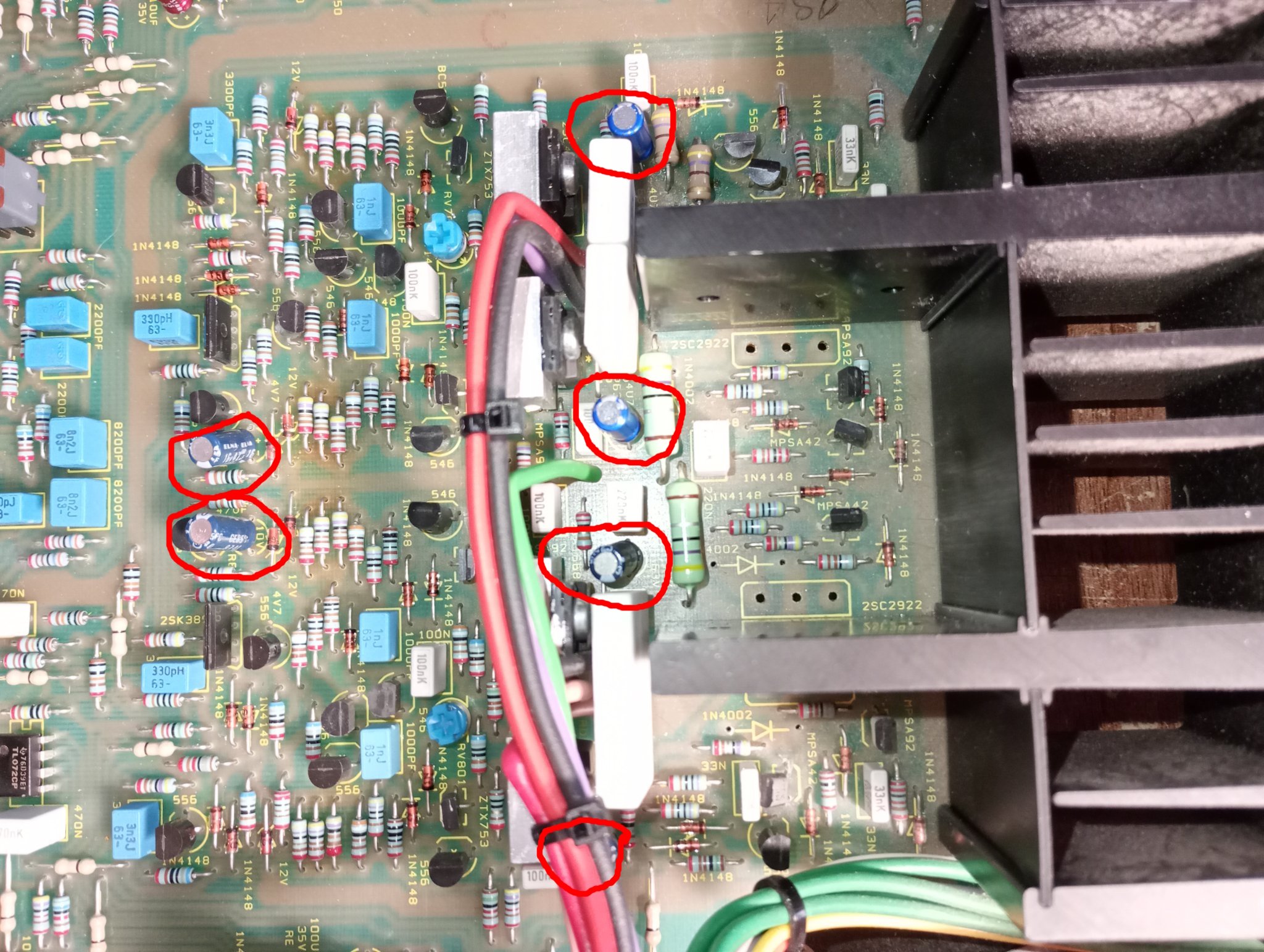

OK, I changed the six capacitors but still getting oscillation.
It does look like the frequency of the oscillation has changed and in the brief time I allowed it to happen the scope frequency counter said about 20kHz whereas before I think it was in the 300kHz area.
I then tried some 47uF caps on the 12v zeners that supply the differential stage. That didn't stop the oscillation either but it did keep those rails clean during oscillation - beforehand they got very noisy with about 1v of noise on them.
So, still stumped. I still wonder if this could be due to running via the DBT but I'm very reticent to try without!
Any ideas appreciated!
The frequency shift at which the amp now oscillates in the kHz range is a consequence of better decoupling with the new capacitors. Layout and decoupling on this amplifier is very poorly executed. In order for the decoupling to be carried out (at least to some extent, without butchering the pcb), I suggest that instead of 4 x 4u7/63V, you put approx. 470-1000uF/63V (the largest capacity you can fit into the existing raster, taking into account that those with a smaller radius and toller are better, try to choose those of 120°C). On the bottom side of the pcb, put in parallel over those electrolytes approx. 100n-1u/63V film capacitors. In theory, these capacitors should be as close as possible to the electrode of the output transistor which is connected to the power supply line (in your case it is the emitter of 2SA1216/2SC2922 because the output transistor is essentially a Sziklai pair, a compound of 2SC4382/2SA1216, or 2SA1668/2SC2992 acting like a single transistor.
Do the same for the 4 x 100n film capacitors on the left side of the 22Ω resistance (to the MPSA42/92 predrivers) on the +/-44VDC supply lines, same/similar values for the electrolytes, put the existing 100nF/63V film caps in parallel with the electrolytes on the bottom side of the pcb .

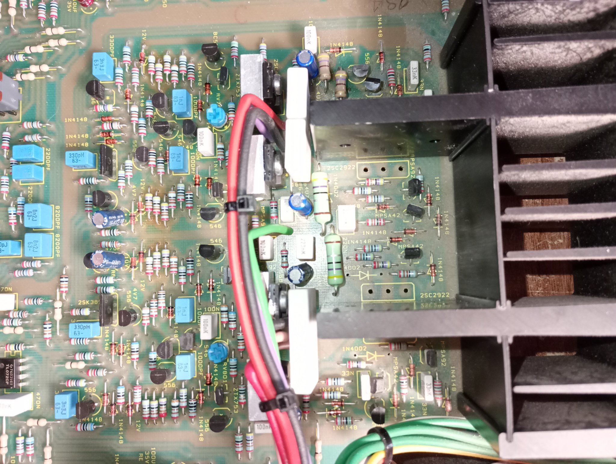

After a long delay I've done these changes, although 100uF was the largest I could fit at the suggested locations which is obviously much lower than recommended. I removed the feedback capacitor changes I made and I still have oscillation.
Next step is to add back the caps on the zeners for the 12v supply and see if that helps. After that I'll increase the 47pF caps in the feedback loop.
Further update, and a curious thing....
I've not put the 12v supply decouplers on yet but I have tried changing out the 47pF caps on the feedback loops.
A curious thing (to me) in the design is that the feedback loops come via the speaker protection relay and for both the relay contacts normal/off (and headphones) position and the speakers connection there are two separate sets of a 3k3 resistor paralleled with a 47pF. Not sure why one set is not used here.
Anyway, I found I had to increase the 47pF to 220pF to stop the oscillation. BUT I only changed those caps on the normal/off paths, The amplifier now comes out of protection and the relay switches over and is stable on the loop with the original 47pF caps.
It looks like something the power-up process does (I've previously said there's a 12v pulse delivered by the pre-amp on power-up that might be the cause?)
Any thoughts?

Thanks both. I realised the reason for the two separate sets of 47pF/3k3 just after posting.
The situation now is that changing the 47pF caps to 220pF (currently only on the lines connected to the normal/headphone/power-off side of the relay) the oscillation at power-on is quelled and the protection relay does operate about 4 seconds later meaning the feedback lines then go via the 47pF sets. The amp seems to stay stable.
At this point I tried measuring the various voltages against and found that touching the DVM probe on many points around the differential pair and the next set of transistors caused oscillation to start up. Ok, that won't happen in normal use but seems to indicate some inherent instability still? I might try changing the other 47pF to 220pF to see if that improves matters.
All the power amp electrolytics have been changed and the suggested new ones added albeit some of lower values than proposed due to space limits.
The initial oscillations seems to be provoked by the 12v pulse the preamp kicks out about 4 seconds after power-up but are now quickly stopped. Both channels are the same so doesn't seem to indicate a fault. The protection relay operate at about 8 seconds.
I'm still trying to get my head round what might have changed since the amp was new. As indianajo points out there's a lot more RFI these days but the correlation with the preamp startup pulse means that doesn't sit squarely with me.
