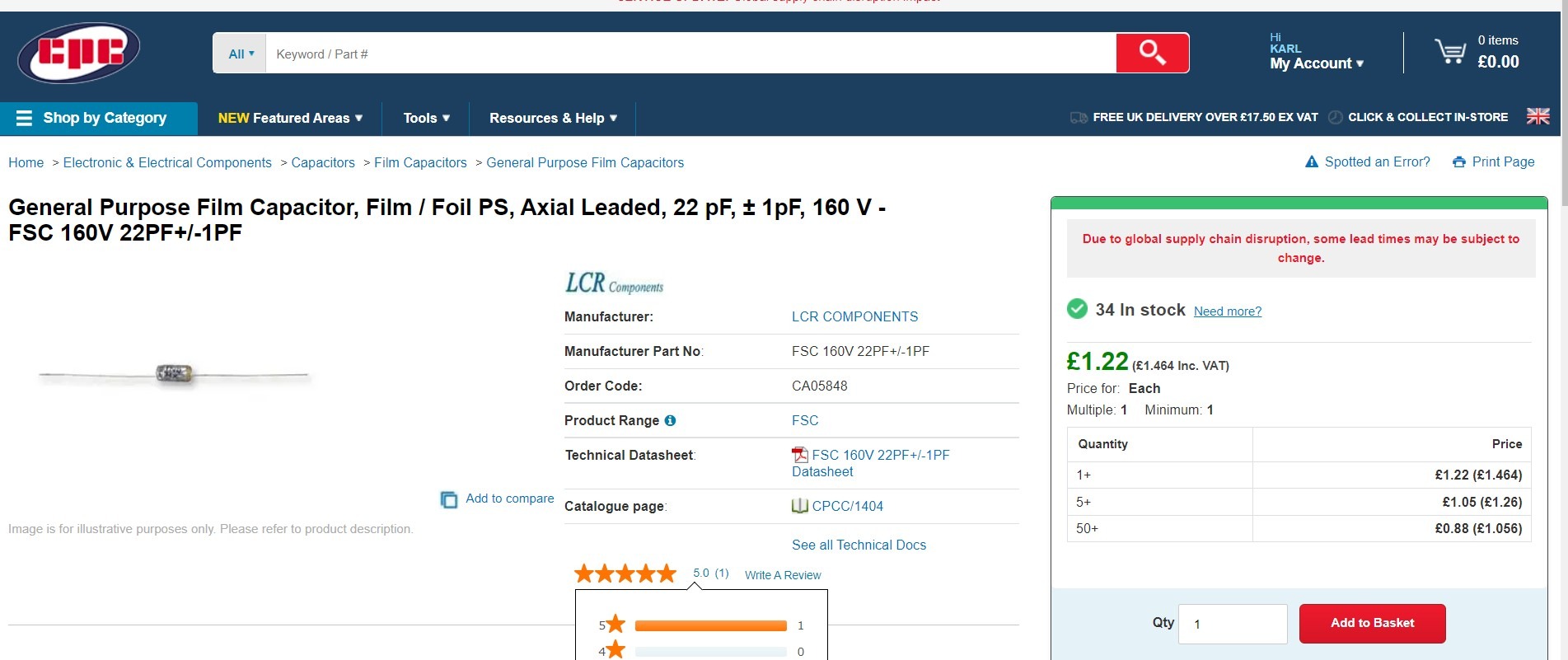

Couldn't find like for like on the web and HiFiCollective had several suppliers for polystyrene capacitors. Asked their advice and they suggested Charcroft Silver Mica.
If you are in the UK then have a look at CPC:
https://cpc.farnell.com/lcr-components/fsc-160v-22pf-1pf/capacitor-160v-22pf/dp/CA05848
The coloured end on these type is another way to determine the outer wrap of the foil.

I suppose I grew up with 'ceramics are bad' from an audiophile view and that the small poly types (like I linked to) are superior in that regard. My practical experience as a tech has shown ceramics are often the cause of many faults, they can and do fail.

Update. So while I dithered about sending the Silver Micas back because they were overkill on the £££ side and the board needed driling for the thicker lead wires I found the cheapest 22pf radial capacitor in the world in my old student box and popped that in as a test. Worked fine. Returning the SMs and buying something else was 3 lots of postage down the tube so I gave up, drilled the board and used them. So now after many years of routing the turntable through a different amp just to use the phono input I can now use the 8000a MM stage as was intended. My very first discrete component level fault find and repair a success - wouldn't have managed it without the help on here though, especially Mooly, thanks all.
