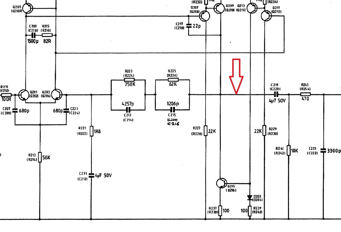

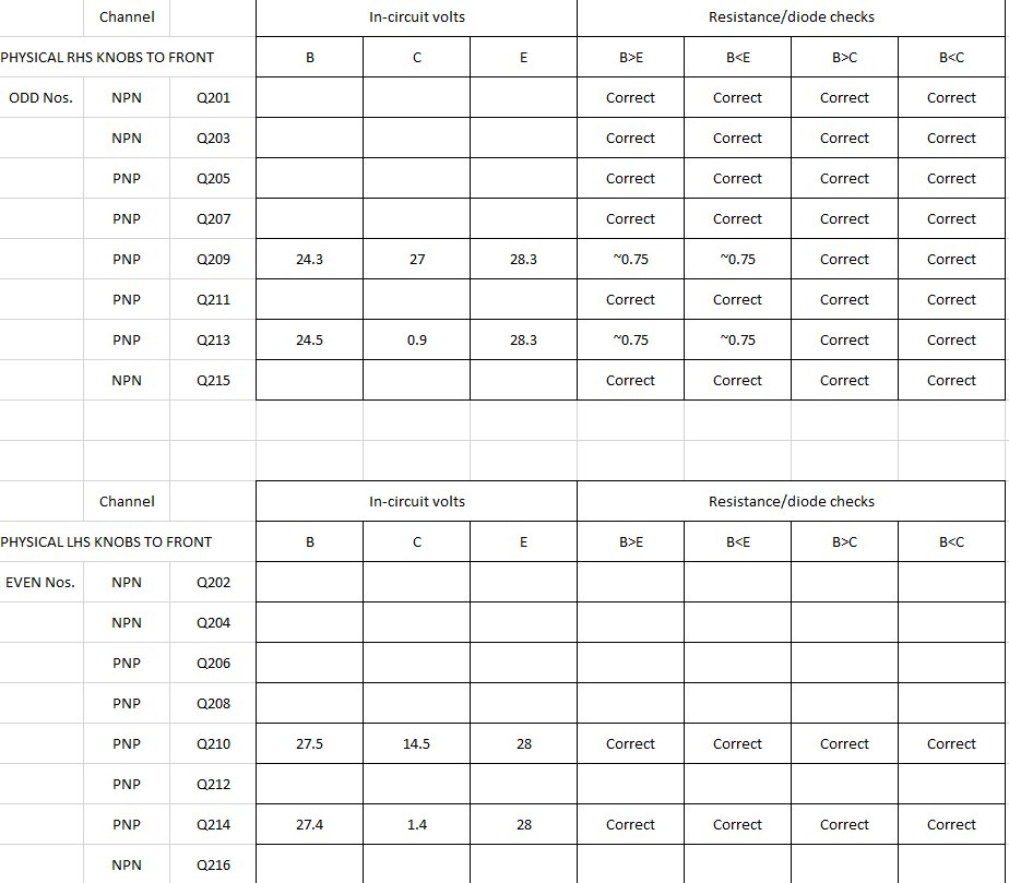

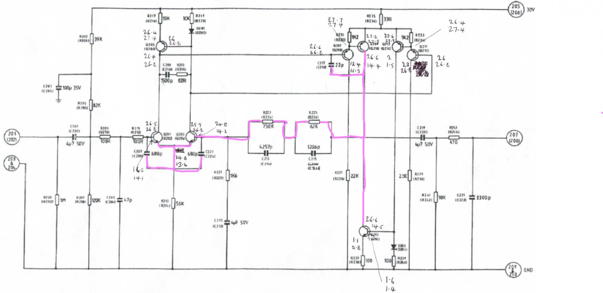

Audiolab 8000A phono stage not working

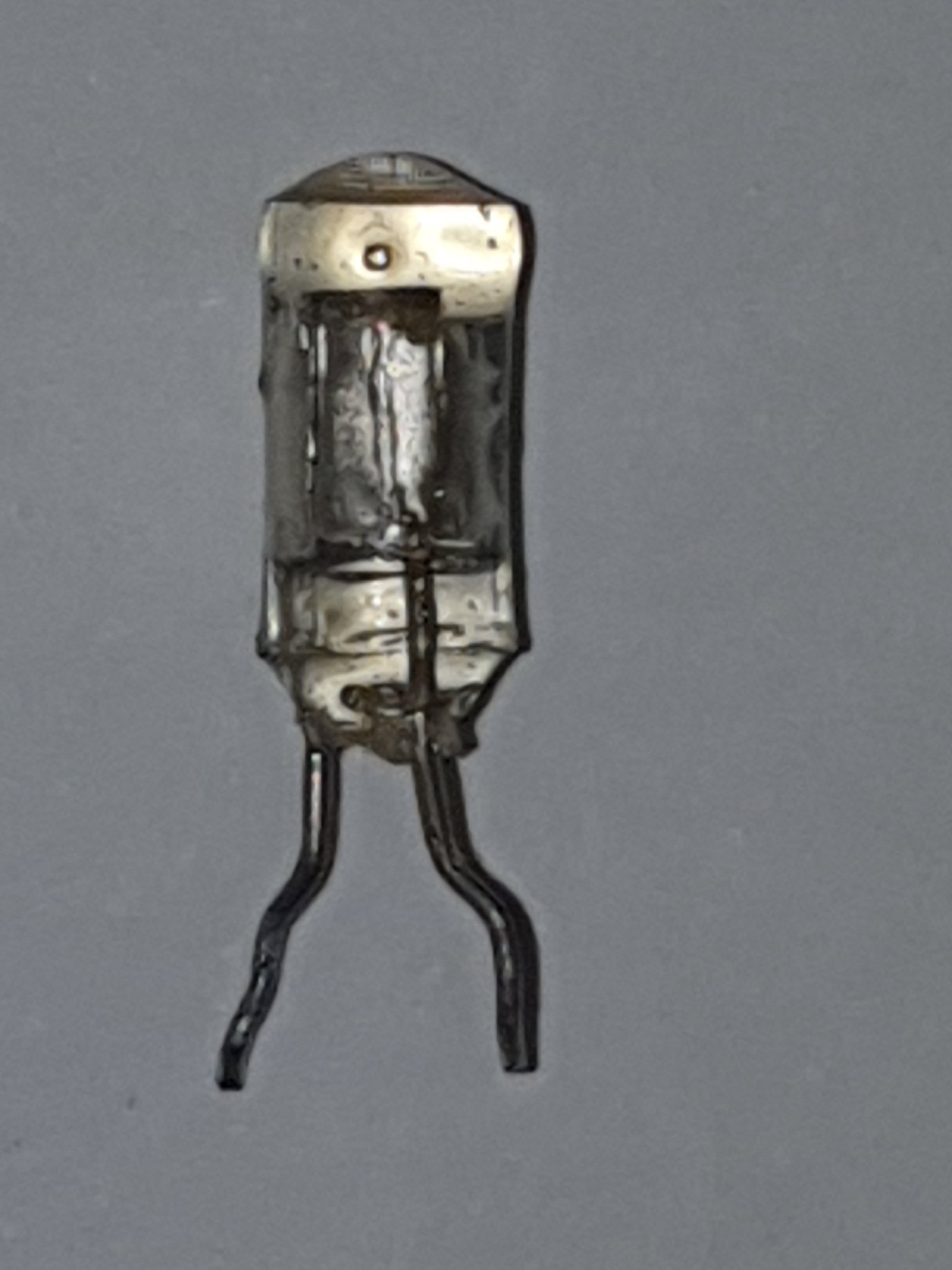

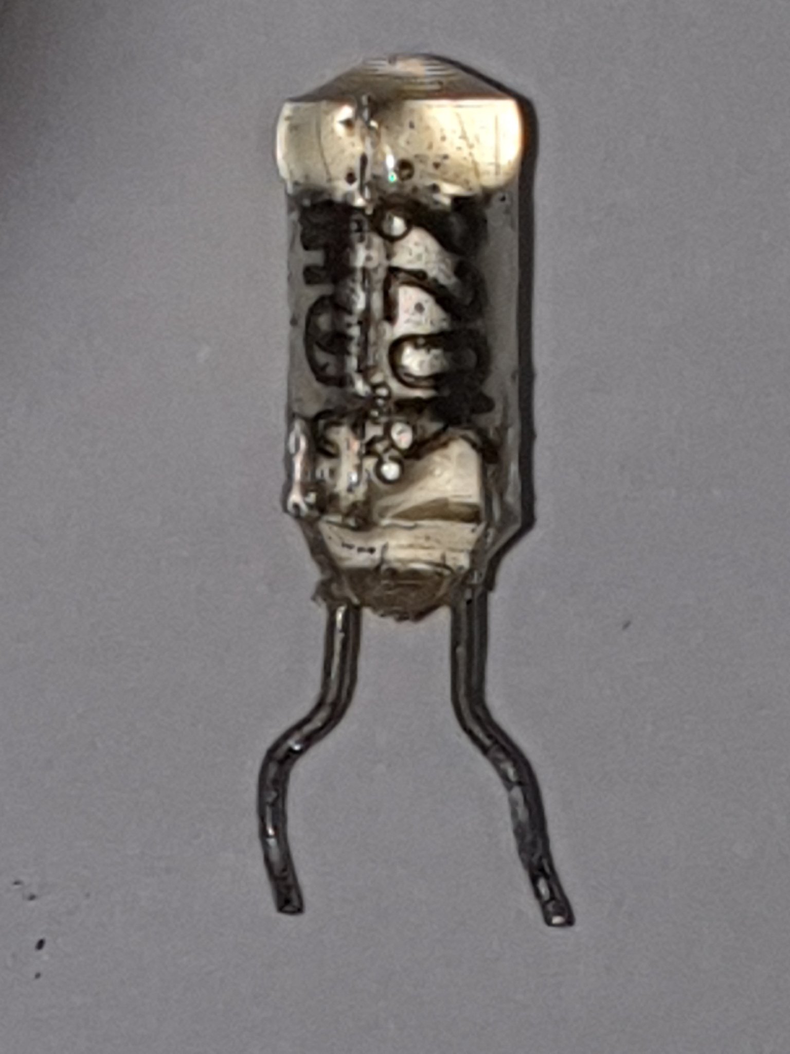

'If its hissy and noisy and altering all the time them perhaps a cap. Small compressed disc ceramics are favourites.'
could you use a poly film cap in place of these?

For example if the cap is from the base of a transistor to ground then connecting the outer foil connection to ground lets the caps foil act as a shield. In this circuit the low impedance point is the collector of Q209.

poly's are nearly always the better option. Ceramics are cheap and often used in budget gear.
Ceramic under 1,000pFd are often as perfect as it gets. NP0 (En Pee Zero) especially because it is blended for zero tempco (about zero everything).
Ceramics much over 1,000pFd need to be "salted" to get high capacitance and that "soup-up" is not perfect.
At 22pFd, I would use Silver Mica because it sounds cool. Ooops, five bucks?? Then NP0 ceramic.
I don't think 22pFd is made in film?? 10 inches of phone-pair is about 22pFd but would be an antenna also.
Reactions: Mooly
I suppose I grew up with 'ceramics are bad' from an audiophile view and that the small poly types (like I linked to) are superior in that regard. My practical experience as a tech has shown ceramics are often the cause of many faults, they can and do fail.

Update. So while I dithered about sending the Silver Micas back because they were overkill on the £££ side and the board needed driling for the thicker lead wires I found the cheapest 22pf radial capacitor in the world in my old student box and popped that in as a test. Worked fine. Returning the SMs and buying something else was 3 lots of postage down the tube so I gave up, drilled the board and used them. So now after many years of routing the turntable through a different amp just to use the phono input I can now use the 8000a MM stage as was intended. My very first discrete component level fault find and repair a success - wouldn't have managed it without the help on here though, especially Mooly, thanks all.
