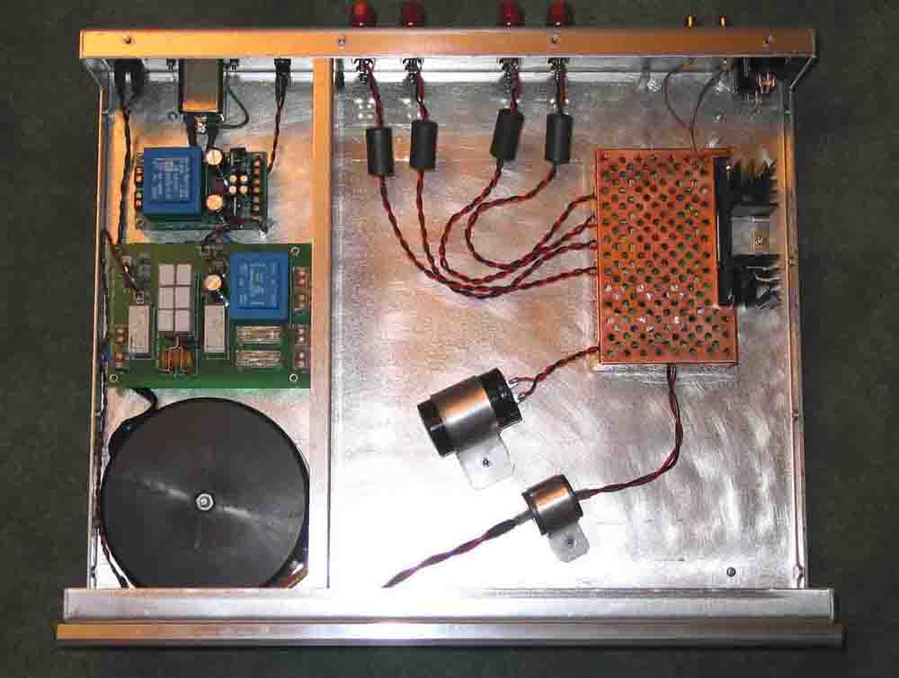

Thanks V-bro, I think my problem is that I’m a bit old fashioned when it comes to power supplies. I still find it hard to believe that a €48 SMPS can sound better than a 6A linier power supply that has virtually no ripple. But that’s the problem I just don’t have any experience with SMPS in HiFi.
Take your point on the caps, now you mention it the leads don’t need to be that long.
As for the screening this is an area that I believe should receive a lot more attention than it does. I have formed this view over the last few years and have seen the benefits of effective RFI and EMI screening. (The company I work for has an extensive Rad Haz test facility) Unfortunately it is an area that is not well understood (I am no expert, I rely on the guys at work) but if done properly, you shouldn’t be able to here it! The effects are subtle but a well designed and screened system has more ‘space’ and lower noise.
I removed the rectifier from the board and placed the amp in a really tight-fitting aluminum cast case, the power supply has it's own case...so I think I 'accidentally' shielded the circuits quite well...😀
One thing I must add is that no matter the SMPS or way I shielded it the amp seems to be deadsilent at idle... Never heard any noticeable noise whatsoever from my speakers....other than the right noise

At least it didn't go bang!
Over the weekend I wired up the new SMPS. While I was there I made the leads to the external cap even shorter (1/2”) and removed the rectifier. It’s easy to see where the DC +/- go so I soldered the wires directly to the board. And then in great anticipation I flipped the switch and… nothing!
Generally when things don’t work it’s because I have done something stupid, but no, none of the wires were shorting, and everything was in its place. I suspect the power supply because when you turn on you can here the normal ‘start up’ noise from the speakers and a green LED in the PS comes on, but then goes off? I think that maybe the power supply is going in to protection mode and shutting down.
I’ll check it out later, when I’m in a better mood!
Oh the joys of DIY.🙁

Thank V-bro, the good news is that the amp is OK. I connected up a cheap 12v transformer PS and everything worked OK. (In fact it sounded embarrassingly good!) So we think the problem may lie with the large (10.00uf) external cap. I know some SMPS don’t like big capacitive loads, so that’s the task for tonight! If that isn’t it then, dear Watson, by process of elimination, it must be the PS. (either that or I haven’t used enough Hi Fi quality snake oil)🙂

Everything is now working. The problem was eventually traced to the PS which has a +/_10% adjustment on the output voltage (24v) I thought that I’d left it in its nom position but it was just a bit too high. At 25.8v its fine and it shuts down at 26v! And the difference between it working and going to bed early is 0.00001of a bloody degree on the adjustment pot. Still, got there in the end. It sounded a bit ‘thin’ to start with so I re connected the external cap [10,000uf] which gave a worthwhile improvement to the bass. (It’s probably on the limit of what the PS will tolerate) The treble still sounds a little obvious, (more so than with the linier PS) but I’ll give it a few days to run in. I think a change to the input caps may be on the cards?
