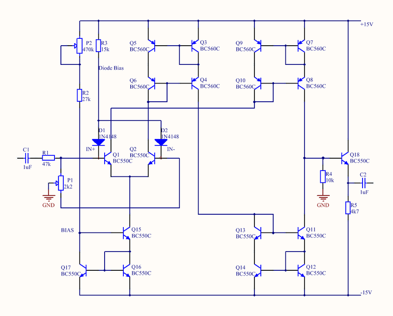

This is a circuit that I think works.
But I have to try it when I get home some more transistors.
It takes 18 of BC560C and BC550C.
It is a VCA. Voltage Controlled Amplifier.
At the input is a divider that divides with roughly 44.
The small resulting voltage is put to input pair.
The current difference is transported to the output, and put across a 10k resistor.
At the output is a buffer transistor.
Max bias input is like 1mA and so is 0.5mA at each transistor.
P2 potentiometer is to regulate the volume with the bias current.
P1 is for adjust eventual output offset.
I might need to adjust some values when I test it at my experimentboard.

A question for Nelson :
Suppose one builds a balanced version, but the two halves are not 100.0000000% well matched.
i.e. the output of one phase is not exactly -1.000000000x of the other.
Since both current outputs are connected to a single load, where the hell of the difference in the two currents should go to ?
The are absorbed by the net value of impedances at the output:
1) intrinsic output Z of the open loop circuit (always less than infinite)
2) output z due to negative feedback
3) load impedance
An enhanced Wilson (4 transistor goes some way to reduce the Early Effect) but this situation can be reduced further by adding helper transistors (base current compensation). This is particularity helpful if you are using a Widlar Mirror.
Adding resistors to the emitters of the upper mirrors usually helps the accuracy of the mirror.
Cascoding can also help by reducing heating of the mirror transistors.
If you are using transistors of the same lot numbers I find that beta matching is usually less important, besides you could add a trim pot to balance the mirror in a complementary circuit to zero the dc offset, but I digress.......

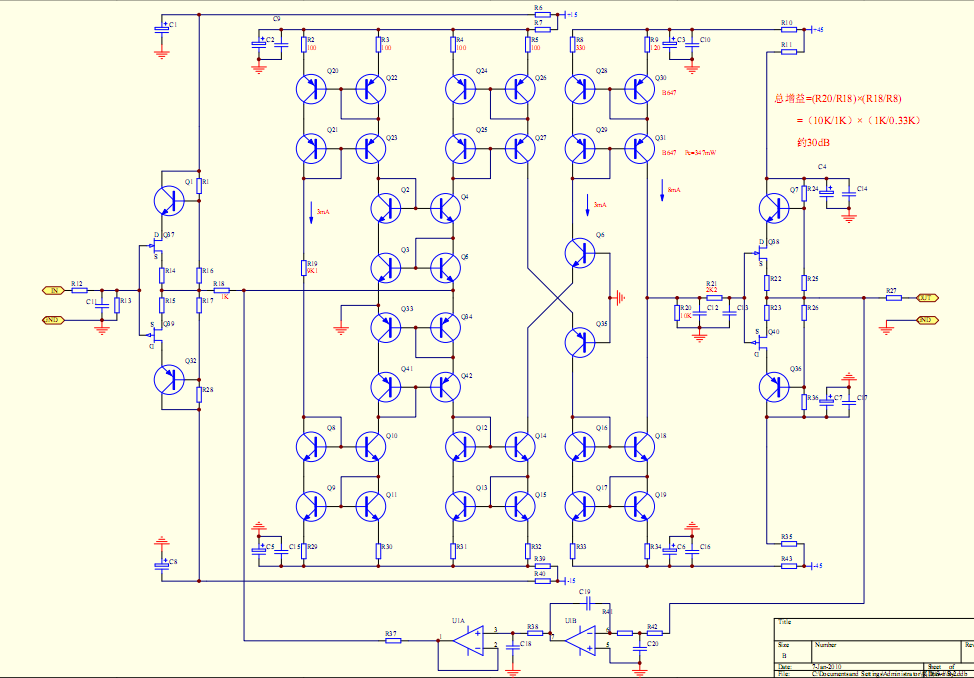

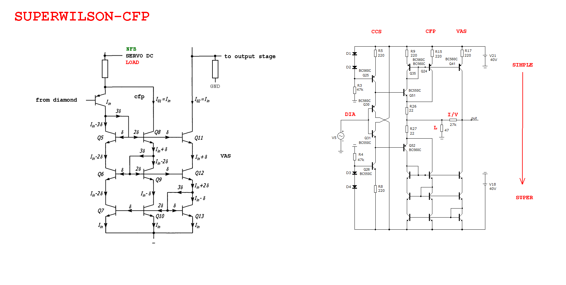

The Pioneer Super Linear Circuit
See PDF in Post#1, also post #127, 132.
For me a must. I have not been able to do without.
But then I also do not have any NFB.

Nice headphone amplifier design.
Patrick,
Great circuit that Pioneer promoted (Their new new stuff is not nearly as good).
So how about taking the front end up a notch .....................😉 Ignore the feedback.
Jam
