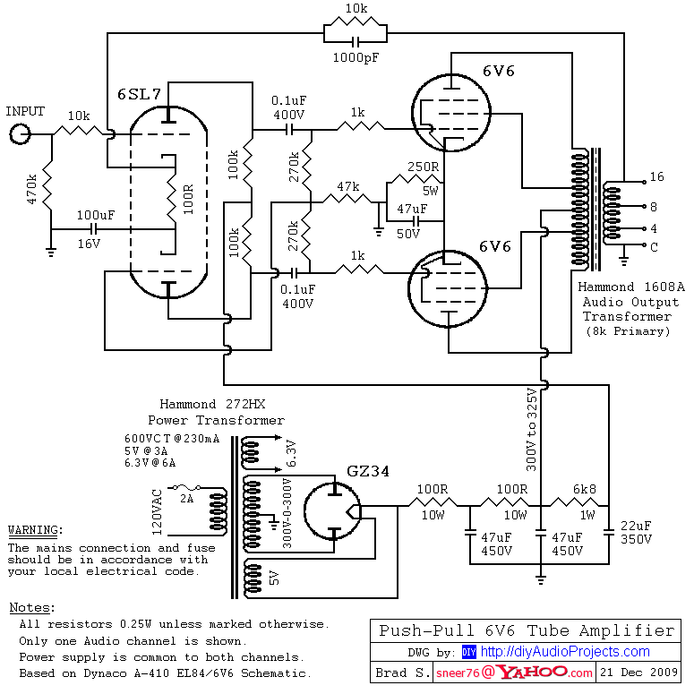

OK, hang on...now the concept is getting a little clearer... Based upon the schematic below, I see how the output tube is getting its bias voltage from the halves of the transformer. However, this XFMR has another set of primary legs to ingest the output tubes HV audio signal. Its different from the other schematics I am looking at, but I get the concept now of "powering the output stage." Thanks 50AE for that.
However, I guess I am still struggling with how the DC-to-CT leg induces a suitable DC voltage for each Output plate. What are the mechanics that make this possible?
The tube (+ transformer) as an amplification active stage needs to be fed with energy in the form of DC voltage.
It modulates this voltage into an AC voltage. The frequencies and amplitude of this "modulated DC power supply" are dictated by the input of this stage.
You just need to check the basics of how amplifiers work.
The transformer is mainly there to transform a higher voltage, impedance and lower current into the other way around at the secondary.
The circuit schematic is missing a cathode resistor to ground for the 6SL7 phase inverter stage. A 1.8 to 2.2 kohm resistor connected in // with the 100 mFd/16 v capacitor should be fitted. The 6V6 O/P stage derives its' bias from the shared 250 ohm cathode resistor to answer thw question from post #21.

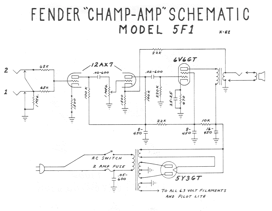

VaNarn, thank you for the proof-reading. I'll note that for sure. And 50AE, I assure you I am across the basics of amplification as it applies to tubes and transistors. By no means proficient, but learning. I'm still not focusing the question correctly. So what about this...
Lets say we had a normal CT power supply transformer. Ex. 120vac in, 240-0-240 out, and then we fed that signal into the output of an identical transformer. The resulting voltage (now measured at the input because the connections are reversed with regards to the first XFMR) should be 120vac, correct? So as far as transformers go, it doesn't get much simpler. We have doubled the voltage, halved the current, and gone back again.
Now, with regards to an amplifier's output section, I completely understand the need for Plate voltage. I guess I never looked close enough to note where (for output tubes) it was derived. Now I know....From the output XFMR.
So with that in mind, please walk me through what is happening in the schematic below with regards to DC entering one leg of the XFMR, and the output tube's waveform entering on the second. In my mind, I would expect the Output XFMR input to be the tube's output on one leg, and chassis ground to the other. Like the example above (well, sort of). For such a primitive amp, I am struggling to understand this output/power supply. I have no interest in progressing until I have this sorted in my head.
