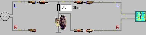

I am absolutley hopeless at building a jig .I am wondering is there anyone in Australia that would build me one if I paid for it
For those who have difficulty building the jig for SW (or other measurement software), Claudio Negro has a cable set up that should not be difficult to use or to "build". It requires no more expertise than "building" a crossover. You can see it at his home page, www.claudionegro.com, or in the Speaker Workshop Manual.

While we are on the subject of measurement software...can anyone recomend a good firewire or USB soundcard for use with a laptop. This will be primarily for measurement purposes. I'm perfectly satisfied with my current setup for doing impedance measurements on my desktop PC, but I would like to do some quasi anechoic frequency response measurements outside using my laptop. The internal soundcard just isn't linear enough for me.
