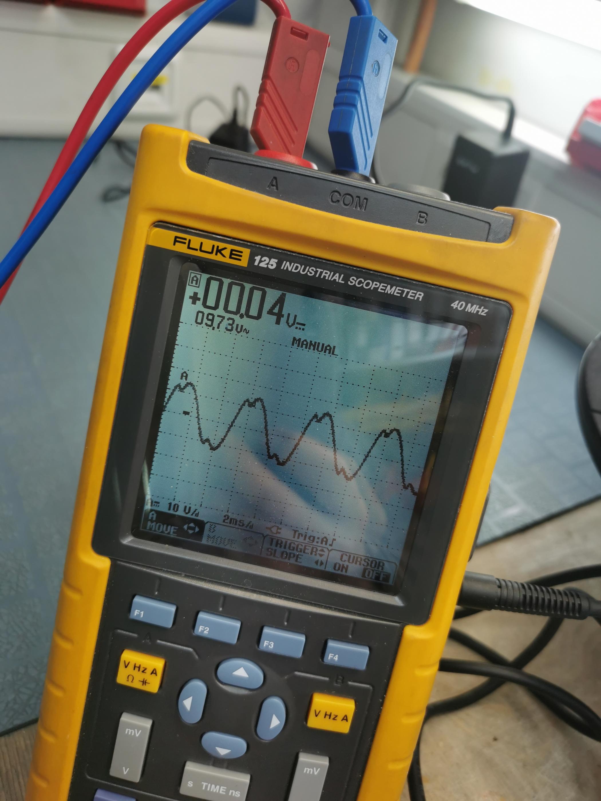

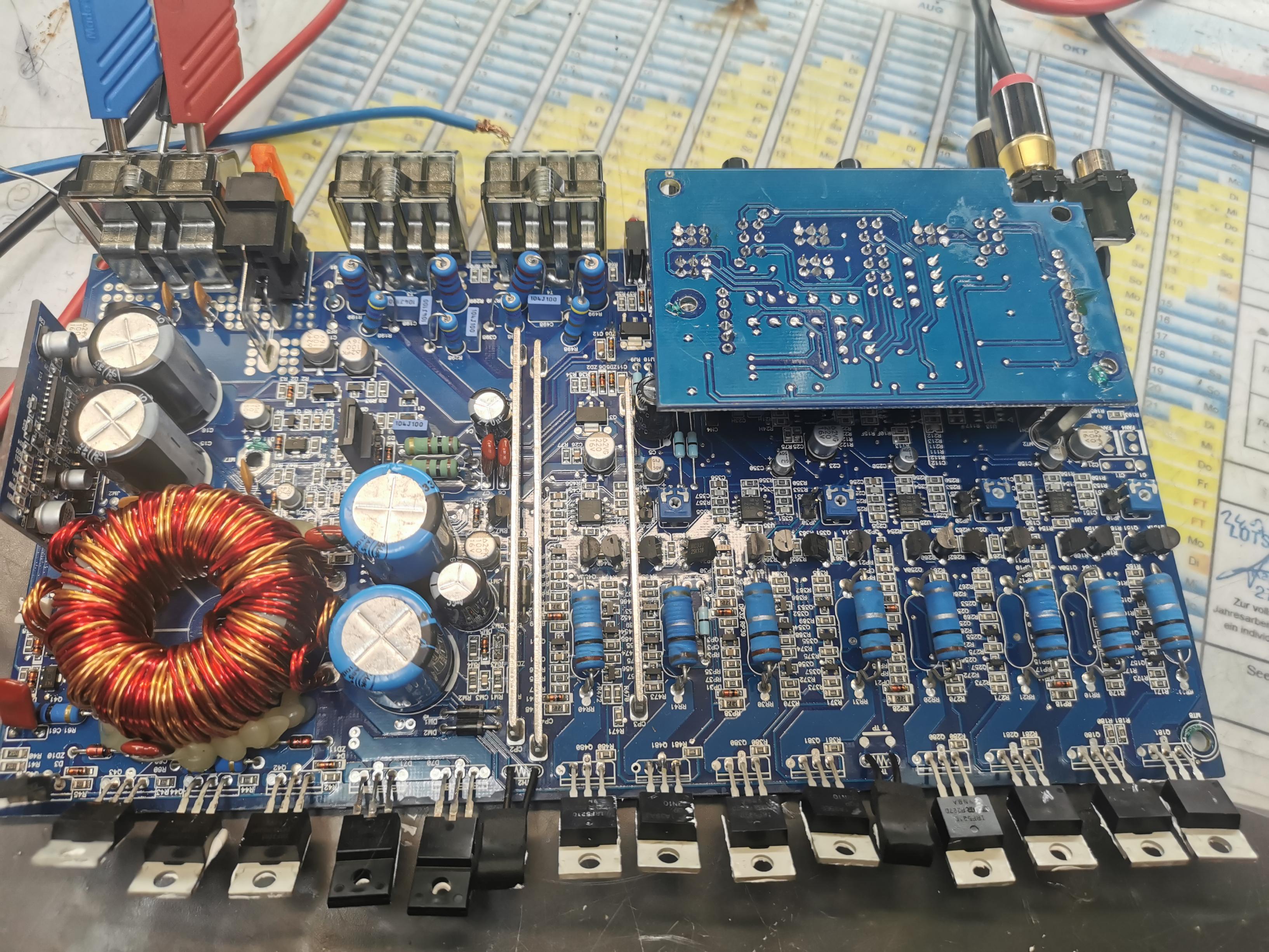

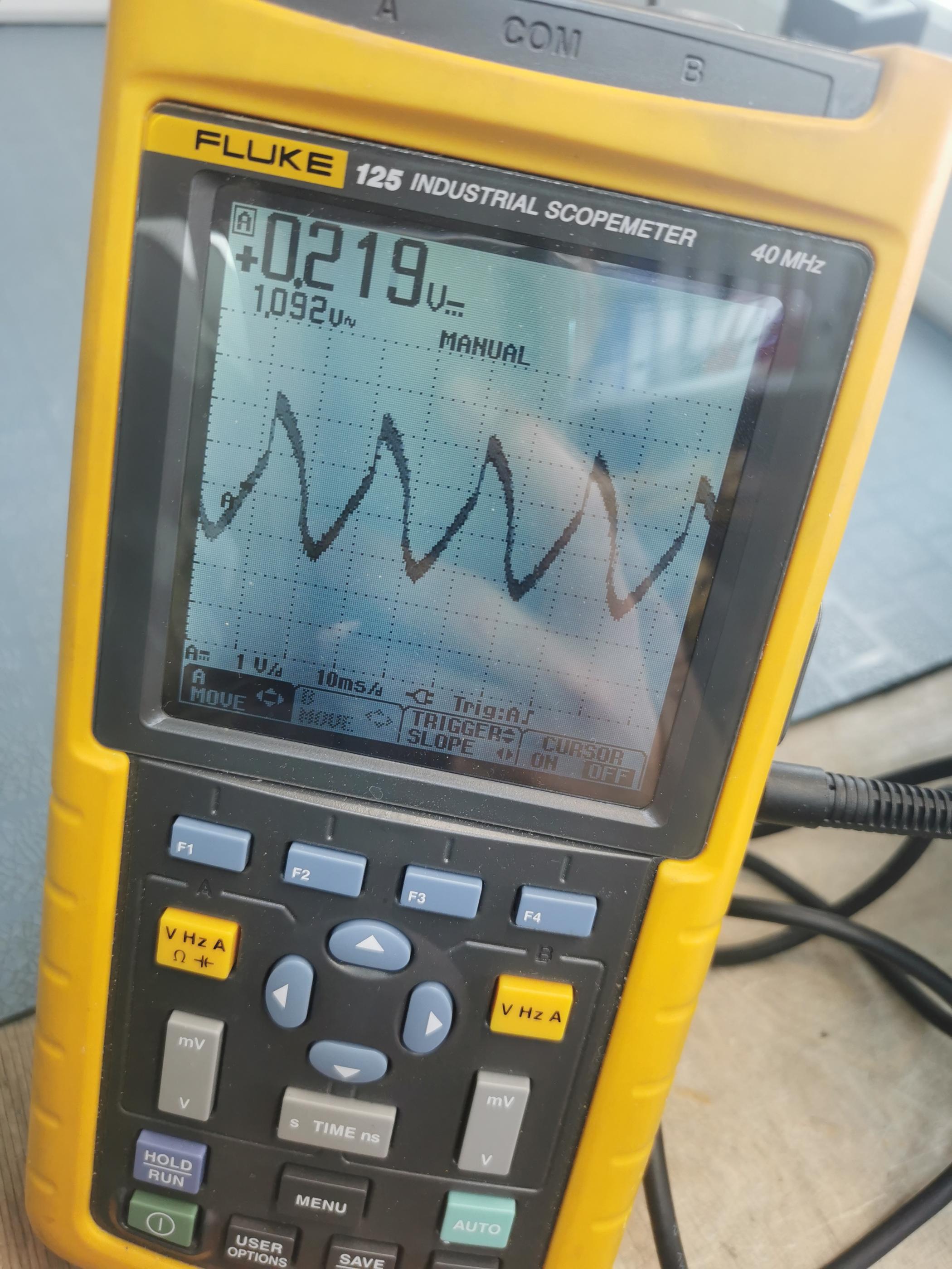

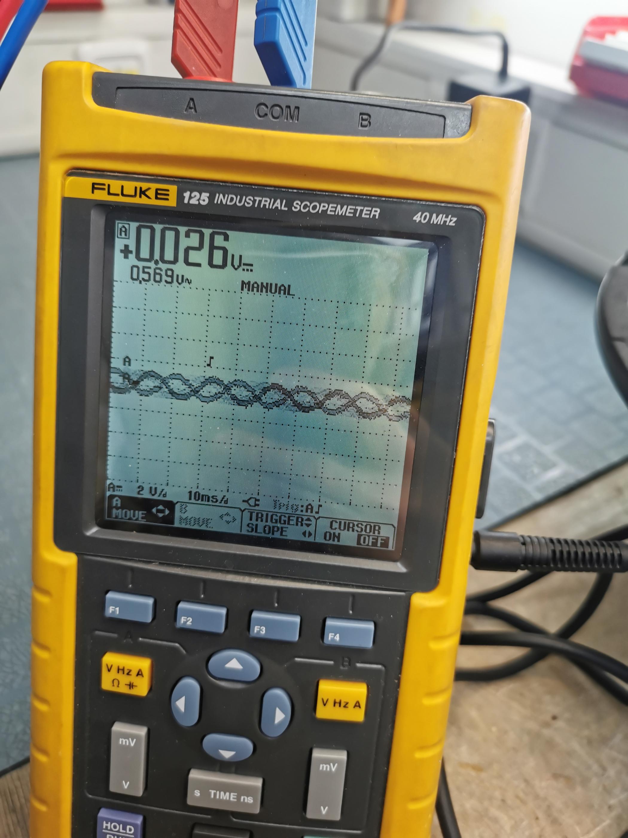

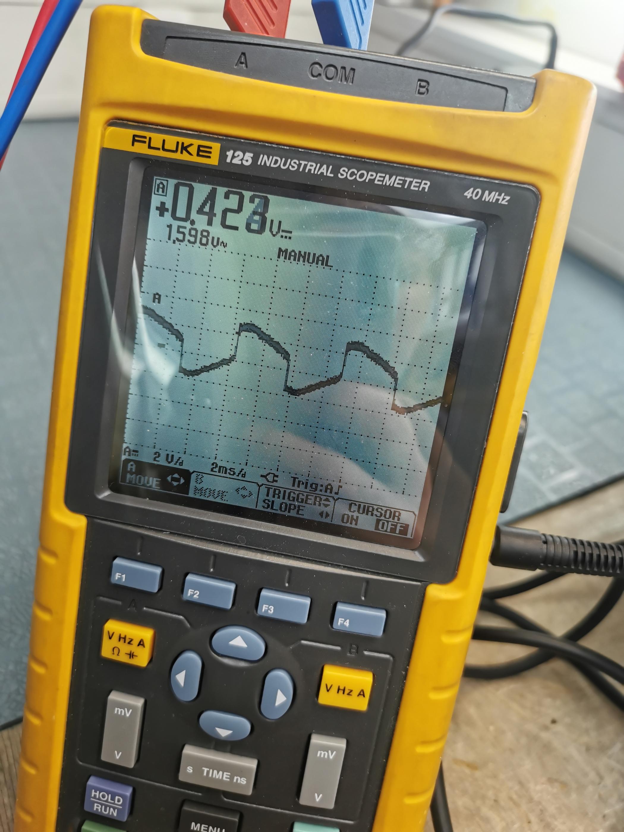

I got this Class A/B Amp, with mosfets.
2 Channels are ok, 2 are disorted.
Outputs and everything else is ok.
The output on the two channels is reduced, and upper and lower sine are disorted.
I expect the mute circuit, but i dont fully understand, how it works.
Attached a diagram from a two channel amp, but its exactly the same:
Page 2: U25A , on the working channel i have a good input sine. Ground from osciloscope is at rca ground.
on the disorted channels, there is no visible input at U25A...
I expect, that the mute circuit is supressing the signal, but i cannot find, where it is suppressed.
First picture is the board.

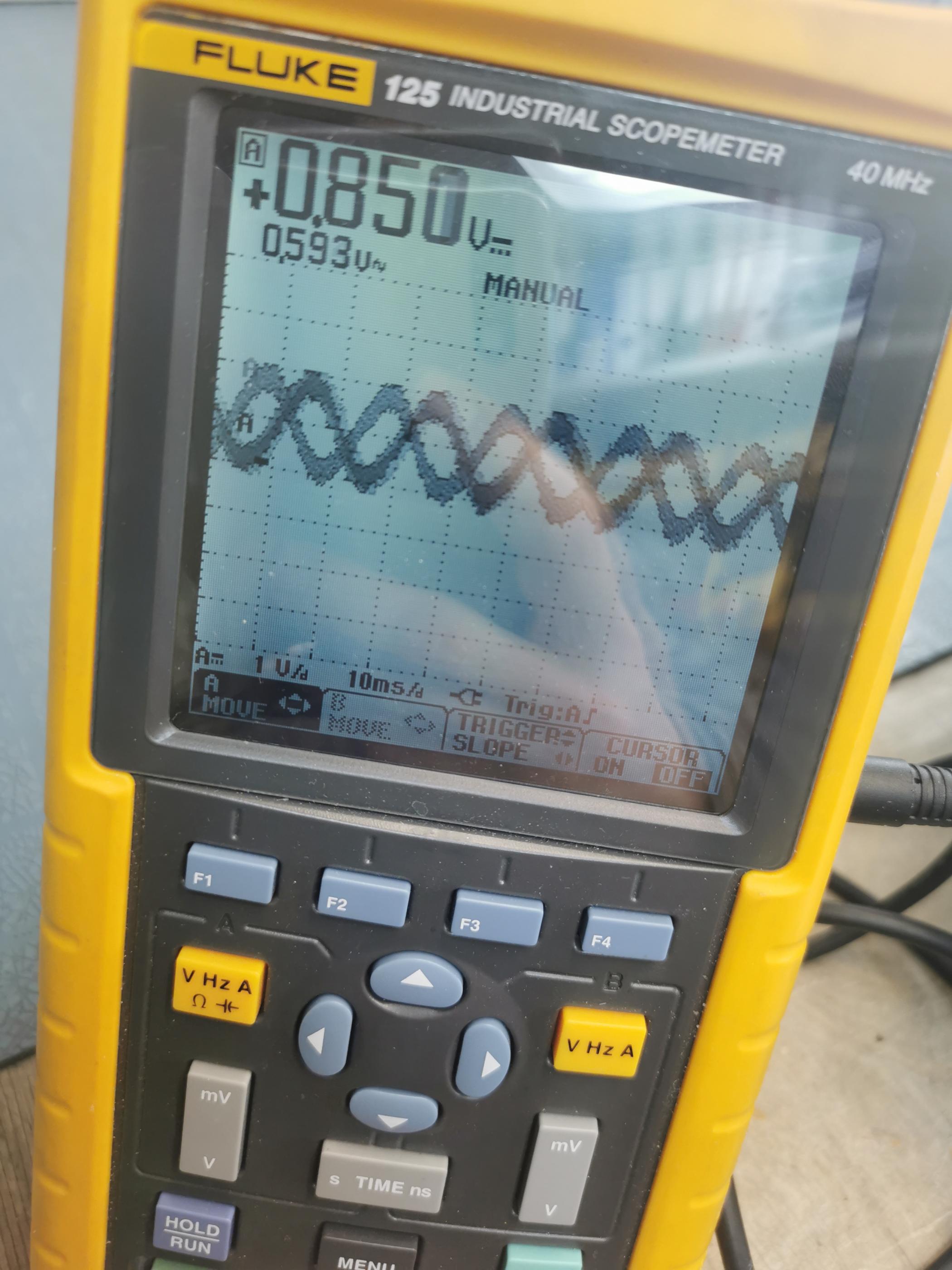

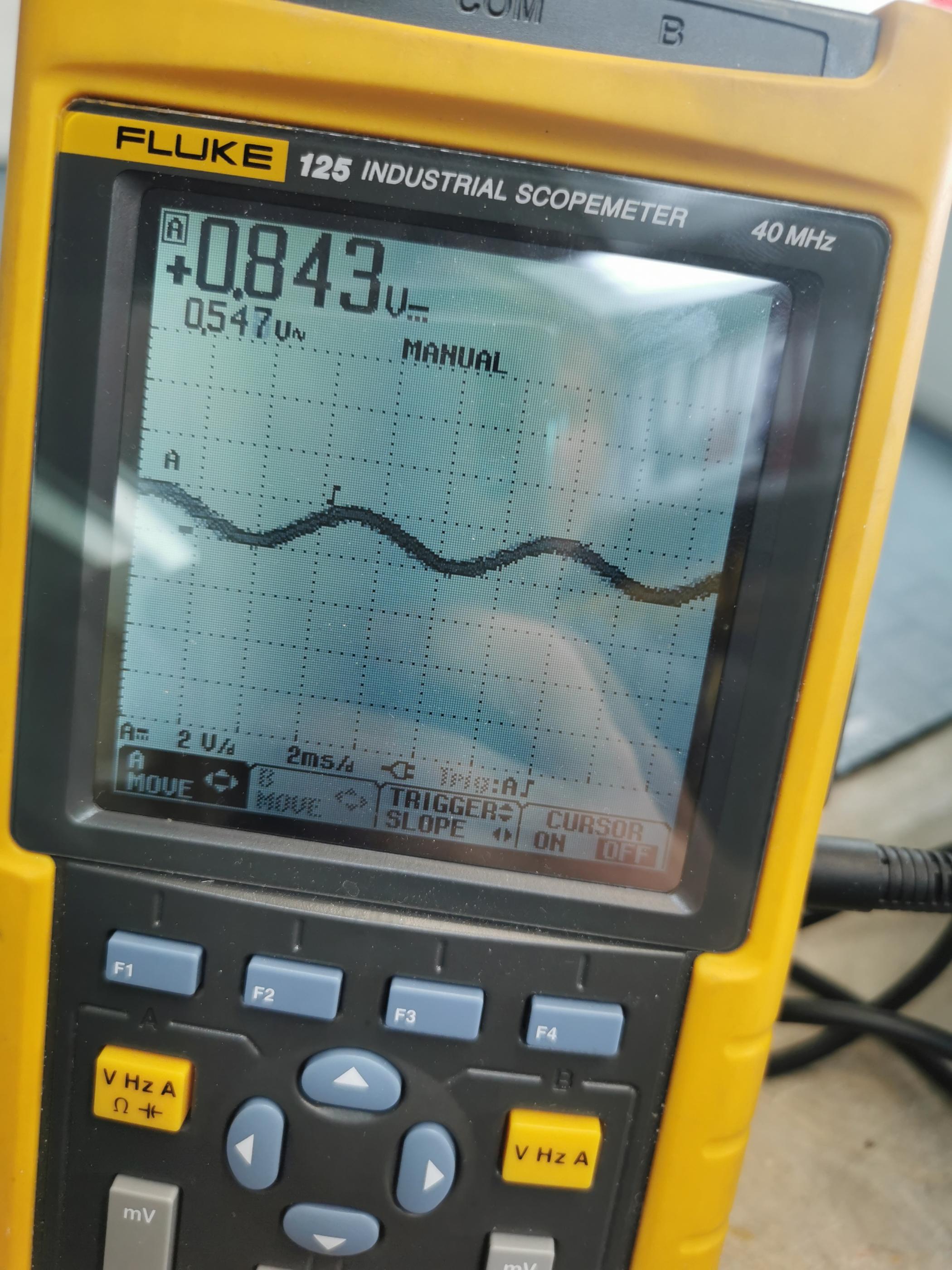

Second the distorted output with gain at full, third is the good output at full gain.

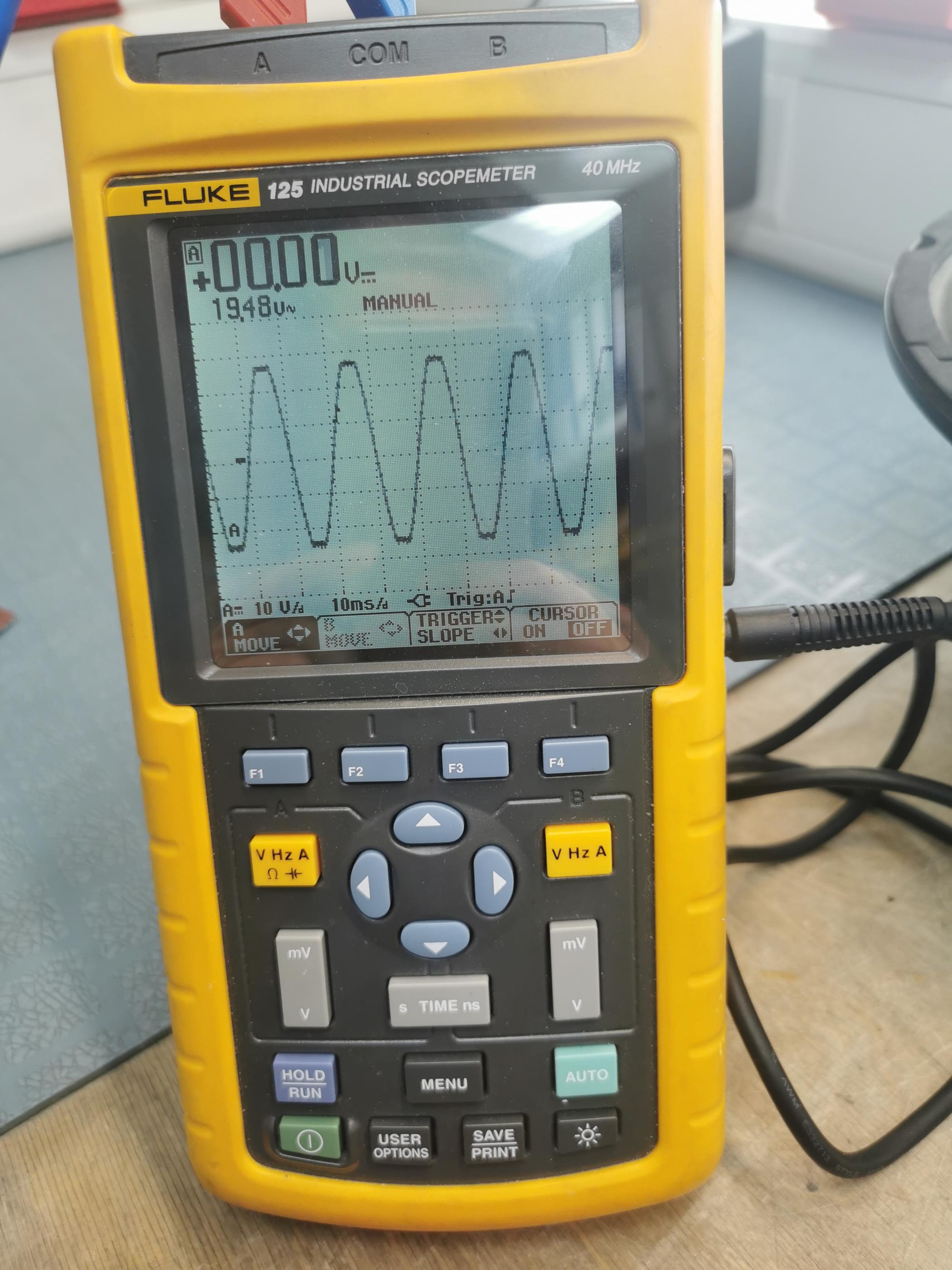

Fourth is pin 7 of the ne5532
Fith picture the same at the good output.

Yes, you are right. On 3 op amps, I have a good signal, also at voltage input. Only the last op amp, from one of the distorted channels has at pin 7 distorted..
If you see the attached pictures, on pin 1,4,7 and 8 I have the sine wave. On the last op at pin 7 it's distorted.
I will test again with ground to rca ground.

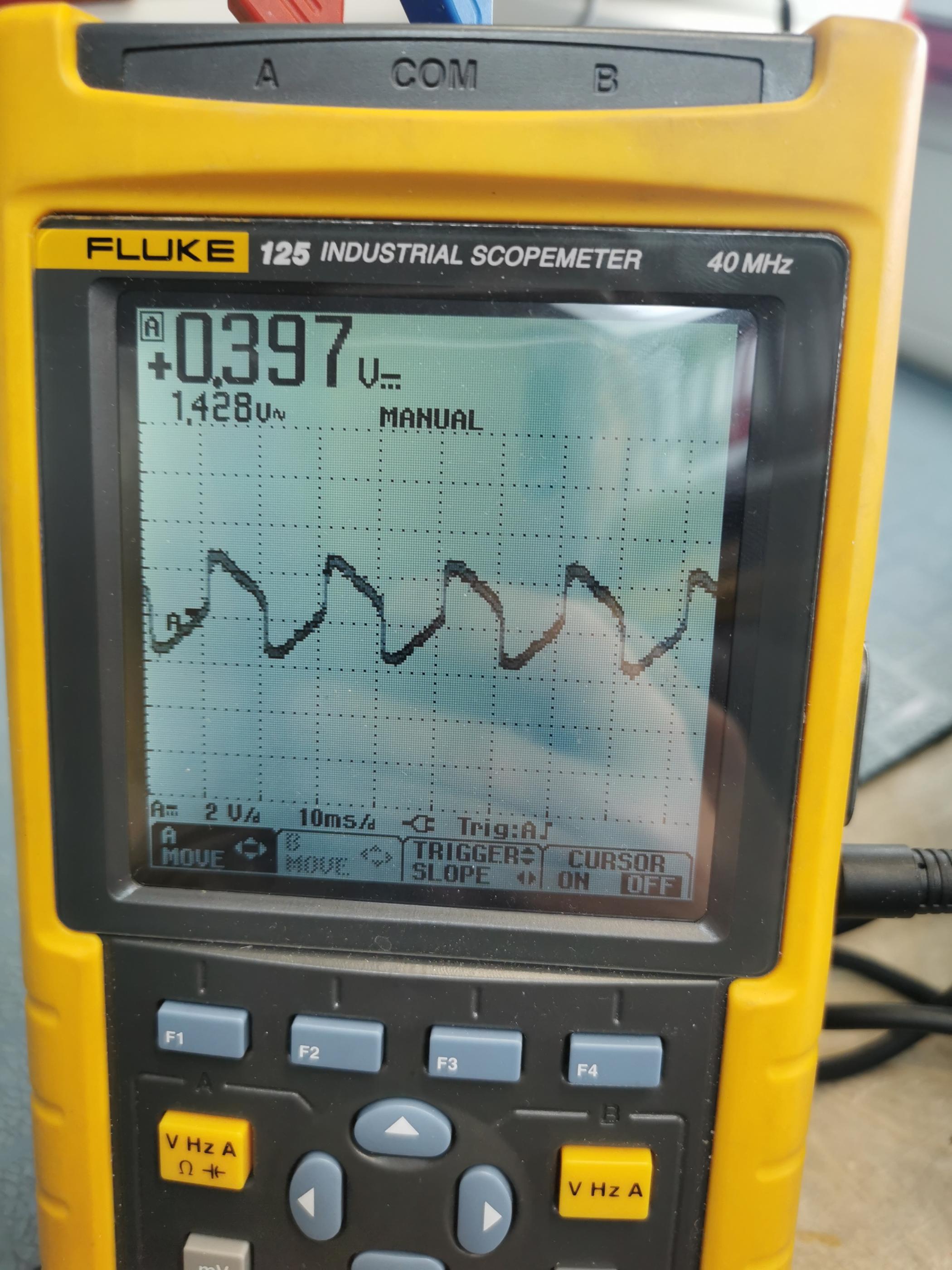

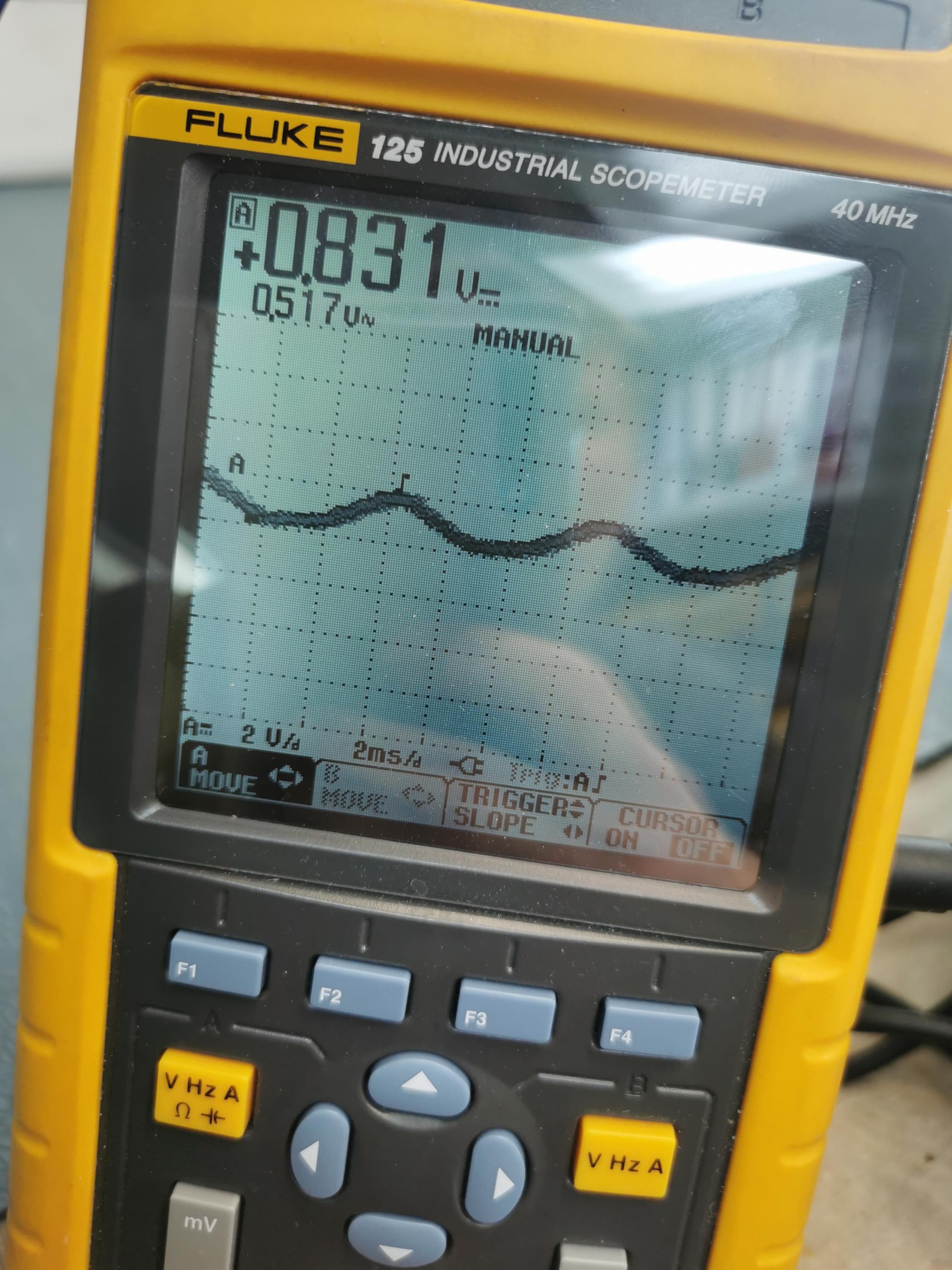

I think, some measurings are wrong. Iam working on a Ship, and the Electromagnetic Radiation here is very strong, so that it affect my measurings. We have 50Hz Power Plant here aboard.. So if i inject 50Hz Sine...it shows me the Powersupply from our Ship...
If i use sec. center as ground, i have no signale anywhere. Only some Voltage levels. Every second op amp shows me at Pin7 a nearly rectangle Amplitude.
So, it's the same.. I have sine at each pin..
The first picture ist the first distorted channel, the second picture ist the second disorted signal, the third is from a good Chanel. All are pin 7..should be feedback.

If I bridge pin 6 and 7,the amp goes in protect.
But, something strange. One disorted channel is clean now, but reduced. If I goe with lower frequency, it's distorted again. The other channel still disorted.
No, still disorted. I can bridge pin 6/7 at the distorted channel now, without going in protect but if it's bridged, the signal disappear
The removed fets are damaged between drain and source.. I don't know, why I couldn't measure this, whit fets inside.
