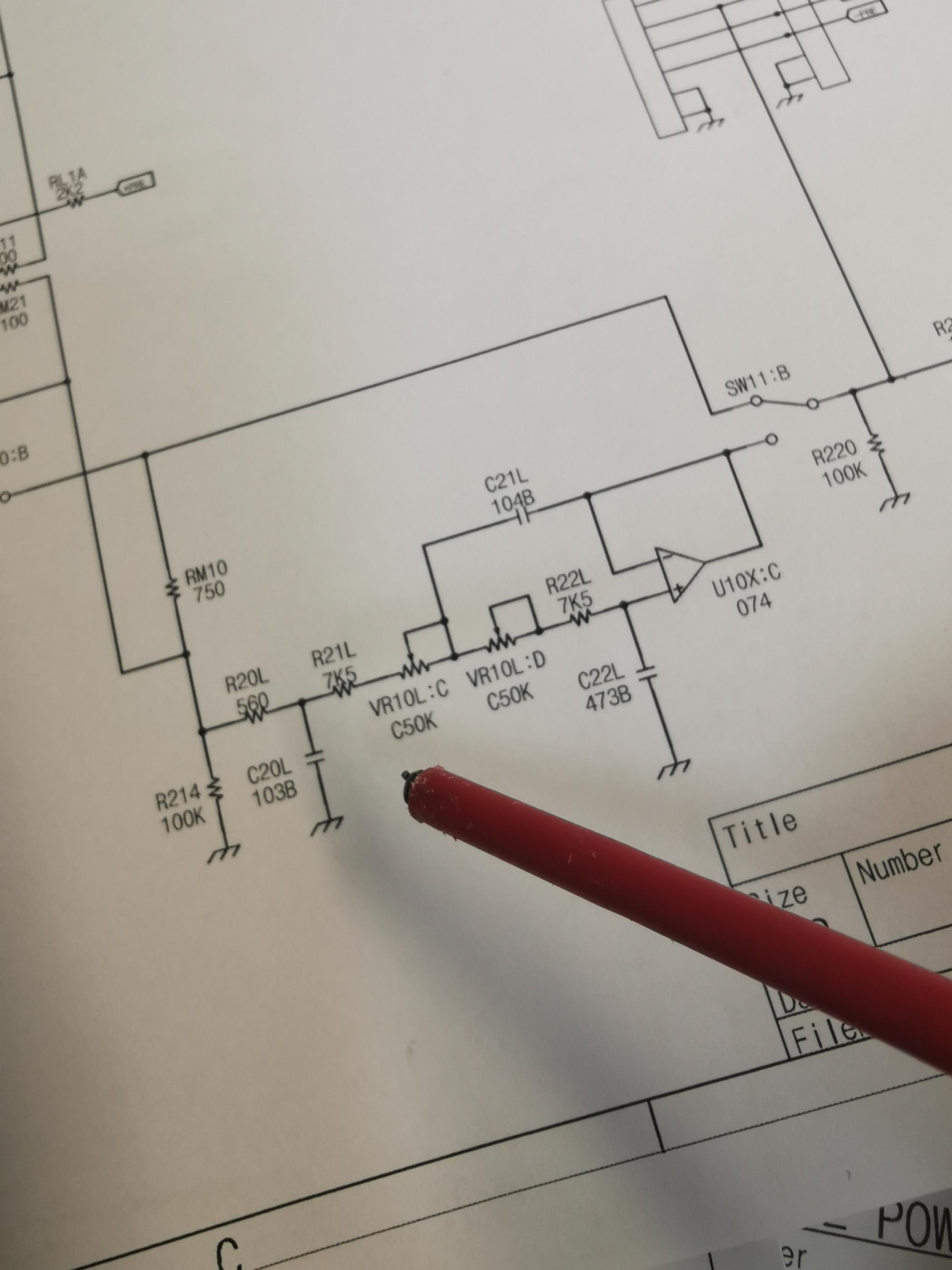

You mean this potentiometer?

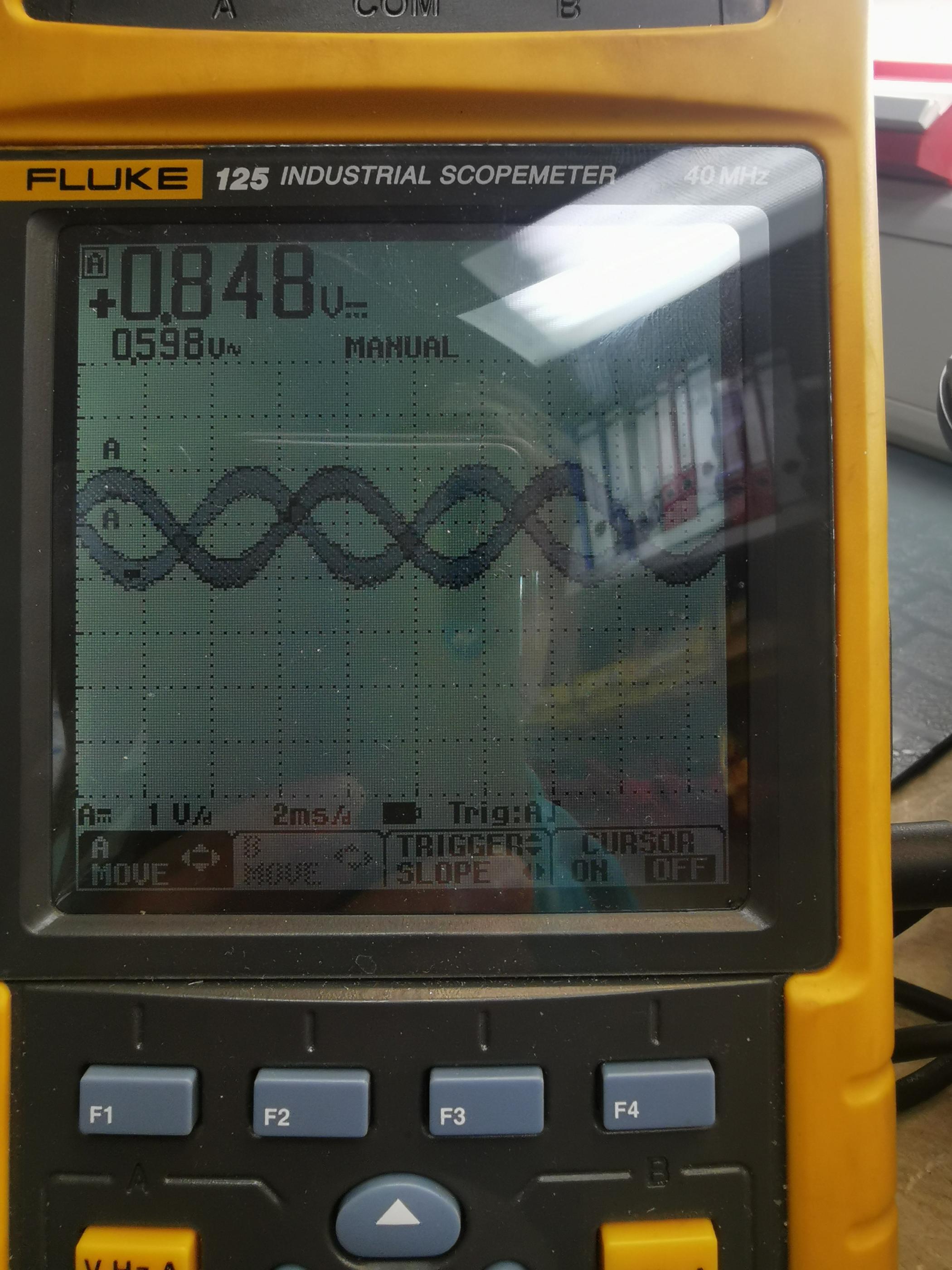

Input at the cap is at each channel the same, see first picture.

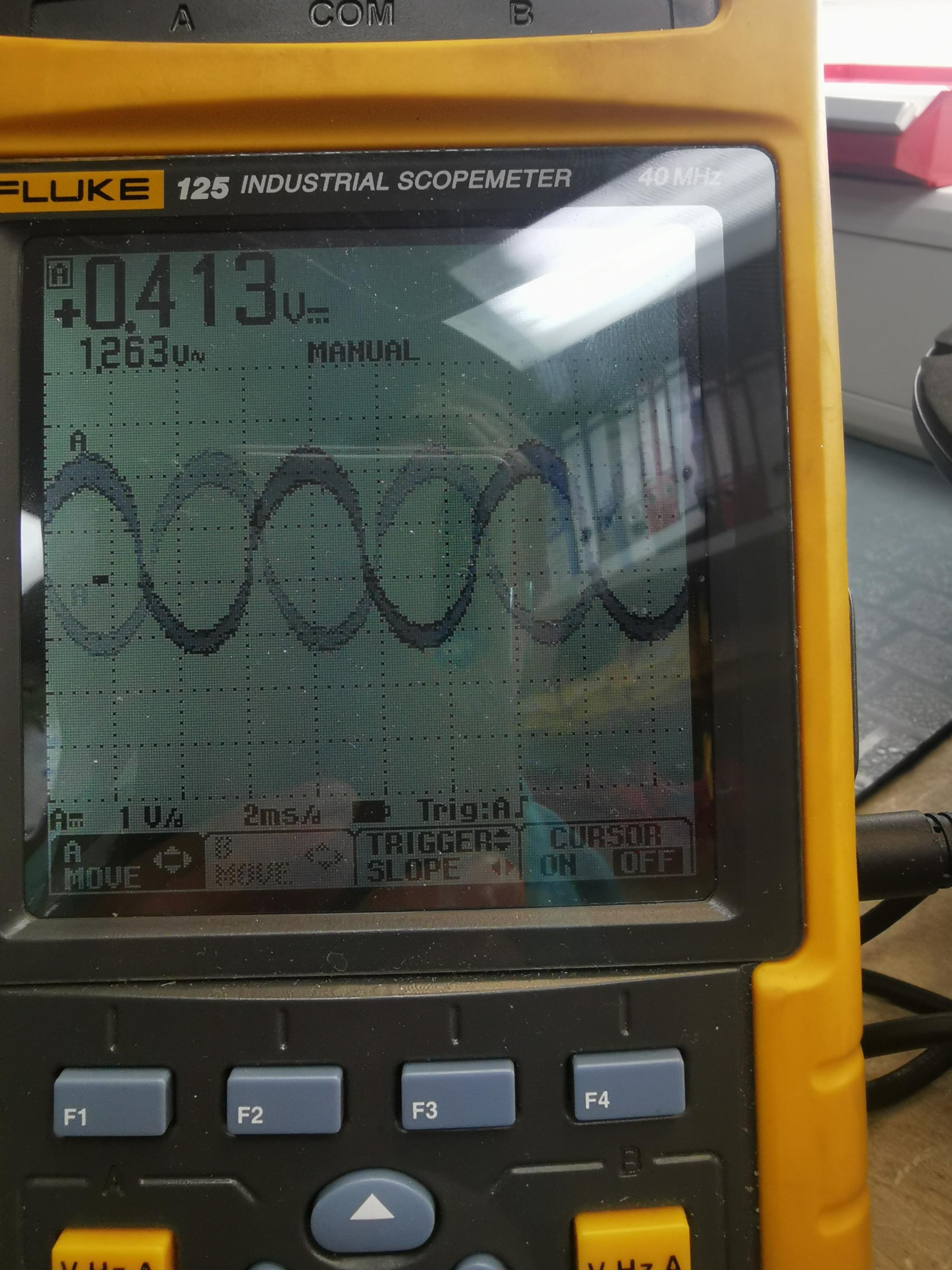

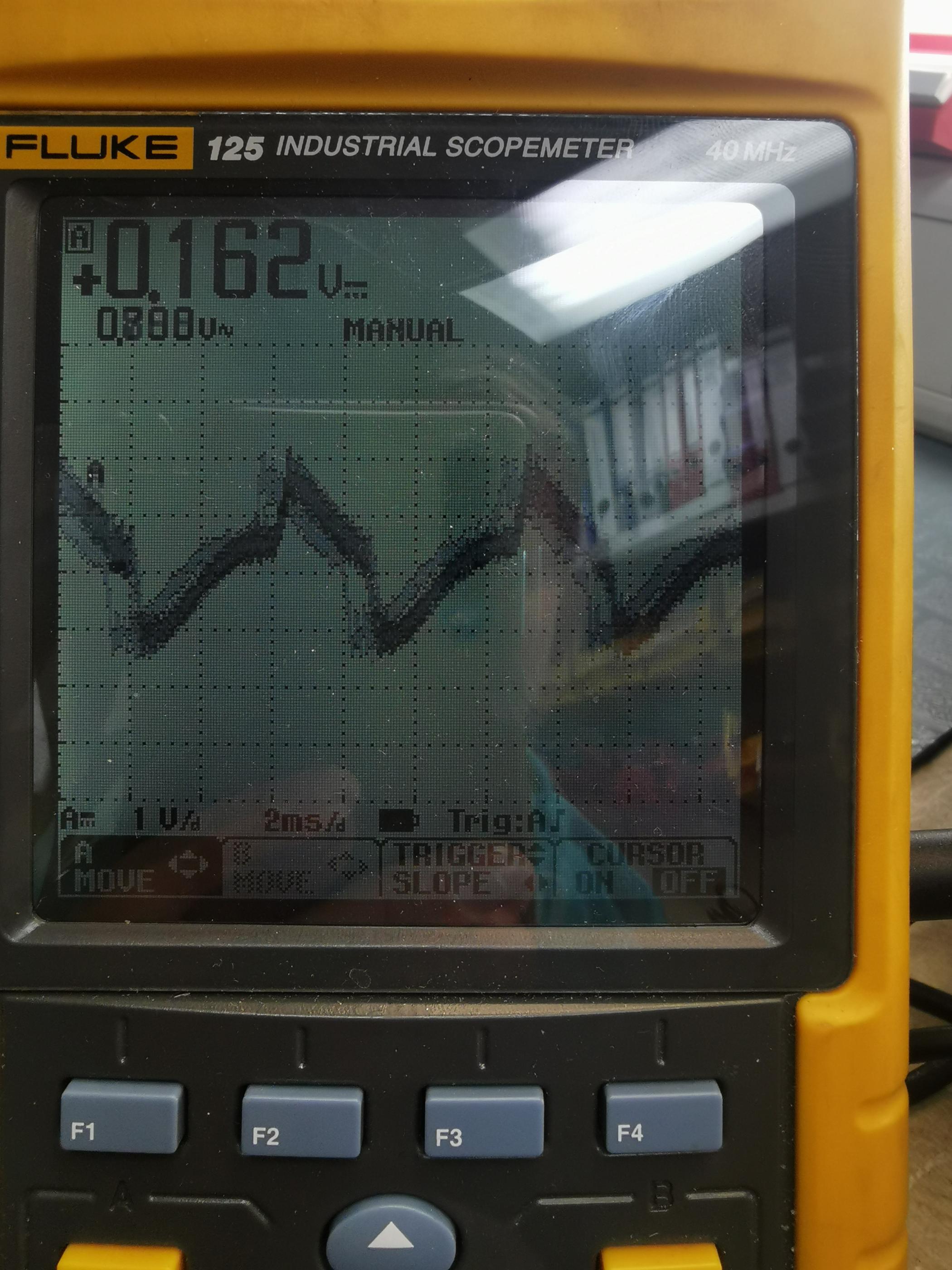

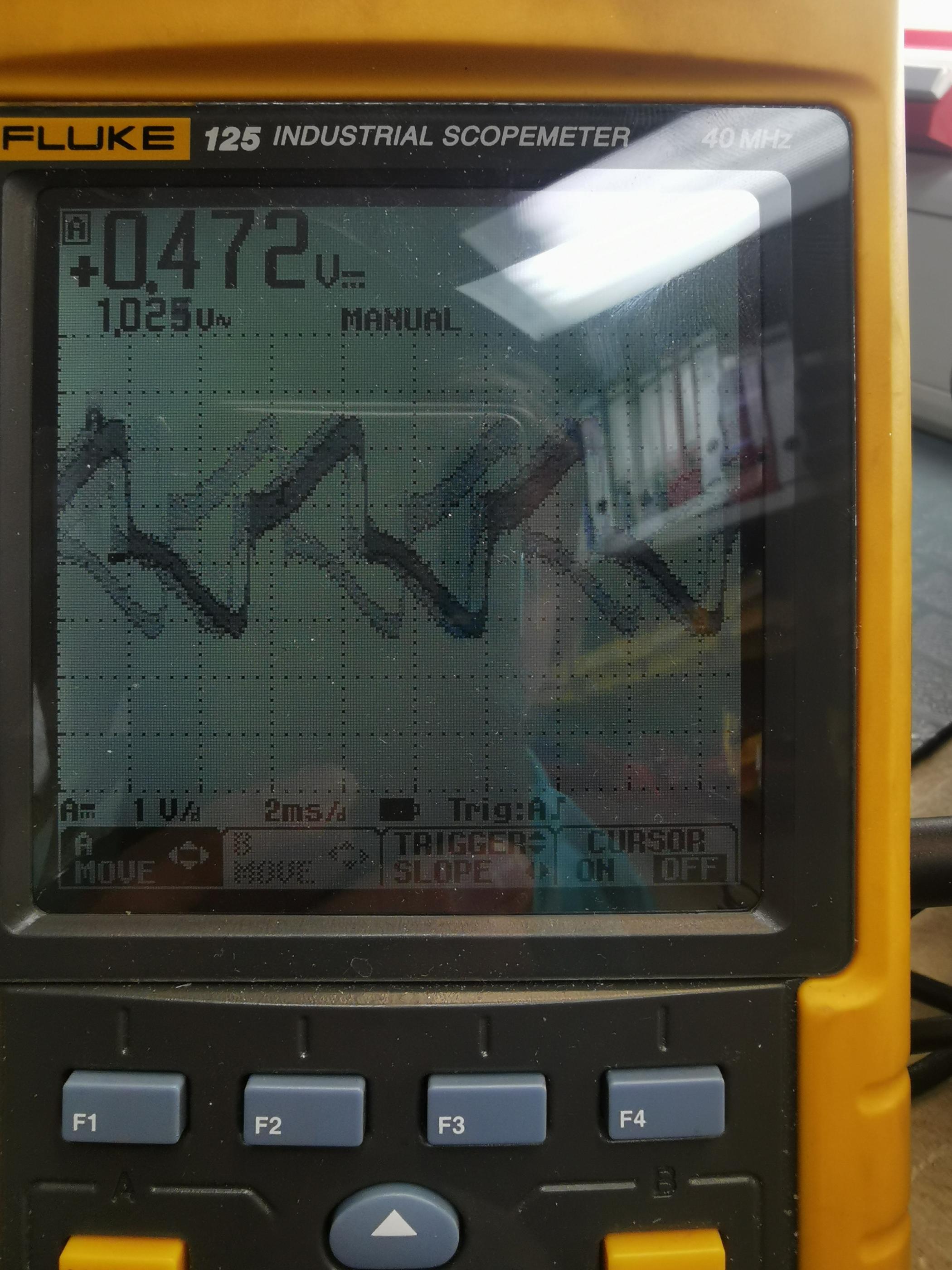

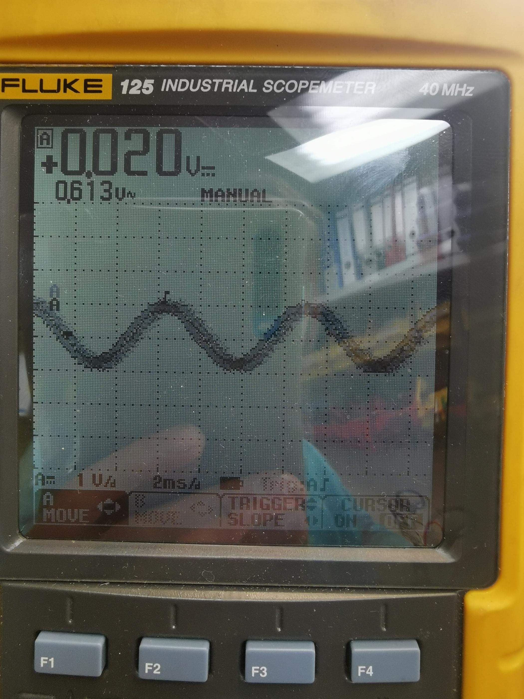

The second and third picture are the disorted channel and the reduced output channels. The last two pictures are from the working channels.

Continued today.
Must be some Audio ground issue in the pre amp side.
If i inject a audio signal at C150, and connect the ground to the rca ground, the signal is lower and slighty disorted. If i connect directly to audio ground, the signal is clean.
That means, if i inject the signal directly into the NE5532, everything is fine..
