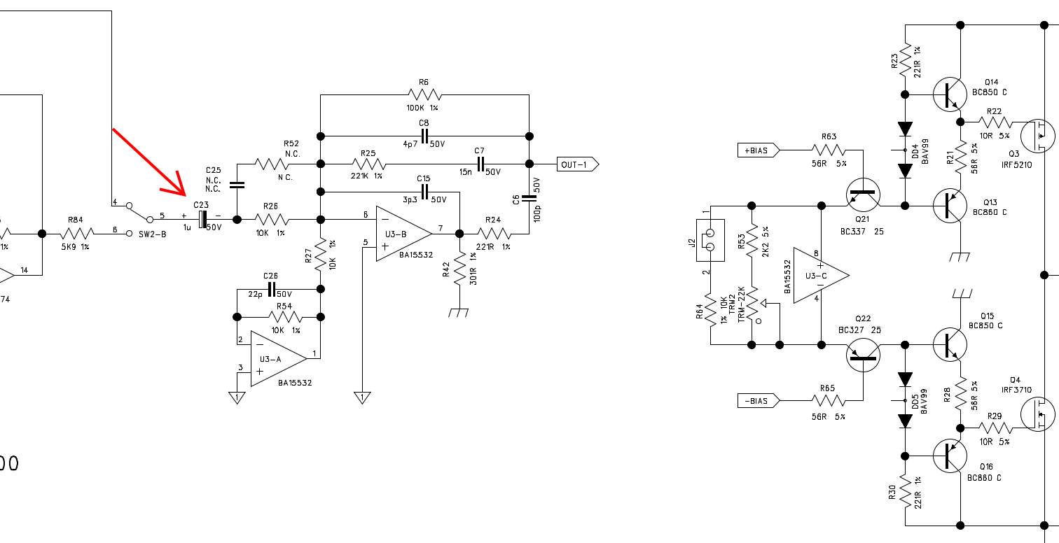

I expect the TL072 at the input.

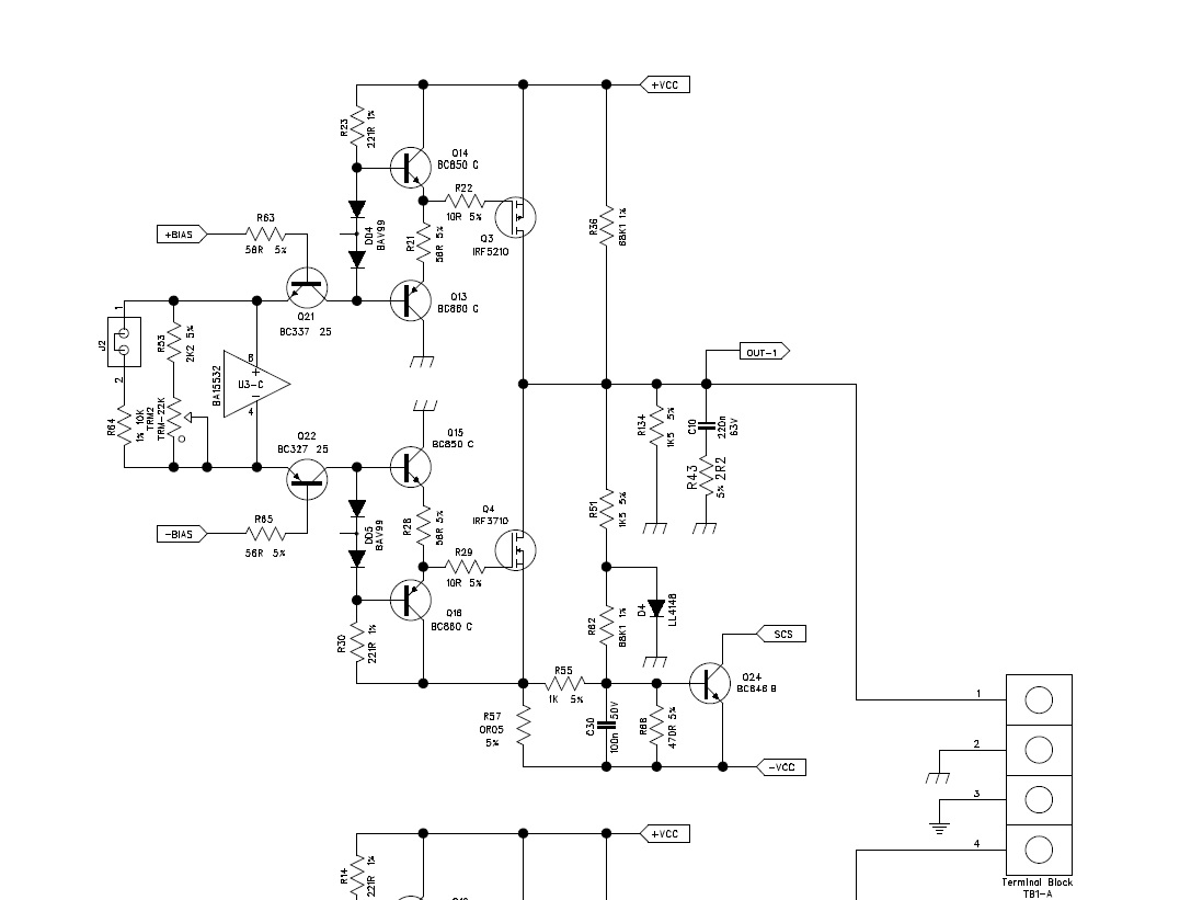

The op amp with 6 Volts is this circuit. Its nearly exact the same.
The other in the Preamp board have 30V.
So iam not sure if the voltage is correct, because this op amp is in the bias circuit.

Yes, i build it like yours. Works very well. But in the preamp circuit, i cant here any disortion. Also when the ground from the tracer is connected to the rca shield, and i place positive at the positive speaker output. Only when speakers are connectedt to the terminal, then its starts disorting.
When i check with my DMM the voltage of the op amp in the bias circuit, the current draw is rising, and the amp goes in protect, but only from the left channel. If i measure on the right channel, it shows 6,6V DC and the current rise only 100ma..

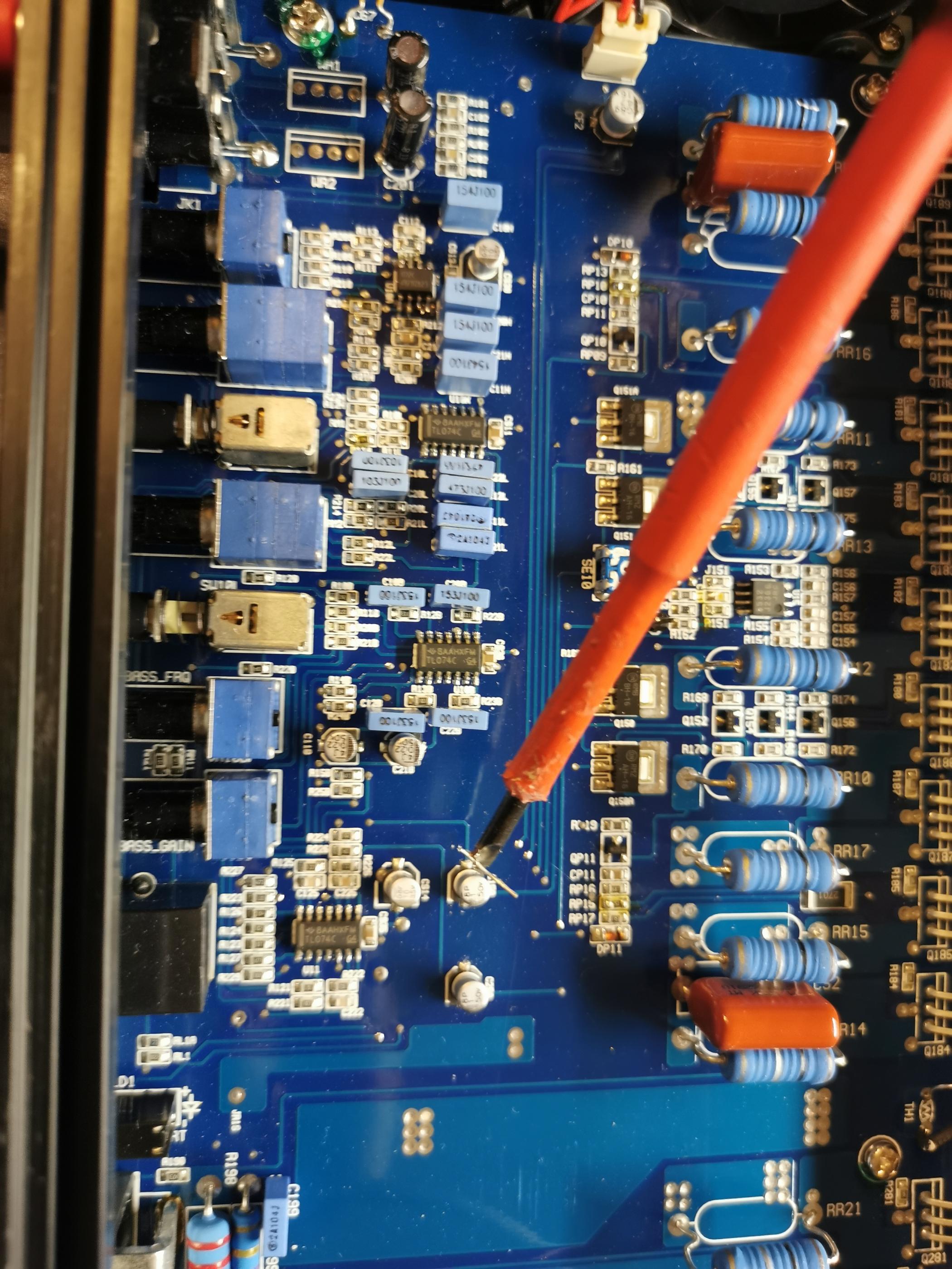

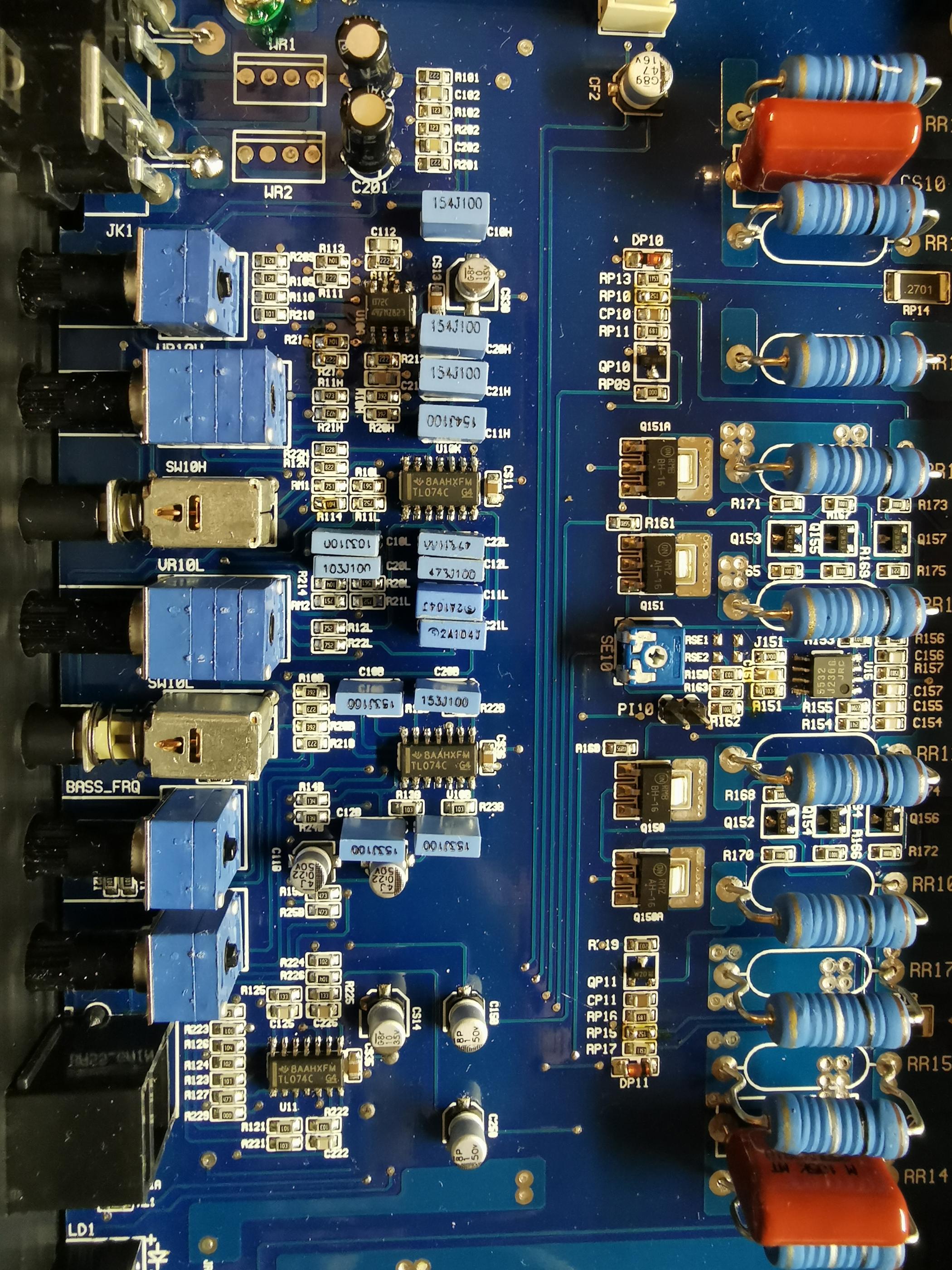

On the picture with the caps marked, I have clean, loud audio. Also on the tl074 left below. If I try the other op amps, the audio is very weak, and disappear,when I hear over the tracer. I use pin 4 for ground, and the op amp outputs for positive.

I don't know if pin 4 (-15v) is a good choice. Find a good (close) secondary ground point). It may not make a difference but you'll definitely have a good reference.

The only op-amps that you'll have clean signal on are up to about where I marked on the diagram. Beyond U3B, you are in the feedback loop and may have almost anything (most won't look like clean audio) up until the output if the amp.
Ok, tried secondary center. ... All the same. I have good audio at the rca terminal. If i try op-amp in the bias circuit. Pin 1 and 2 are very loud, and disorted, Pin 5 and 6 and 7, are less loud, but also disorted...
IC U11 in the second picture, left lower one. I have the only with good signal, But this one is in front of the remote connector .
