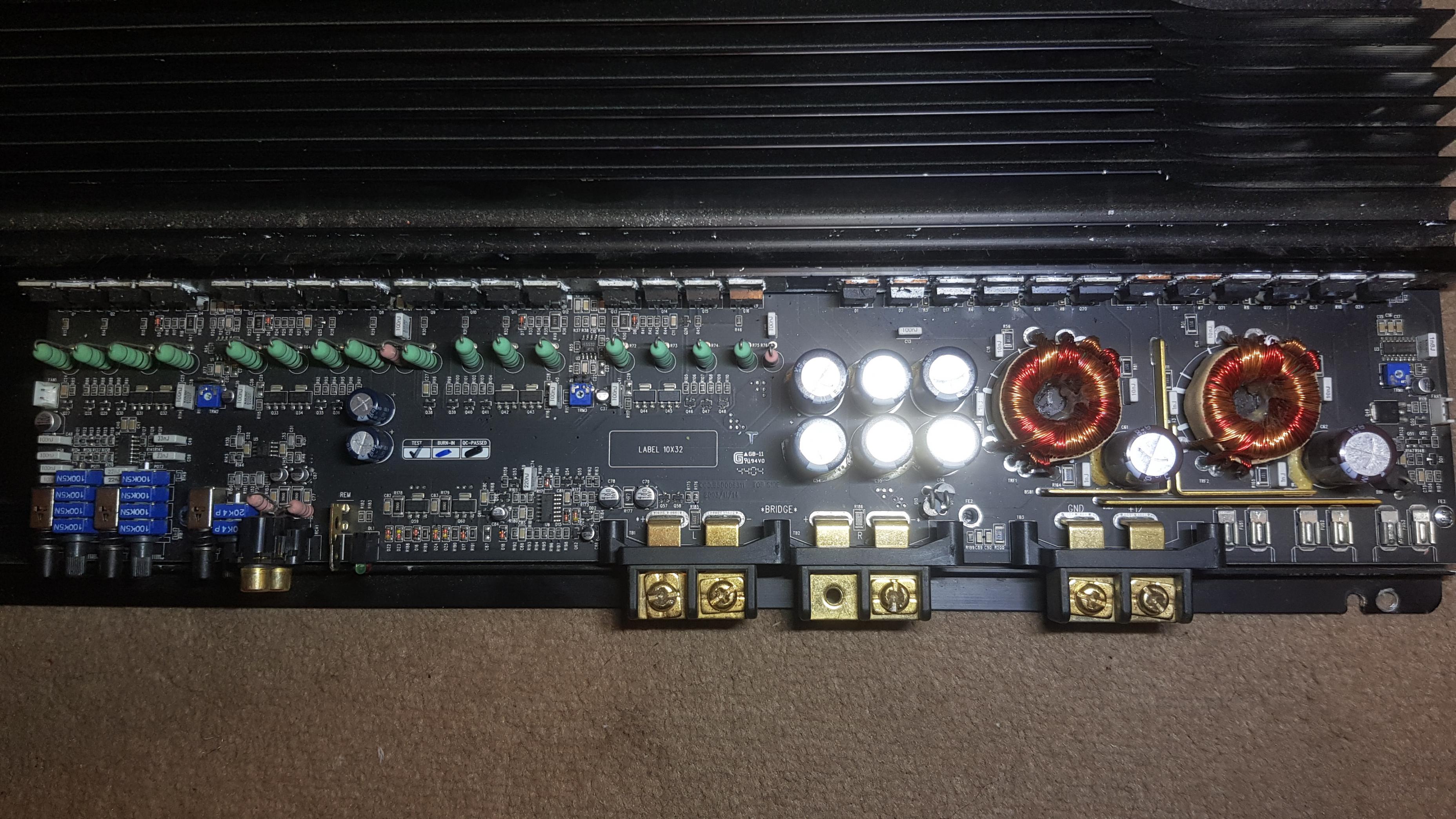

Hi, this is the first amp i'm trying to fix and don't really know what i'm doing so you can slap my face and say i'm wrong.
I know this amp is old and outdated but in the same time i know it's a decent one that can satisfy some nice mids. I would love to fix it instead buying some new cheap amp.
First of all you have to know i have no idea what i'm doing, the problem looks like this. Amp does turn up green light present but there is no sound, from what i've checked the power side mosfets 75333P from Q17 to Q24 are shorted.
Don't really know how to check the gate resistors but with the multimeter set on 200ohm i get some readings on R3 to R10 that vary between 14.3- 19.2 and one of them 56.4
Now i'm trying to check the rectifiers D1 to D4 but i don't really know how to do it.
Unfortunately i couldn't fin a repair manual for this amp but got the F2 190 one that doesn't really help me, even if could find the F2 500 one it would still not help me because i would probably look at it like donkey.
I'm thinking to buy new mosfets and gate resistors to see what happens when i power it up but don't really know what to buy. The closest mosfet i could find to HUF75333P is FQP65N06 and HUF75339P but this one seems to powerfull in my donkey opinion.
Any advice it's welcome
Peace
I've just discovered that the one it show 56 it's actually ok because i could read on the chip 560 rest of them are shorted, am i right about this?
Q22 is falling apart and his R8 is the one that measure 56

IRF3205 is a suitable replacement for the power supply MOSFETs. They're cheap and available. Replace any gate drive resistor more than 10% out of tolerance.
Edit your profile signature to list the equipment you have to work with.

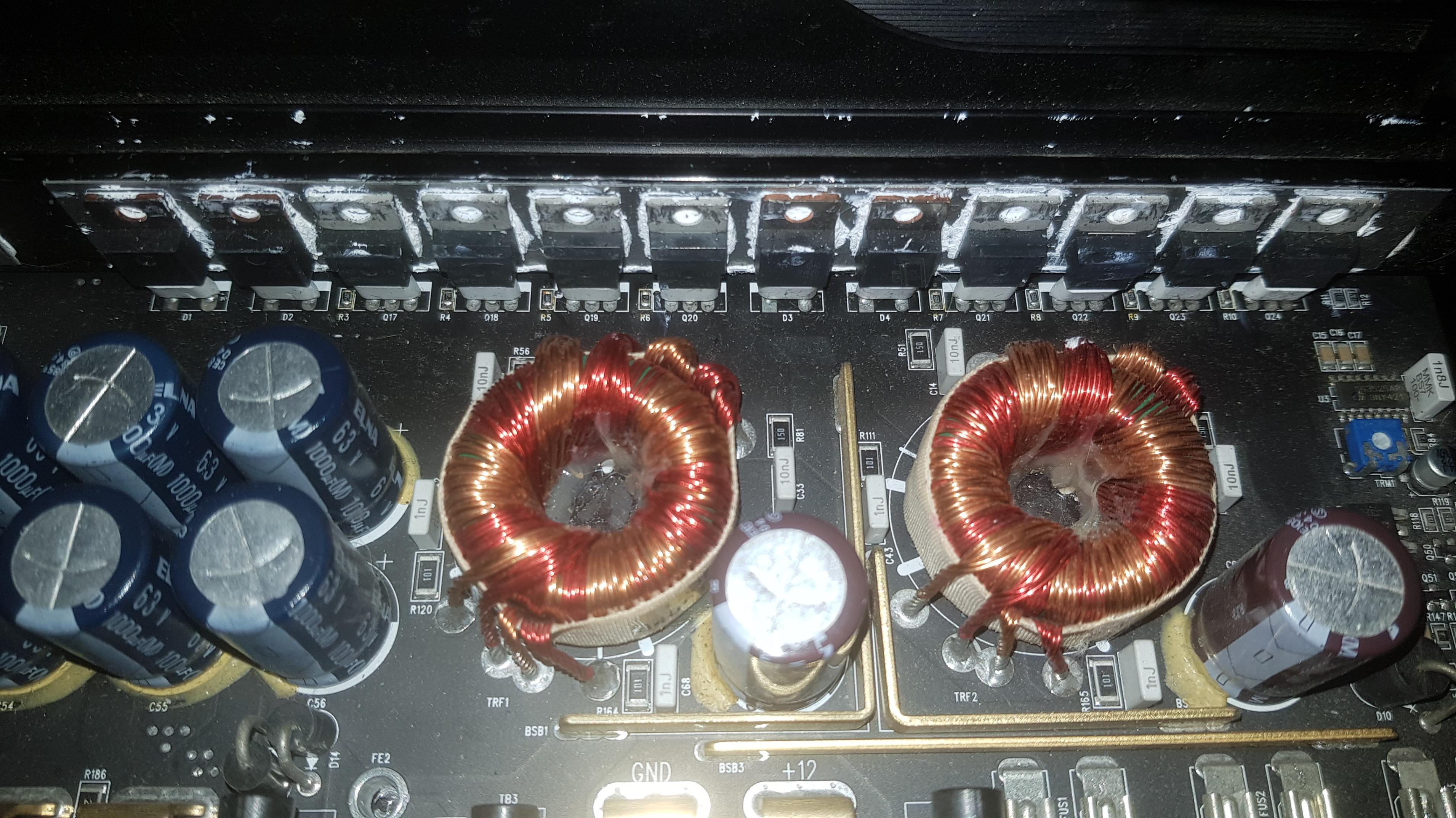

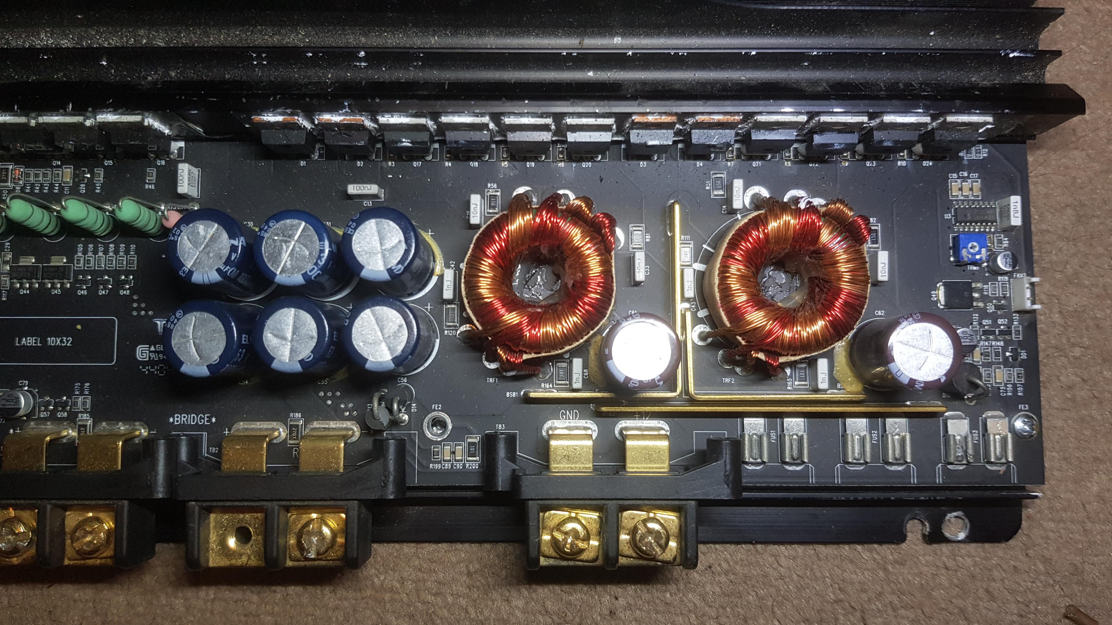

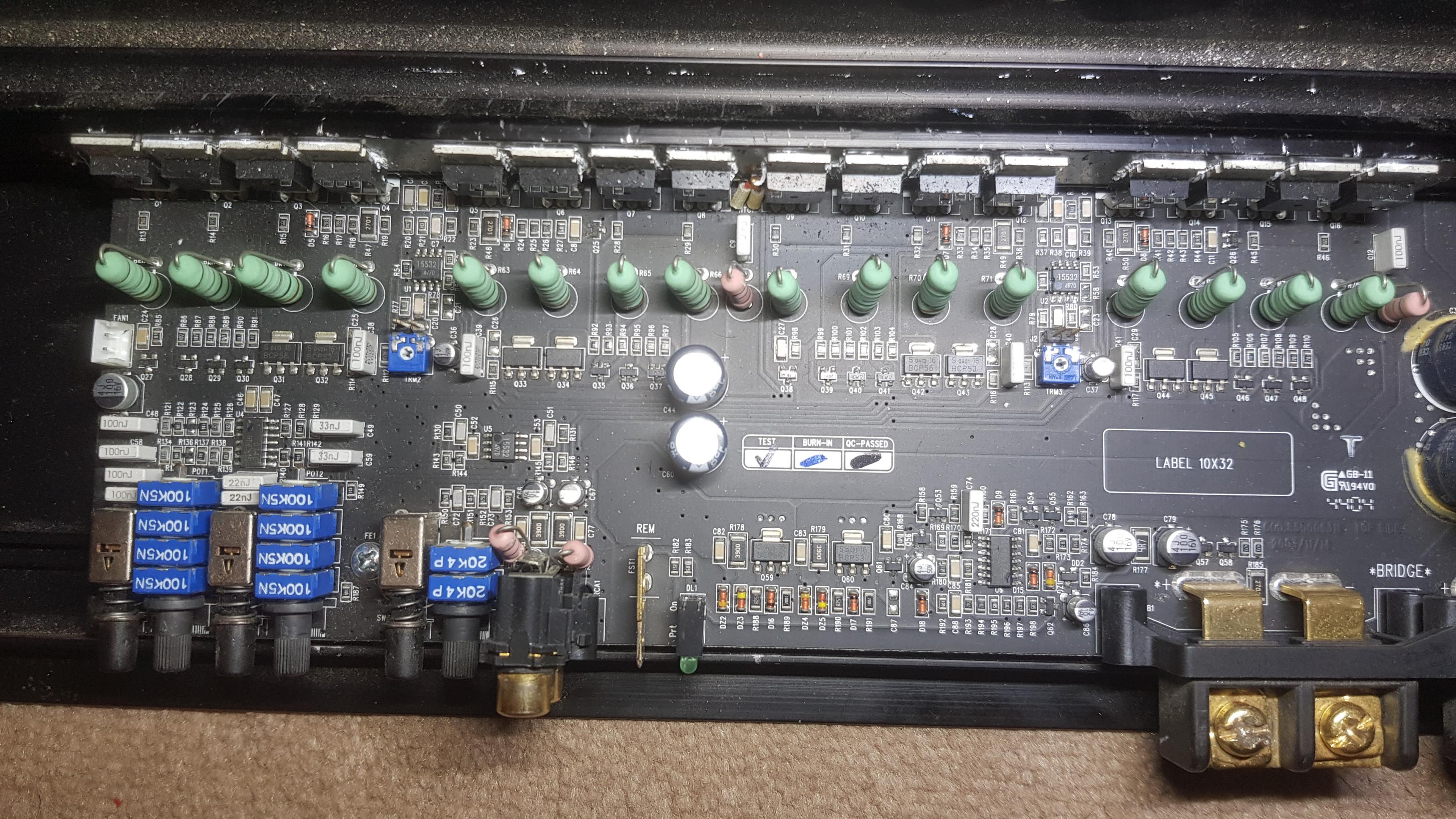

Post a complete photo of the PCB.
I will remove the mosfets tomorrow and measure the gate resistors

Took a while to upload the pictures

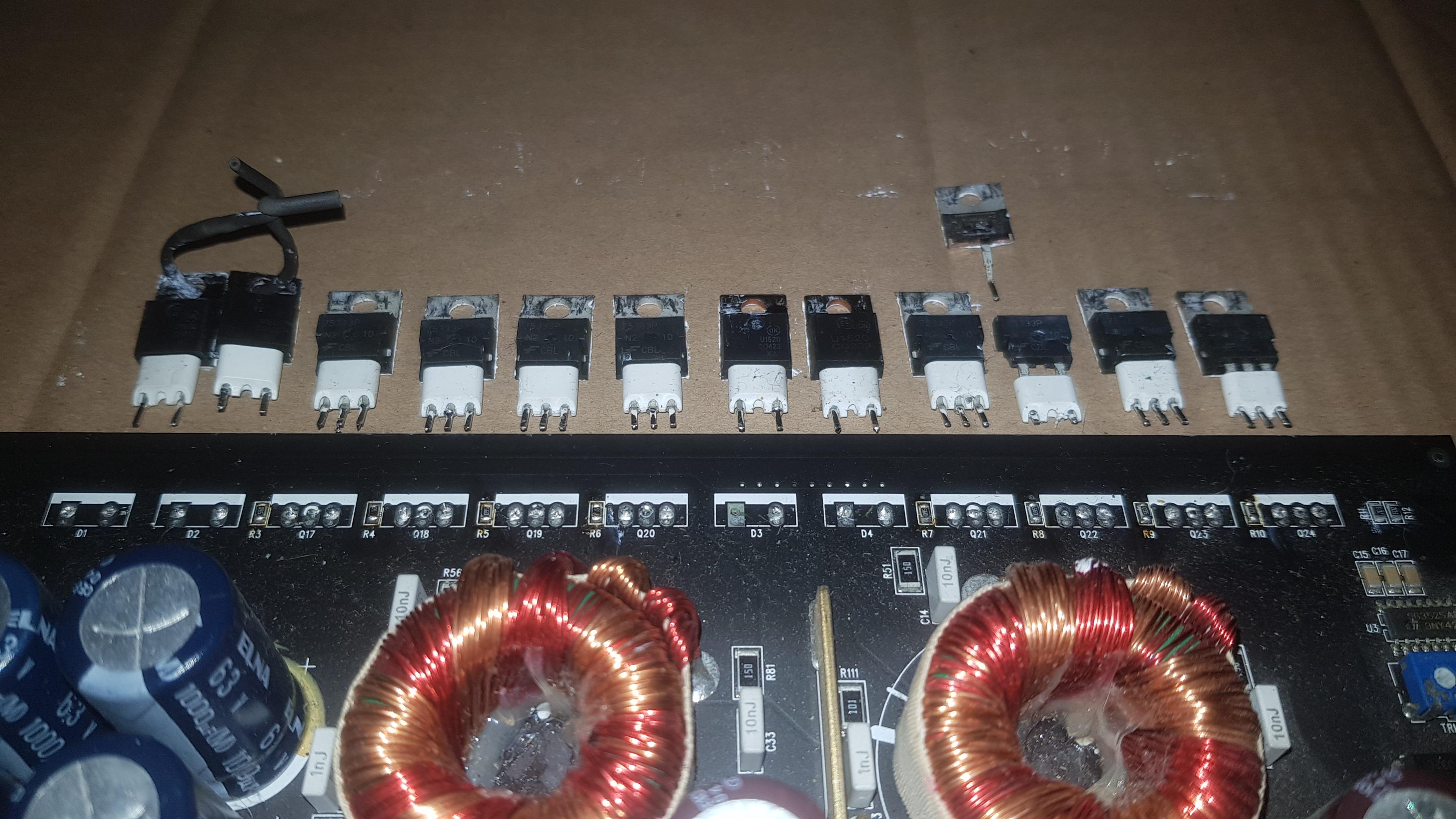

I've started to take the mosfets out and the Q22 was the first one, checked the rest of them and they not with us anymore. Hope that is pin1 and pin2 hahaha

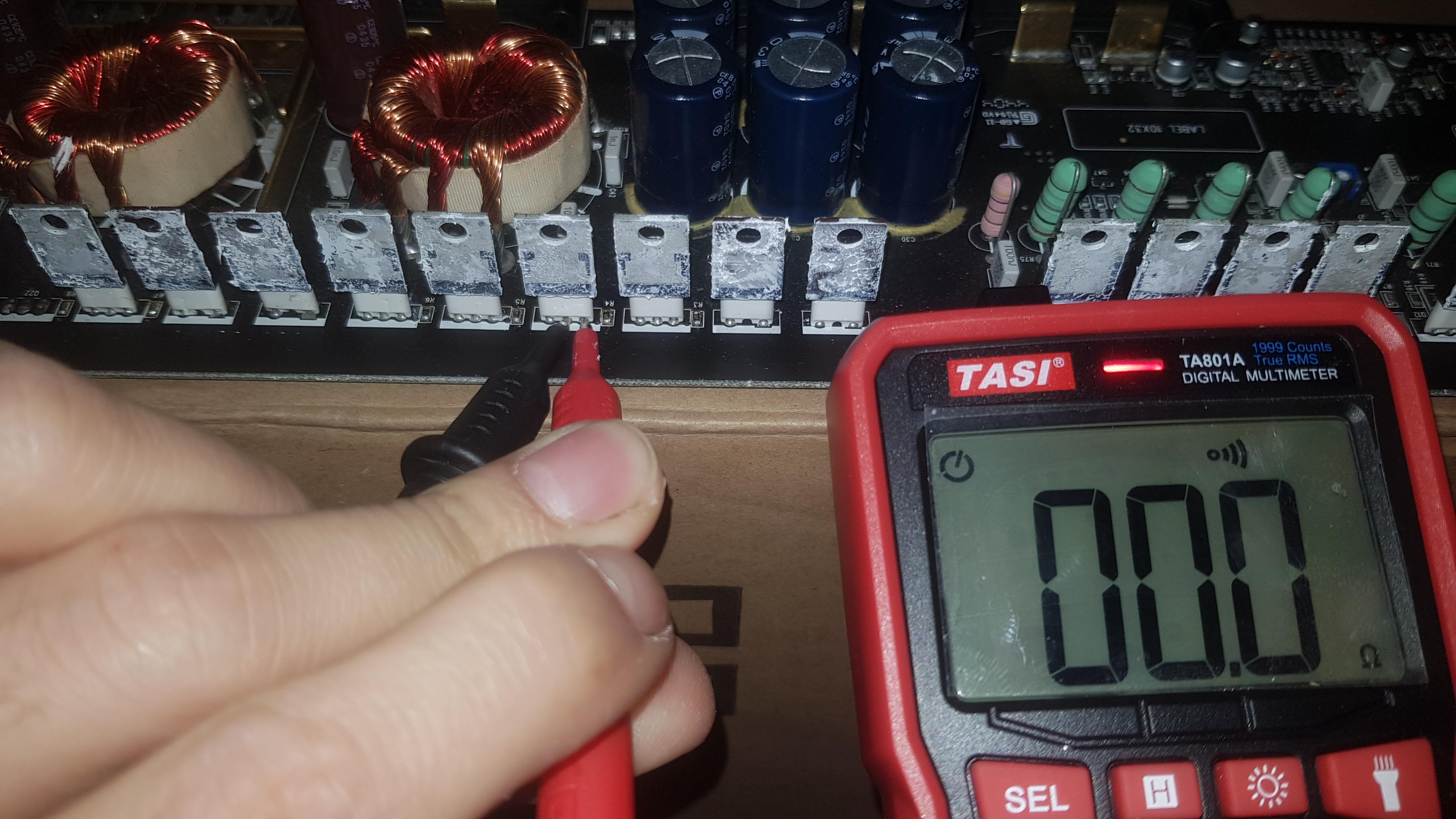

Occasionally, when only one FET fails and there is no sign of burning of the gate resistors or the other FETs, you will have enough FETs to survive to continue testing with the power supply functioning normally. If all of the rest are reading 000 on diode check (the same as when the probes are touching), the other FETs have failed as well.
They are out and readings are like this:
Q17 > Q24 000
D1 .408 >< OL
D2 .408 >< OL
D3 .398 >< OL
D4 .393 >< OL
R3 56.8
R4 57.1
R5 56.8
R6 57
R7 56.8
R8 56.4
R9 57
R10 57

Did you check the output transistors? The PS very commonly short 1-2 but the outputs need to be checked from 2-3 at the least. 1-2, 1-3 and 2-3 is more reliable.
