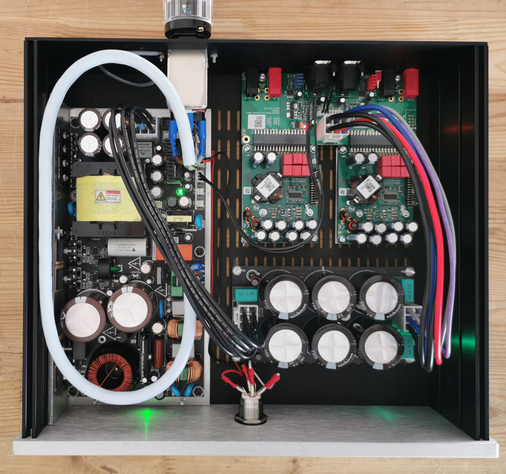

The first Purifi amplifier powered with the SMPS1K-PFC and this set becomes the worlds first!
More details can be found in the original thread.

@ Do
Thats not my setup, I built the SMPS for a friend. He is enjoying the music since he turned it on!

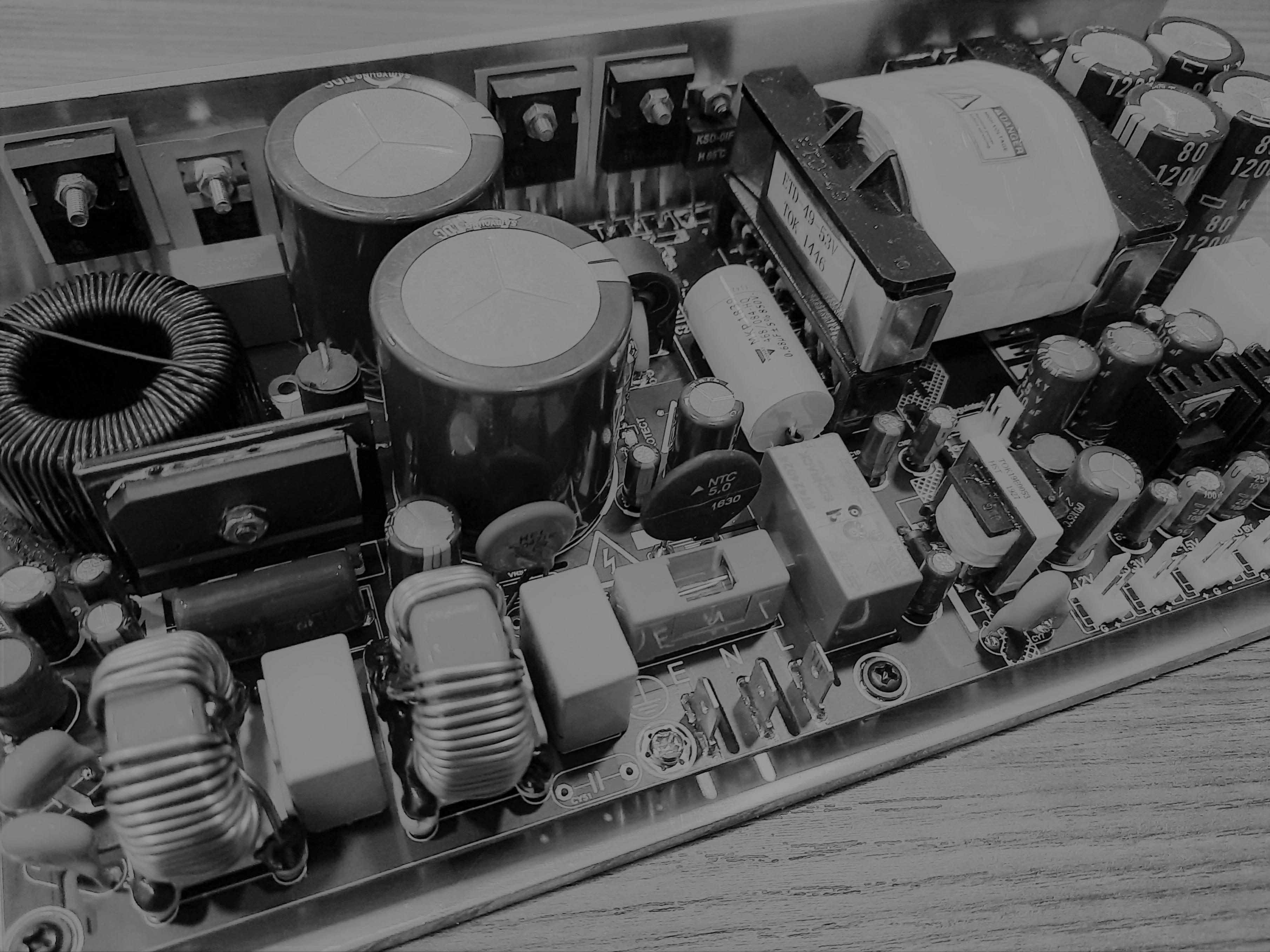

Now accepting pre-orders for the SMPS1K-PFC.
1000W SMPS with Power Factor Corrector
