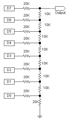

Eight bits is old, maybe state of the art 30 years ago. I built a few of this type R2R 8 bit DAC for various systems. Wasn't horribly bad and you could tell what tune was playing. I think that is all Sax is shooting for at this stage.

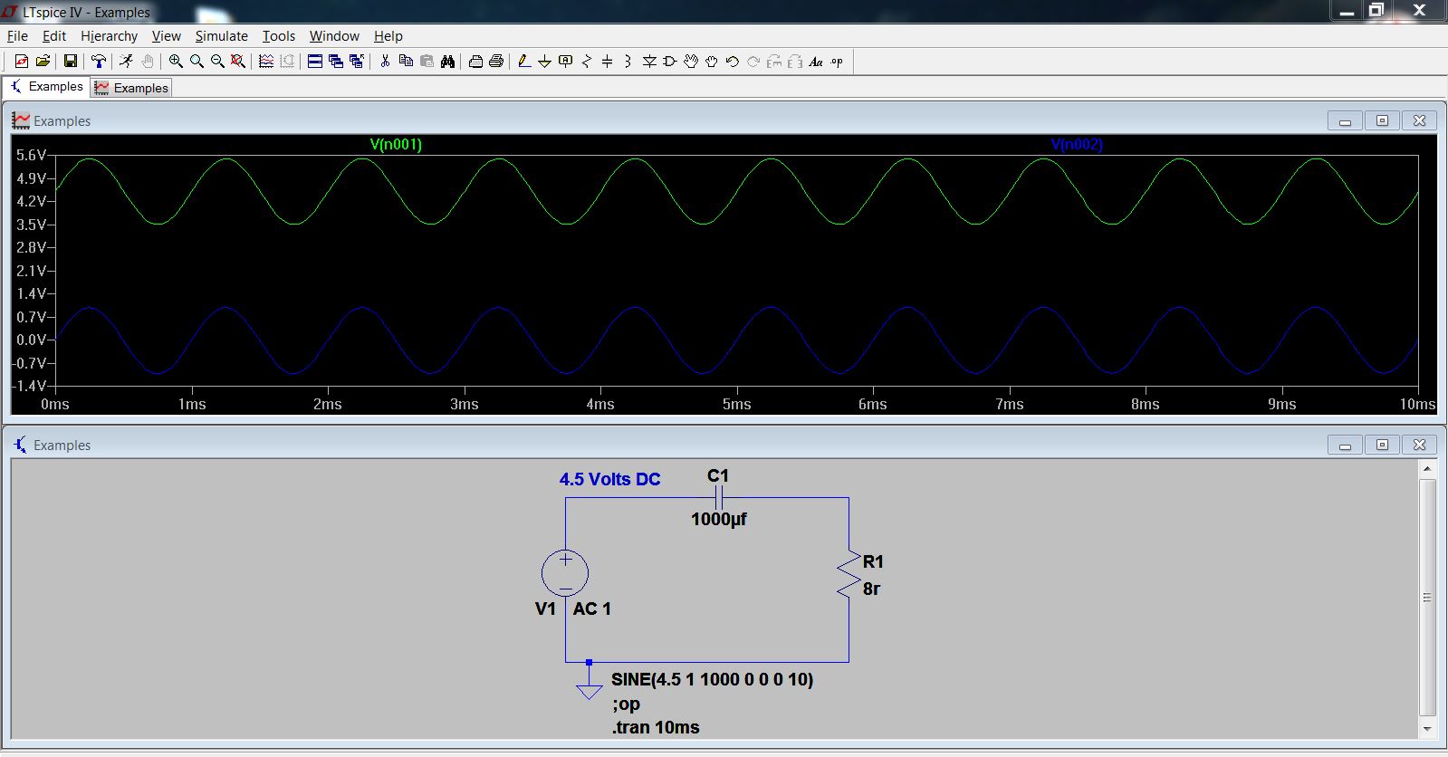

Too many posts to read all through but there is a problem with the LM386 diagram. Pin 3 needs to be referenced to ground.
Have a look at the applications here,
http://www.ti.com/lit/ds/symlink/lm386.pdf
This shows how a cap removes DC and "centres" the audio around zero for the speaker. The top trace is the LM386 output at 4.5 DC with the audio superimposed on that. The lower trace is the voltage across the speaker. The DC is removed and the speaker cone can move in and out centred around zero.
The pot will give you an external volume control, which you probably need tbh. If not then a fixed 10k would be fine.
(The gain of the LM386 circuits is high and you already have more than enough signal from the DAC. You need the pot and probably a series resistor feeding it as well)
