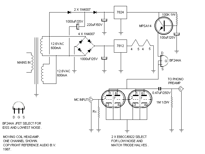

Here you go:
It's been briefly discussed here:
http://www.diyaudio.com/forums/analogue-source/252588-mc-head-amp-stage-s-using-tubes.html
It does invert signal polarity though. (Don't know what I was thinking....)
Cheers, 😉
Here you go:
Cheers, 😉
Brian is not going to like that CCS! I even call the optional resistors between the CCS and plate of my preamp designs "The Brian Beck Memorial Resistor."
If you sub a resistor for the CCS (one large enough to not kill the gain, say 5-10x rp) and correspondingly raise the B+, do you see a noise decrease?

Never tried it but if you replace the CCS with a resistor you'd end up with something like the Hampton circuit.
Hampton MC
I would expect a bit more distortion (predominantly even order) compared with the CCS loaded design.

I thought this post needed a little re-visiting, considering I would like to try my hand at an all tube MC pre, I haven't found much information on this pre from ARC, the archive page says that it was reviewed by Stereophile about the same time it was introduced and was given a positive review by John Atkinson. I have been wanting to "grab the bull by the horns" on this endeavor, and have done quite a bit of research on what might be the best way to approach this. I know that Mr. John Broskie has had several article's on His Tube Cad Journal site, expressing his interest to do the same. Since I am so fond of mu-followers for their low noise, and distortion, I was thinking why not implement this topology, of course using paralleled 6922 triodes for the input? What would be the possible S/N figures for this one, would 80dB be out of the question, using stabilized B+, heaters, etc.?
Have taken a look in the "Analogue Phono" section of this forum?
MC ready preamp stages using valves are rather rare but if you're interested have a look at my design which uses //ed 6922s and a solid state ccs.
Best, 😉
Best, 😉
You'd be lucky to get that out of your cartridge. Even worse, once needle touches vinyl. If you get 60dB out of a tube stage, you'll be doing well. Want better? Use an input transformer.
...using paralleled 6922 triodes for the input...would 80dB be out of the question...?
Yep, 'fraid so. For anything close you would need paralleled input FETs or a step-up transformer.
