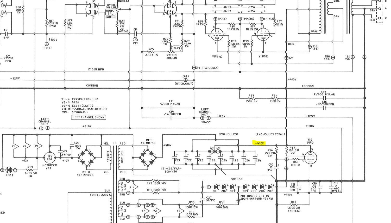

i'm a new member in here as i found this thread at google, maybe i can throw in my problem with my D90, hoping that someone might give some insights.
My D90 is almost 2 yrs, bought it used and no idea of the tubes life and this is my first tube amp. 2 wks ago, i had this humming noise coming from my speaker and came out that it's the D90 not my tube preamp causing the hum. Read some blogs that most of hum noise were caused by faulty power tubes 6550. As this 6550 is quite expensive, so i tried to swap firstly the input tubes which didn't solve the issue.
I did a voltage test, i'm getting the -125 and 310V but the 410V line coming out from the bridge rectifier is dropping to 325V. i tried to put a new 6550 on the V19 thought that it might be faulty and it's the controlling the 410V but still didn't solve the issue.
Checked the bridge rectifier by diode test, seems OK. getting a 0.6V bias voltage at power off. Now, i've runned out of options before i buy a new 6550, woudl liek to ask anyone of you for any recommendation or if you encounter same issue before and how did you resolve the issue.

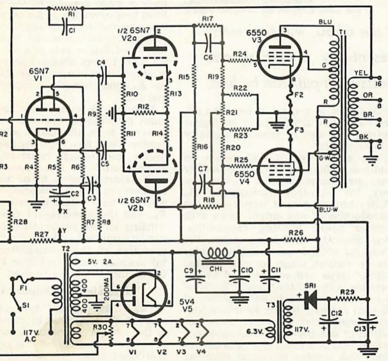

Thanks for the hints about the varnish. I will make sure that it's not water based.
As for the bias, my problem is that the Voltage drop I measure over the resistor is varying rapidly. It jumps up and down by as much as 5 or 6 mV. (Which effectively is 5 to 6 ma, as the resistor is 1Ohm.)
This happens on all 8 valves, so there must be a common source. (Which isn't the supply Voltages. Those are stable.)
Let me try to attach the schematics to this message.

You need at least 80V across the 6550 for it to regulate correctly, the plate supply should at all times be above 400V at nominal line voltage.
Check the bias supply, should be -125V approximately. Idle current is about 75mA per output tube.

Need to have another look, it's not a shunt regulator at all. It is in fact a cathode follower for a big stack of zener diodes.
WRT bias currents that's not my experience at all, one of the big problems with the higher power amps is the extremely high plate voltages and modern 6550/KT88 which malfunction as a result. The D90 should not have this problem with its comparatively low plate voltage.

i can get the -125V and 310V line stable but not that 410V coming from the output tube V19.

The 410V is the main B+ voltage , just rectified and filtered with those paralleled electrolytics from the transformer . Then the 310V rail is coming from V19 wich is a simple series voltage regulator . If the input (410V) is only 325V then the regulation is not good and could explain the hum . This is the supply voltage for the small signal tubes .
If 410V rail is too low you should check the alternating voltage before the bridge ~310 Vac . Then try to pull out the output tubes and see if the voltage goes up .
just scoped that 410V line and seeing a trapezoid like waveform with gittery edge, i believe this line should be pure DC, right?
and measured the voltage before the bridge rectifier, one side is 162V.
is it safe to pull out that tube V19? remove v19 while it's powered on or before powering on?
also, i'm a bit confused 410V coming out from rectifier and 310V from V19.
schematic show 310V before rectifier or transformer output and i measured 162V on each side. isn't rectifier just changing the waveform from ac to pulsating dc but not the voltage level then those power caps remove or filtered those pulses to make it DC then V19 should be the one amplifying it to 410v?

Thats just a coincidence that the transformer secondary should be 310V AC for 410V DC rectified and the DC voltage regulated after V19 is 310V DC .
The alternating voltage must be measured across the secondary winding .
410V should be obvious DC voltage with a bit of ripple . If not check the connections with those paralled electrolytics , I doubt that all of them have dried out , eventually check them .
