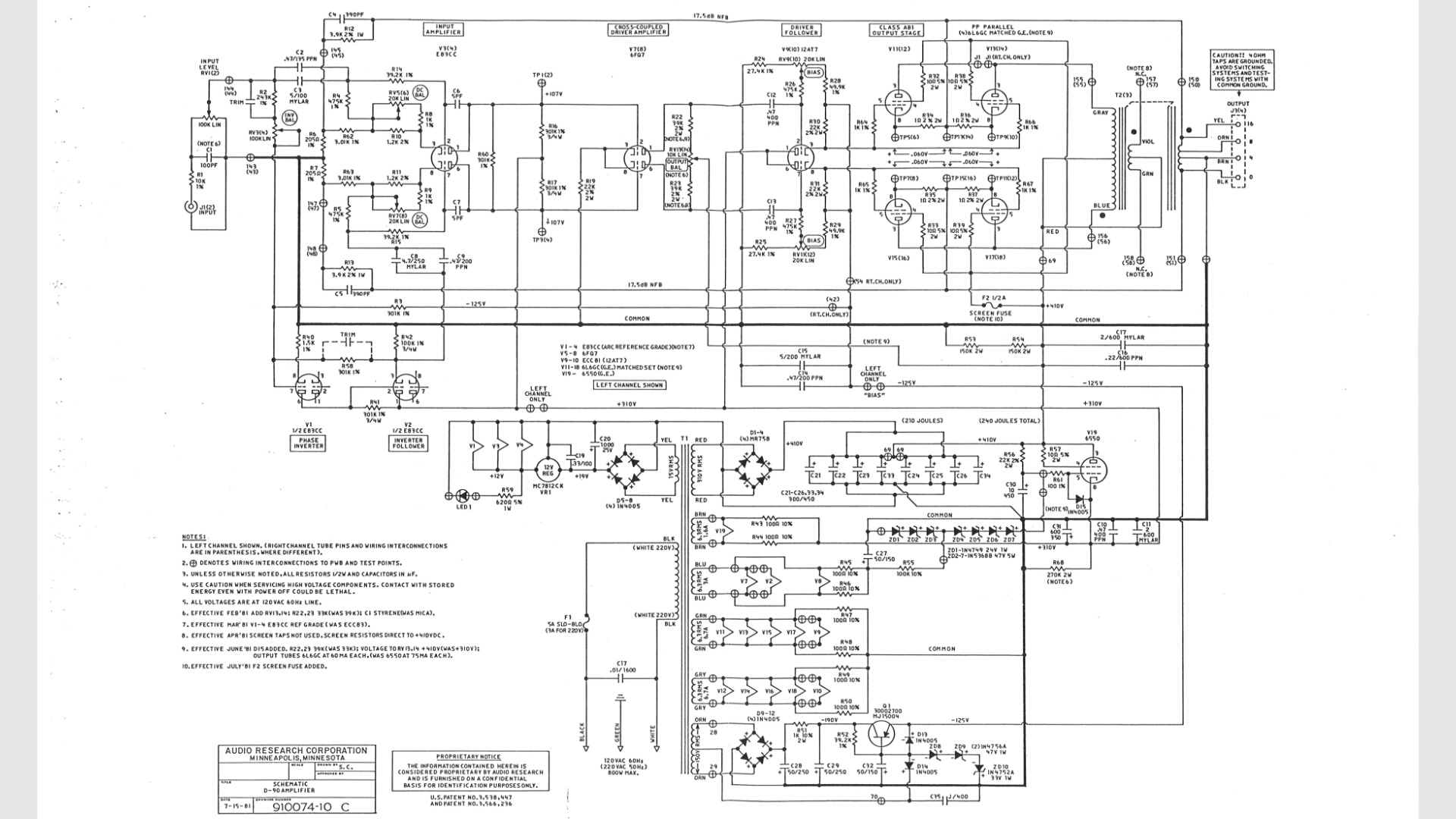

Thanks for the hints about the varnish. I will make sure that it's not water based.
As for the bias, my problem is that the Voltage drop I measure over the resistor is varying rapidly. It jumps up and down by as much as 5 or 6 mV. (Which effectively is 5 to 6 ma, as the resistor is 1Ohm.)
This happens on all 8 valves, so there must be a common source. (Which isn't the supply Voltages. Those are stable.)
Let me try to attach the schematics to this message.

If youd liek to know more about V9 and V10, check the diagram I've uploaded a few messages ago. It looks like they emit a slightly unstable DC. The negative grid bias is derived from the output of these tubes.

the cathode followers are directly feeding the output tube grids...
so that what you do with biasing is adjust the grid bias on the 12at7 drive followers,
what i will do in that case is to replace the bias pots with better quality ones
like the bourns multi turn types and see if that improves the situation...

Anyway: I have narrowed down the issue to 2 prossible causes:
1) The 6FQ7's seem to be pretty worn on my unit. I am ordering new ones to see what that will do.
2) The 310V line is bad. That is to say: the Voltage creeps up with rising temperature. It looks like the zeners that are used as a reference, became pretty temperature sensitive after 35 years. I will replace them as well. Hopefully this will solve all issues.
The 325V has a direct relation with the bias, although the 'real' bias supply is -125V.

Installed the new 6FQ7's with no result at all.
I checked the power lines with my scope and... Bingo.
There's a big saw tooth on the 410V line.
The ideas about bad rectifiers might be correct after all.
I just wonder why this riple isn't suppressed by the fairly large bank of (new) capacitors on this line.
Can you guys explain this?
About two years after, it is time for an update.
I still run the D90 in my main system, with great satisfaction. (Although I wasn't too happy when I found that my power consumption went up with as much as 40% after I started using this power amp.)
After helping out another friend with the same amp, I found that stable bias is not possible on these. So be it.
I did change the rectifier diodes and that improved the sound quite a bit (one of the old ones appeared shot) but the transformer buzz stayed.
Well, that is... Until I got my hands on a PurePower 1050 regenerator. I connected it in the power line and bingo: dead-silent transformer!
I did measure my wall outlet and found 1,5V DC on it. That is not good for any tranny. (core saturation.)
A borrowed Classé Ten dit exactly the opposite: It buzzes on the PP and not on the normal line. Weird... 😱
