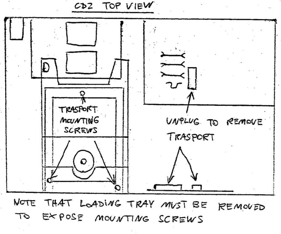

I would replace the loading belt. I think it is a Sony mechanism so nothing special.
Here is a rough drawing of the assembly from the service manual. The belt is under the tray.

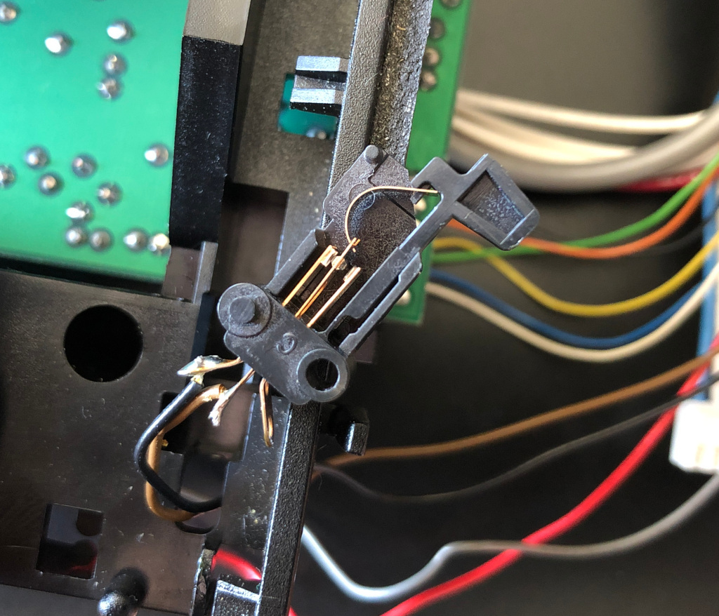

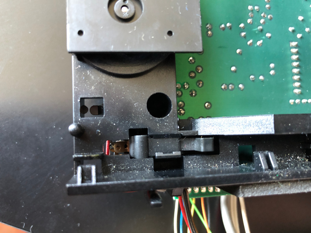

Found the switch. No idea why it didn't hit me before since it's fairly loud.
Anyway, when taking it apart from the transport and using my multi-meter to beep its connections, I notice the contacts make a bad connection.
Could barely get a beep out of it.
So I definitely need to find a replacement for that. Anyone know the exact name for it? 🙂

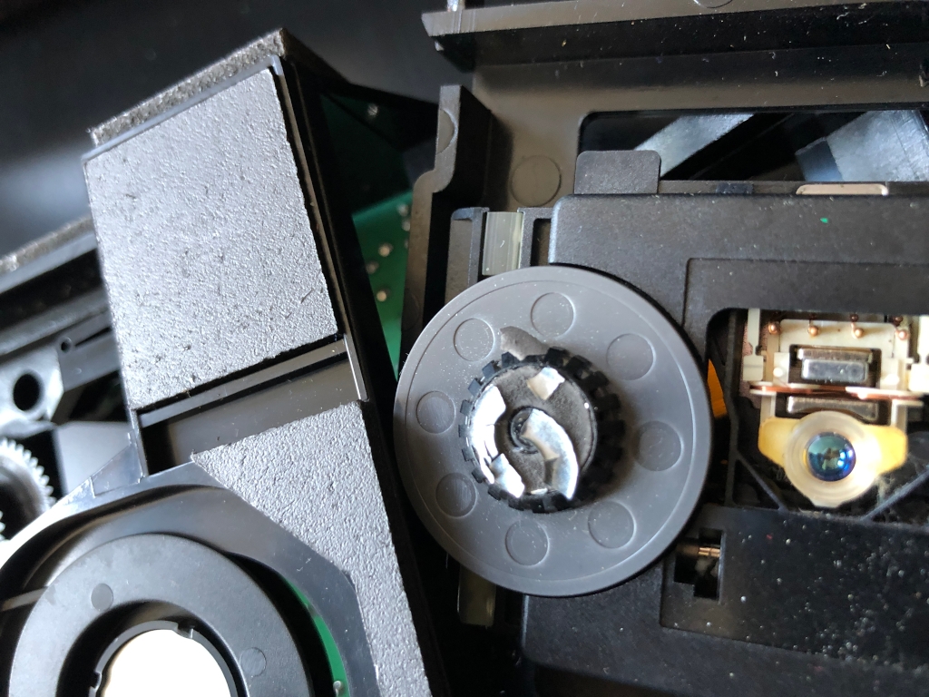

Also, when pulling the transport apart I noticed the center thingy that goes into the CD hole and pushes it up against a ceiling ring (really now idea what they are called) has cracked on top. It's like the chrome/plastic part.
So that needs a replacement too.
Feels like I will need to look for a entire replacement for that part?

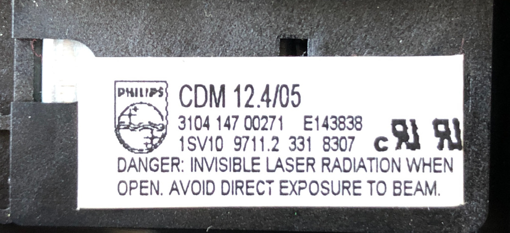

Also made a picture of the exact CDM model. CDM 12.4/05
Problem solved. Dad to the rescue 🙂
Turns out the problem were the contacts having baked dust on them, or corrosion.
Something like that.
Fix was to use some 12000 grid sandpaper and rough it up a tiny bit so it properly makes contact again.
Tray opens and closes fine again 🙂
