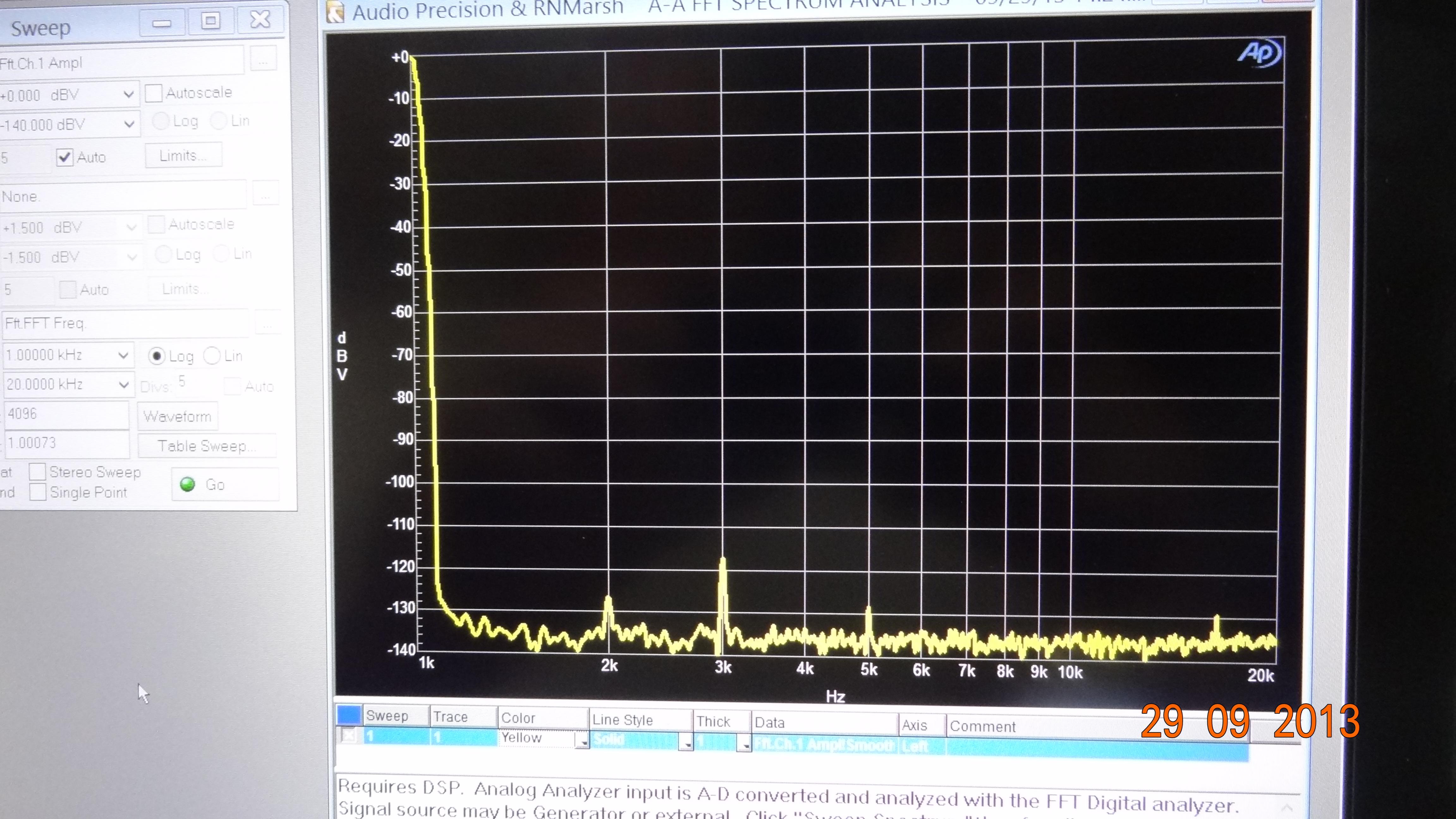

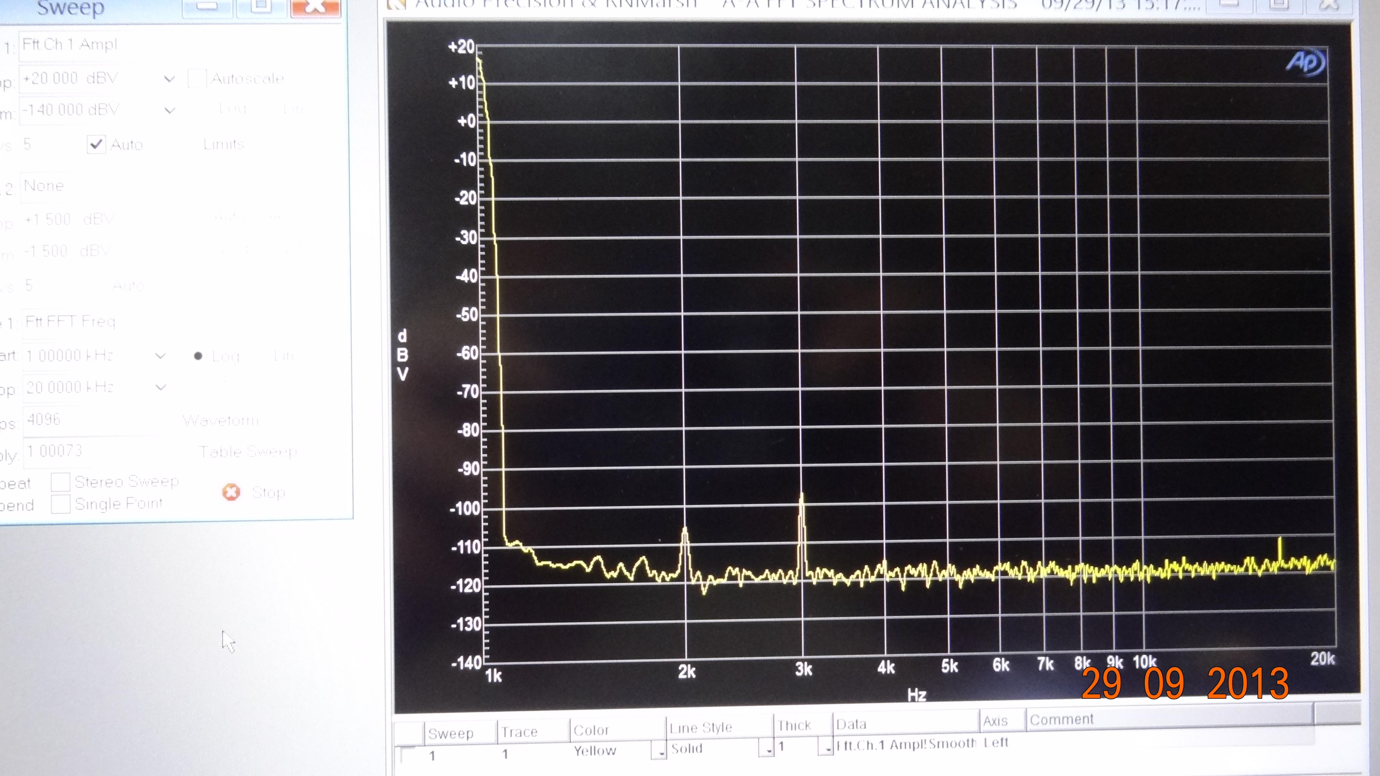

Comparing FFT data results -
I looked at the FFT data of three tests -- from 3 sources and 2 FFT's (1v/1KHz):
Using the AP2722 - the 2H levels differed the most over time - about +/- 2dB (4dB total). More variation if the instrument isn't warmed up for at least an hour. Seems to be all thermal related.
The K-Hite 4402B generator with simple opamp and trimmer upgrades, measures almost as well as the A-P -- 2H = -122-126dB and 3h= -114dB
The ShibaSoku AG16B measures -- 2H -124dB and 3H = - 118dB
The A-P 2722 internal generator measures -- 2H -130dB -126dB and 3H = -116-118dB.
But from a QA400 (using ShibaSoku AG16B generator): we get these levels: -->

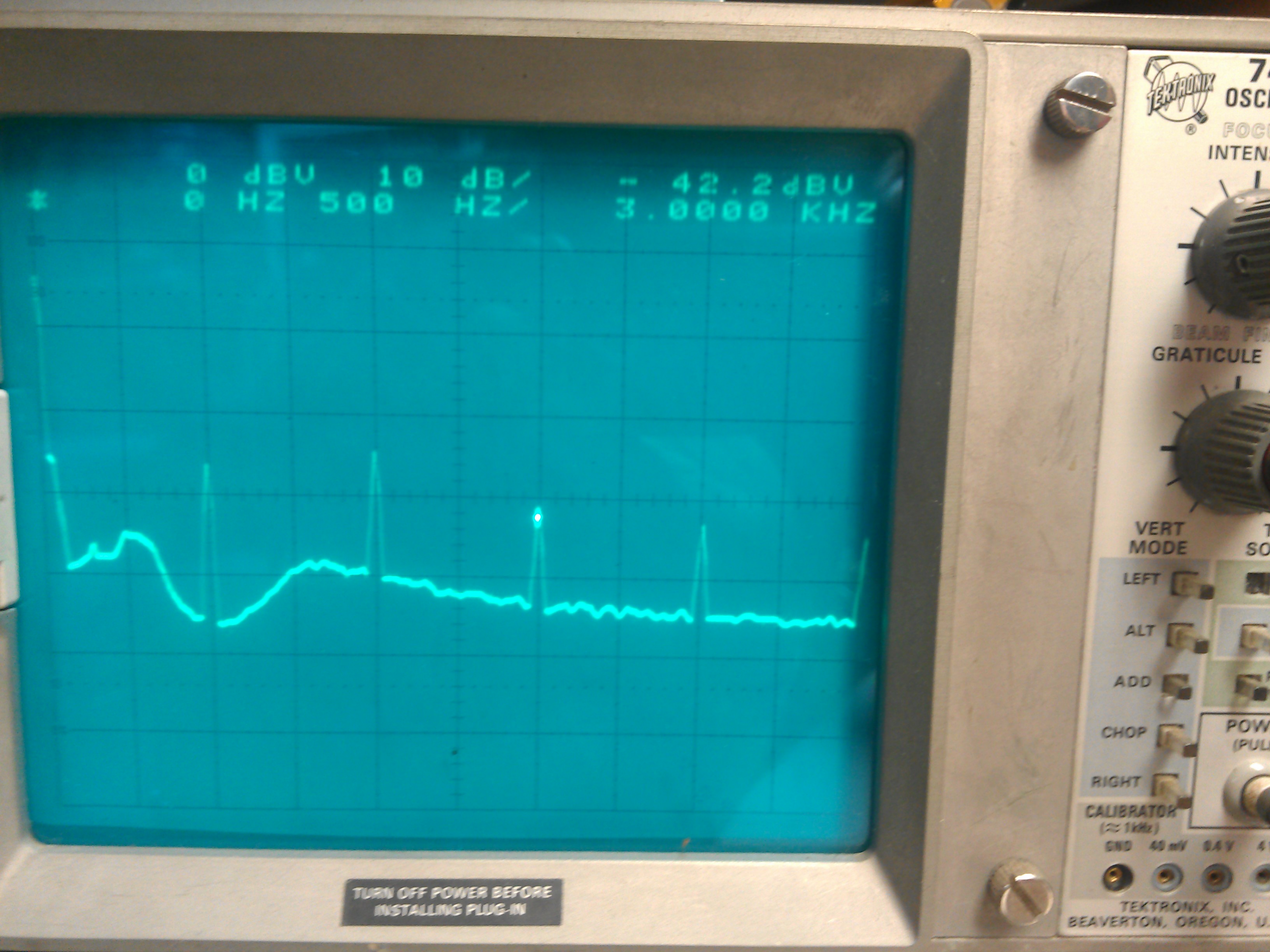

Its interesting that you are seeing more third harmonic than second. Here is what I get using the Shibasoku 590AR at approx 7V into the Shibasoku 725 on the monitor out. On the monitor out of this unit 1V = -90 dB. On the Wavetek display the top line is 1V= 0 dB. The fundamental is -126 dB (-136 diplayed) the second (always the highest in my measurements) is -124 dB and the third is - 132 dB. This is what I get with the Shibasoku generators.

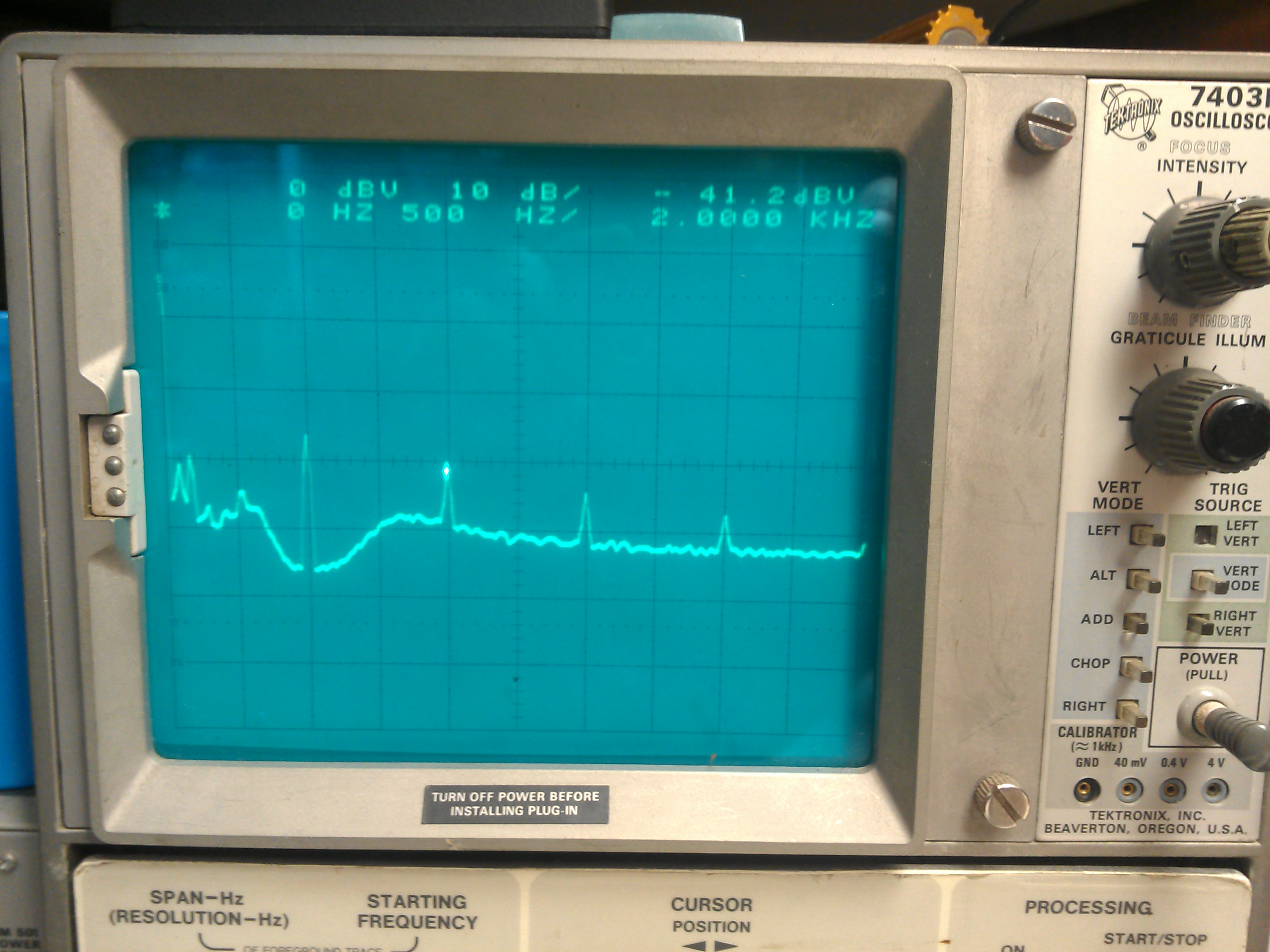

The second picture is my modest KH4400 with the LME49990 mods and judicious tweaking of the distortion control. I know if I even wave the tweak tool at it it will never be this good again. As you can see the fundamental is the same and the second is lower than the 590AR at -132 dB (corrected). However the noise floor is not quite as low as the 590AR and it does not have the same drive as the KH4403, which can drive a 50 Ohm load.
I suspect the AP may need some "tuning" or your setup needs more optimization. It is supposed to be better than this.
Davada -- No. about 1db below 1v. All are used as straight from the box.
Demian -- no attempt to tweak any of them. They can be tweaked for less 2H or less 3H. I am still fiddling with things to get better data --->
BUT - look at the QA400 and what it shows is very different than the others. Much higher. How good is it with a null on the fundamental? Something to check but it definitely can not be used without doing so if you want to have accurate data at the lower levels of distortion harmonics. Note too all the trash... the A-P doesn't have any trash/grass growing/extraneous freqs.
