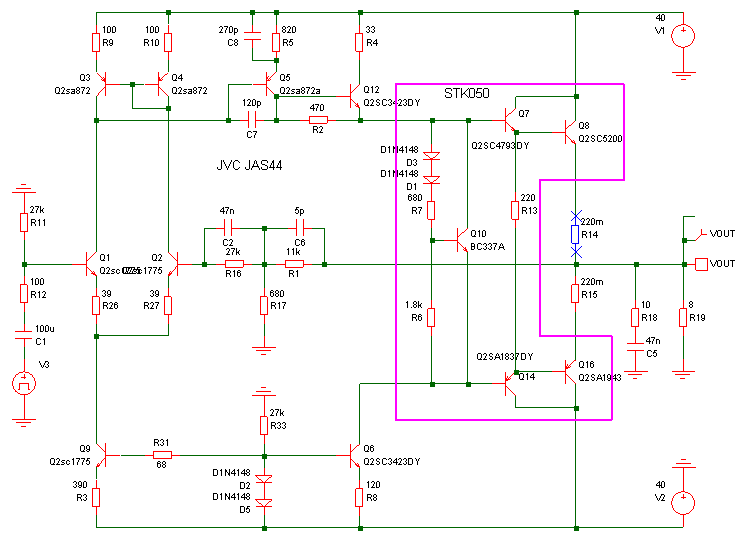

I got an amplifier from a friend yesterday , it use a packed
complementary darlington STK050 output stage , including
the VBEM , out of curiosity i checked the schematic and
did a few sims whose results where expected since it s
what D Self call a blameless but with a variant in VAS
enhancement , results being about the same , amplifier
is JVC JAS-44 circa 1977 or so , schematic is below ,
the transistors are of course different set apart for the IPS.

Q12 bootstrapping R2 has not the same radical effect as an emitter follower to feed the base of Q5 (prefered method) or a common base loading the collecter of Q5 (in a cascode scheme) to linearise the VAS.
So this JVC amp has not blameless performance.
An interesting feature is C8 in parallel with the emitter load of Q5, R5.
I wonder why a cap in this position is so rarely used.
Perfs are very good , not only THD but particularly IMD
is very low , at 1KHZ it is ppm level , IMD can be lowered
to 120dB when doing a 19 + 20khz test , OLG is 120dB....
Actualy the only caveat is the huge compensation cap
but that is due to the construction where the front
end is connzected to the OS using wires as long
as 30cm....
I ll do some sims using a double pair and a lighter compensation,
as well as a few passive components that were neglected at the time
but for sure it perform very well at first tries.
