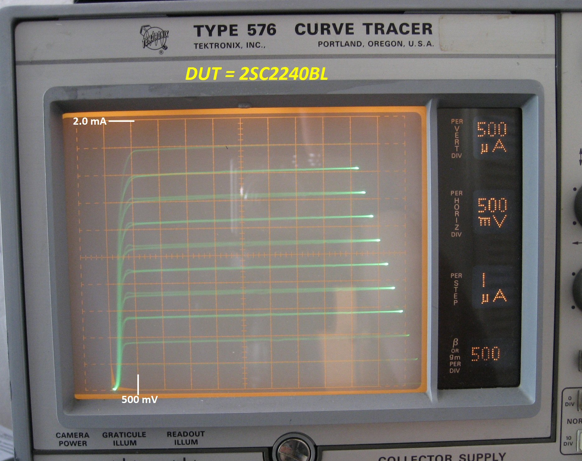

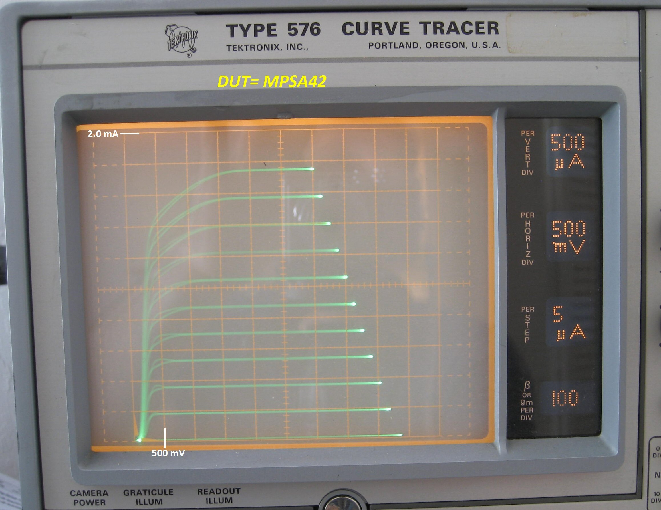

I wish the new material in chapter 7 had included a more thorough explanation of the problem with the MPSA42 at low Vce.
On p. 169 we read: The problem is that the MPSA42 requires an unusually high Vce to work properly.
Then on p.186: The MPSA42 appears to need considerably more Vce to work properly than the data sheet implies.
I wish you had included measurements of actual MPSA42 transistors, showing exactly how they are deficient. Perhaps something like the attached photos might have shed additional light on the situation. I marked Ice = 2.0 mA on the plots, since p.169 refers to Figure 7.4, in which the current mirror transistors operate at 2 milliamps apiece.
Apologies for the abysmal quality of the photos, including a reflection of the camera on the scopeface!

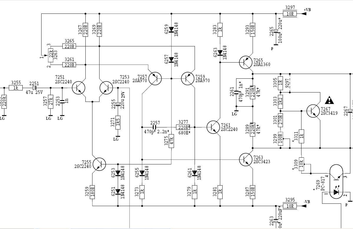

You may be interested to know that an early usage of a cascode VAS was in amplifiers ZD50 and ZD100 of the RADFORD "Zero Distorsion Range".
Technical instructions including schematics are available here : ZD100 | Radford Revival
The output stage was also innovative, it's a precursor of the diamond followers (the predriver of the negative branch is shown with wrong polarity) :
The MPSA42 ( and its compliment) have very ugly hFE vs current curves and extremely low hFE.
I think they were conceived as low cost switching devices - I bought a bag of each a few years ago and used them on my Ovation 250 amp, but will not use them again.
