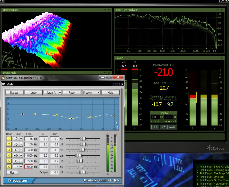

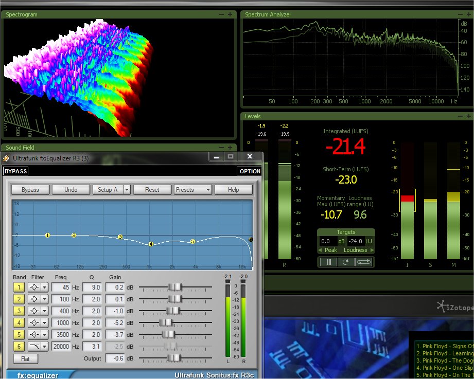

Using only casual listening, it was obvious that a lot was lost if the cutoff was 8kHz; 10kHz it became more subtle, but by 12kHz it was all but undistinguishable from the original. Only with very, very careful listening, which I didn't try, would I have been able to pick the variation ...
12k+ "undistinguishable " ??
I tried this (with an open mind - and a pc ).
David Gilmour - 320Kbs CBR mp3's .... the test source.
At 8k/10K = hi-fi ....ha ha
At 12k = I could tell , easily .. sounded like a lower quality 128-192kbs mp3 , a shallow sound field.
At 15K , I created a low pass preset so I could switch in/out all (most) 15-20k info ..
(below). I could see your point there , but at high volumes with a 100W amp
the 15K+ info was still readily noticeable , the placement of especially cymbals/bells/brushes. The 320K bitrate's improvement DOES exist.
I never tried this , but could always see the lack of 15k+ info in 192kbs material.
I really had to "crank it up" to hear the 15-20k content. No clicks or gaps , I even automated it so I didn't have to move at all. It's there and it counts !

Hmmm, looks like your filter is not truly "brickwall", so knee frequency slope and phase shifts could play a part here. I was using an 8191 tap, the maximum, filter in Audacity which means the cutoff is like a, well, brickwall: 0 to -120dB in close enough to a vertical line drop off ...

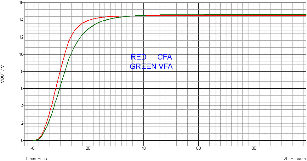

Actualy wanabee CFA amps do not really slew faster than VFAs ,
that s a common misconception that arise from the generic designs
properties that do not pay much attention to slew rate once an adequate
minimal value is reached.
IIRC i already pointed that with high Ft devices , 5ghz , differences
in speed between VFAs and CFAs become insignificant.
Below are the rising times of Gaborbela s old amp , popularized by Lazycat
in his variants compared to a symmetrical differential that has the same
standing currents for the IPS and VAS , with both topologies using
the same 5ghz Ft transistors.
