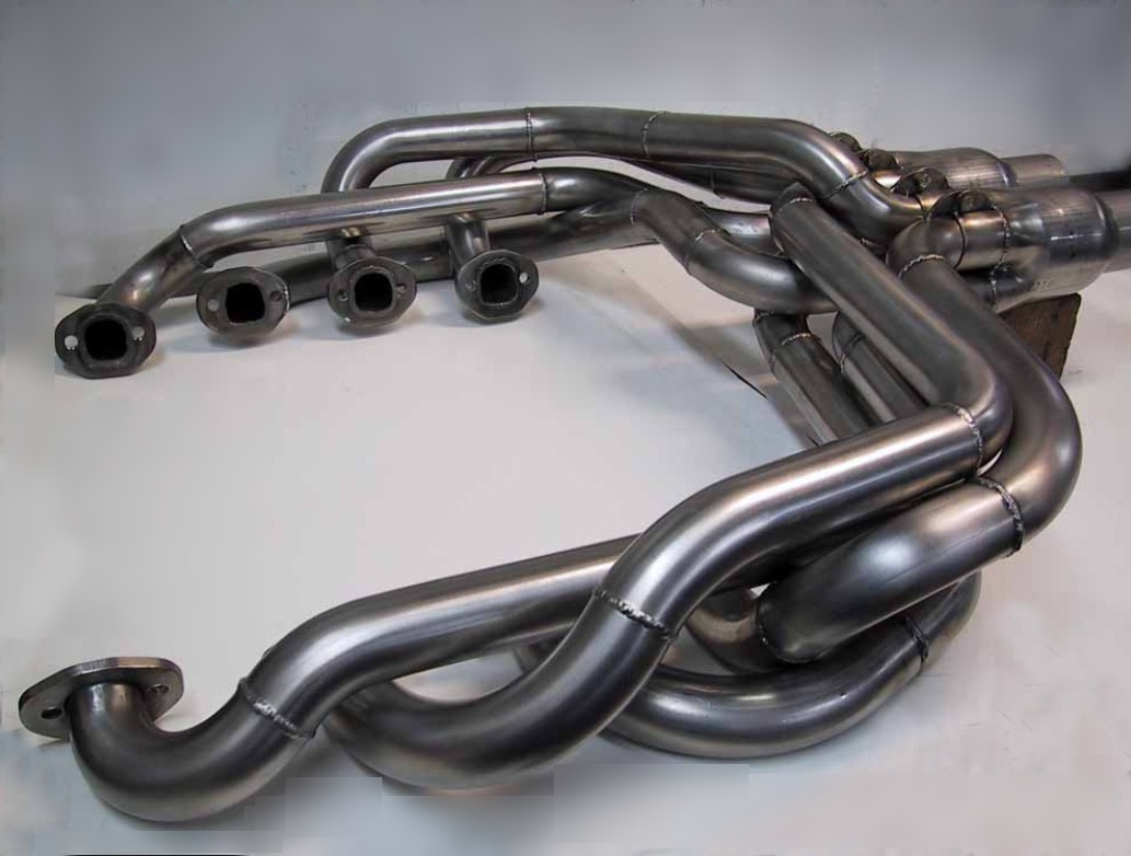

Sure, the sound depends on the construction of the exhaust (obviously). However, opposed to a flat-plane crankshaft, the firing order of a cross-plane crankshaft is irregular (LRLLRLRR or so), resulting in the typical V8 burble sound of US V8 engines (brab brab brab brab), like one of the cylinders is not firing. A nice vrooooom requires a much more complicated exhaust system, which rearranges the order of the exhaust pulses, see pic.
