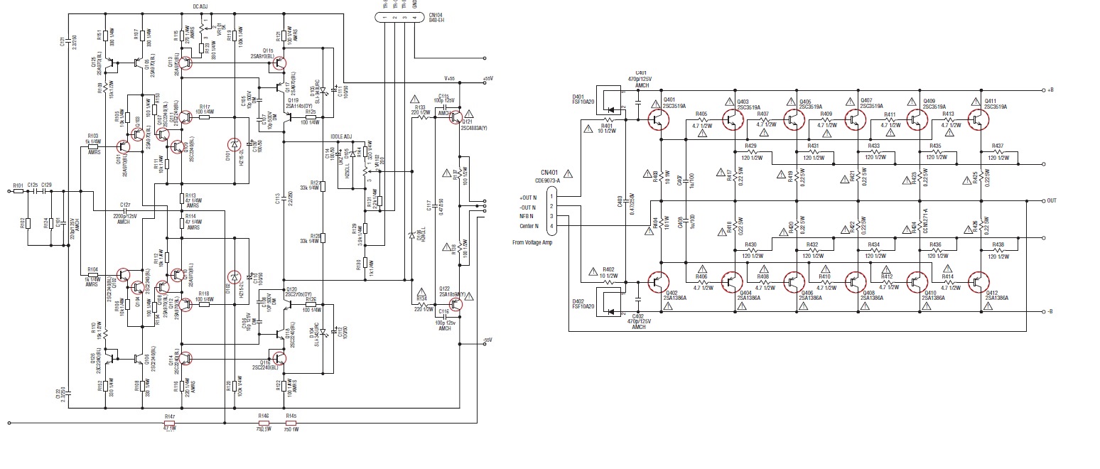

Probably low distortion due to the Hawksford cascodes.Here is an other CFB design, what is so special about it or not?
According to manso, the Miller compensation it is using must make it very special 😀.
And I made no claim that shunt compensation outperforms MIller TPC and TMC.I did claim so when it is used with the diamond input circuit in a CFA amp.
