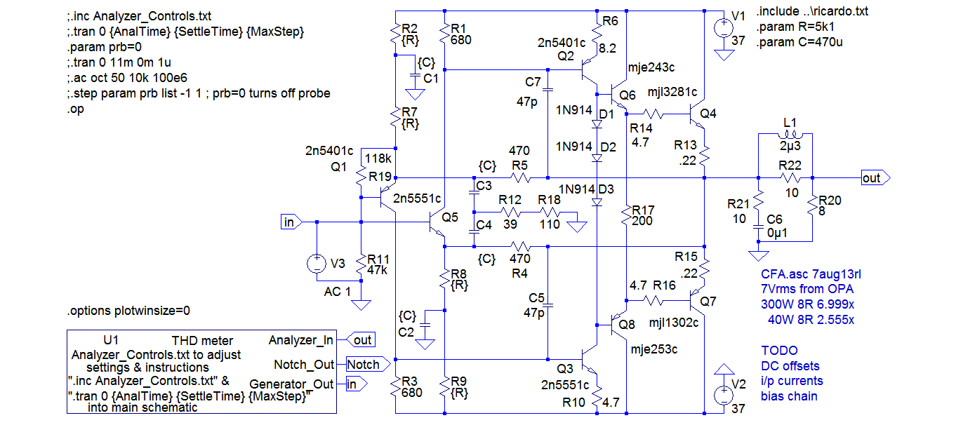

Manso, Can you post LTspice *.ASC of one of your simple CFA amps with good performance? Please 🙂
I asked for even a few numbers and have had no response yet, but I live in hope.
And you haven't replied to my enquiry about the "low noise CFB" that you mentioned.😉
Dave, I was going to just post a sketch but was inspired by Esperado, Bonsai, Manso etc to investigate further.
It appears JLH actually had several MC preamps & other stuff based on what I had in mind http://www.angelfire.com/sd/paulkemble/sound3.html
I don't think his MC amp is that supa and unfortunately, his topology has DC offset & other issues for a general purpose power amplifier. I got sorta carried away before admitting it needed a lot more work than I have time for at the present.
The inevitable caps in a CFA also means I can't use my beloved THD analyser without a LOT of extra work. Sorry about all dis SPICE world sh*t but this beach bum really can't afford to play 'real life' this millenium.
My interest is in the LN potential and also Bonsai said he had very good DC offsets. Alas, this appears to need evil diamond inputs which negates the stuff which appeals to me .. LN & simplicity.

So thanks for the schematic, an actually useful contribution.
This is your distillation of JLH?
Best wishes
David
Hardly a distillation of JLH or even a working model .. more rediscovering how flaky his designs were 🙂

For your application, may I recommend you have at least a high quality 10u film cap in series with your horns. I've done some very complex commercial systems with electronic xovers but IMHO, you'll thank me for suggesting you combine some simple passive xovers with the fancy electronic stuff.

Why do you use the dual feedback network? You are creating unecessary complexity. I can assure from a practical point of view, that the single network works exceedingly well. The sx and nx-Amps are 100% DC coupled.
