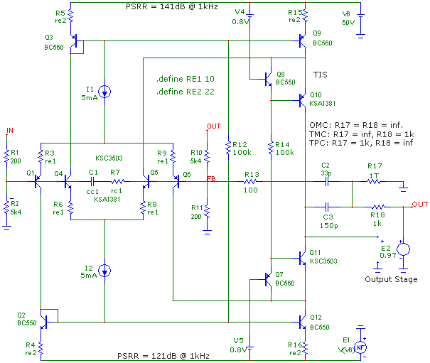

CFA vs VFA
Never? I returned back to VFA.
The first design is from 2008, the second one is from 2012. The latter performs spice-wise far better in every aspect (admittedly, not built yet).
Cheers, E.
[..] While, step, by step, so many designers witch have tried-it in real world never will return back to VFA
Cheers, E.
L.C. You are a cheater !!! You forgot to count the current sources
No, not really, jkuetemann compared VSSA in PeeCeeBee version that means only six transistors compared to SYMEF's 18 BJT-s. That means basic of them all can beat VFA. Just imagine what CFA in more accurate version can do.
Cheers, E.
Yes, yes all true in sim, but as always: build, listen, compare, know. In that order.

jcx wrote ". . . . and if CFA is single pole compensated while VFA practice today does understand 2-pole schemes fairly well then 2a 2-pole compensated VFA can easily beat CFA in loop gain to beyond 20 kHz do you even know how how to add 2-pole compensation to CFA?"
Yes, I have tried that and got 2ppm at 20k. Importantly, this is happening with circa 55dB loop gain at that frequency but would have to see the results in a practical amplifier.
What is interesting is this level of performance is with only 55 dB of loop gain at 20 kHz. I'd be tempted to suggest his reflects the inherent linearity of the topology (output power c. 280 W into 8 Ohms).
Anyone chasing sub ppm distortion blindly, and using this as a measure of amplifier performance is IMV sadly deluded.

I am perplexed how you can be sure you will distinguish good designed CFA from good designed VFA in double blind test. Or you just don't believe in double blind test because you are sure CFA is better?
hi, Edmond, so, we are waiting to your listening impressions. Because this is all about. I don't pretend neither i will never use anymore a VFA part somewhere in a future design, but...you know... you design or build a new amp... and it sound not so good as your previous one...admittedly, not built yet..
Look what happened when i tried to provide two files (one VFA, one CFA) of the same amp that sim experts can play with in order to explore and compare technical aspects of the both technologies...Nobody explained how "better VFB topology" turns it's "superior" technical qualities into better sound. The only available subjective comments testify that CFB sounds better.
I indicated what i believe a nice and simple way to see where to look-at in the closed loop.
Who explored this here ?
No, some prefer to pretend my files (just sim tools) are not working and fire me.
To Wahad, or JCX, my CFA currents and polarizations were tuned in my LTspice to minimize distortion (so called class C gives 0.001% with a 1000Hz signal at +-55V) in a total blind experimental way. I made no calculations.
I just run them today, as-it, to make those images.
I don't believe in sims, but i believe in the *relative* numbers they provide.
I don't want to loose time to justify more because it is boring and time consuming to play with sims and provide hundreds of images just to pretend in forum my pseudo 'have a bigger' than your: it does not play any note of music.
So, please, if my files or my models, or anything does not work in your home, i'm far to be an expert in simulation, as i just begin with ... play with the current source and input device collector values the way you want for they work with your models and your simulator in order to *explore* for you and the other members (in an objective manner, not to demonstrate your religion) the ways the two topologies behaves. It will be more productive than to fire me, and that was all my purpose.
Bonsai, may-be you can help us on this ? (and answer to my question about your advanced error correction work ?
