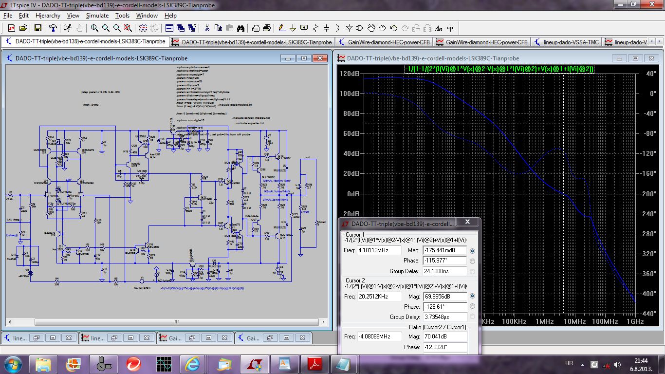

Dadod Im yet to find one TMC or TPC amp here that has 75 degrees plus phase margin. This is of prime concern for me, like I said if I had to undercompensate my CFB better THD results.

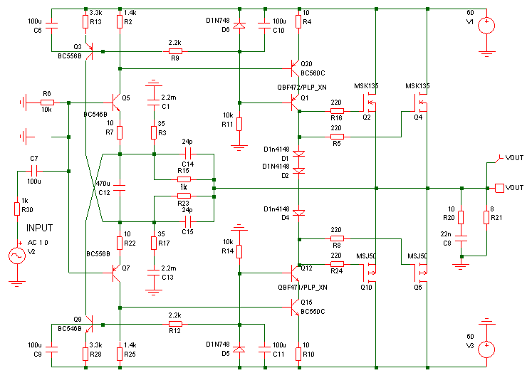

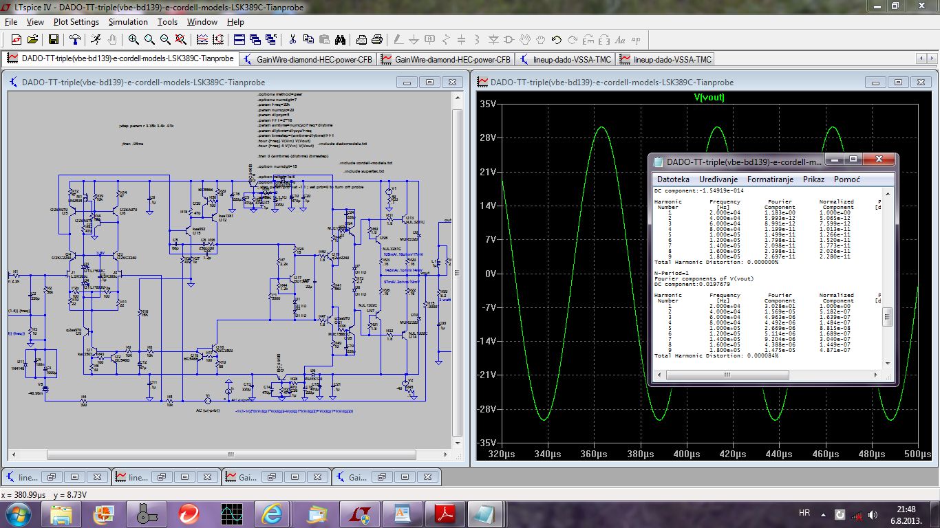

OK Manso, I am not JCX but here is my TT TMC VFB amp. Could you beat it with your CFB amp. I tried but can't go close to it even with the same PHM and GM. this is just thecnical challenge not listening perception.
BR Damir

JCX is right about your non working file.
I already pointed that your so called "VFA" has a VAS
that work in class B , not to say C.
For the sake of the discussion i point what you did forget
when "calculating" your circuit :
You erroneously assumed that the input stage current sources
1mA or so current is entirely running through the input transistors
but thoses transistors emitters are at +-0.65V potentials respectively
for the PNP and NPN input transistors , as such there will be 0.65mA
current that will be drained by the 1K FB resistors that goes to the output ,
hence only 0.35mA will go through the input transistor , creating only
0.49V voltagge drop acrross the VAS base resistors....
Here your schematic so everyone can judge by himself.

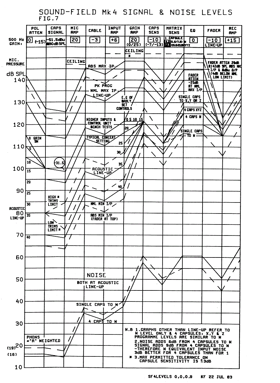

There are many factors in the noise of a large system and you have to consider where the important ones are if you not to have your horn tweeters hiss at you. The range around 4kHz is the important one which probably means attention to both your compression driver & horn tweeter paths.
May I suggest you do a levels & noise diagram on your complete system from player to horn(s)?
Attached pic is for the Mk4 Soundfield and is similar to what should be done on a big mixer. It shows overload levels & noise at each stage. It is for -10dB and -25dB on the fader as these were the most important positions.
You might want to do the chart for -6dB (worst case) and -20dB (typical use) on your Volume Control.
Doing this will immediately tell you what you need to improve.
A simpler example is described in NWAVguy's O2 headphone amp but the same principles hold.
In this (and your) case, it is vital to have as little gain as possible after the volume control. Anyone know of good 150W 8R voltage followers 🙂
You need to know the approximate gains (and any electronic EQ) in the 4 amps for your active system to do this stuff properly.
IMHO, juggling gains & levels systemwide will be more productive than attempting 1nV/rtHz Ein power amps. (BTW, don't forget that running too high a current in BJT LTP i/ps raises the current noise which is important with volume controls.)
