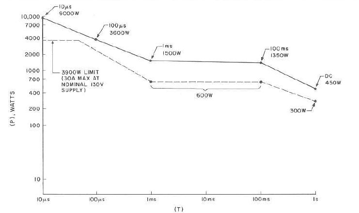

Ohh no, not at all. 1uS is a limit that goes with say, 50V Vce and 10A Ic. If you limit it to a period of say 10mS you may dissipate say 40V Vce with say 8A (I'm just making up these numbers to show the principle).
So the SOA is basically three-dimensional: combinations of Vce, Ic and time duration determine whether it is 'safe' or not.
See for instance fig 1 here: Safe Operating Area calculations
So, if you measure say a particular Ic and Vce combination you need to decide how long you can allow that before activating the protection. Problem is that the Vce and Ic combinations change dynamically so you need some way to keep track of history and present and then decide that now is the time to activate the protection. Or not.

I am referring specifically about the secondary breakdown part of the SOA curve, what you are saying applies to the thermal breakdown. See this reference, I think it will clarify the time dependence of FBSOA and RBSOA.
Yes. Thermal breakdown as a result of exceeding the SOA. Good paper.
As I said: SOA is basically three-dimensional, defined by Vce, Ic and time duration.

If the device enters the secondary breakdown area, it will self destruct in (more or less) 100nS. This is not the case for the thermal breakdown, the time constants are much larger there. So you may say that while thermal breakdown is a slow process, and whatever method (analog or digital) will do, the secondary breakdown tolerance is zero - and very fast electronics is required for protection.
If the conditions at the load short incept throws the output devices in secondary breakdown, then your slow solution won't do it's job.
But I concede that a 100% failsafe protection solution against secondary breakdown in audio amplifiers, analog or digital, is in 99.9% of the cases an overkill. Industrial power modules are a different story.

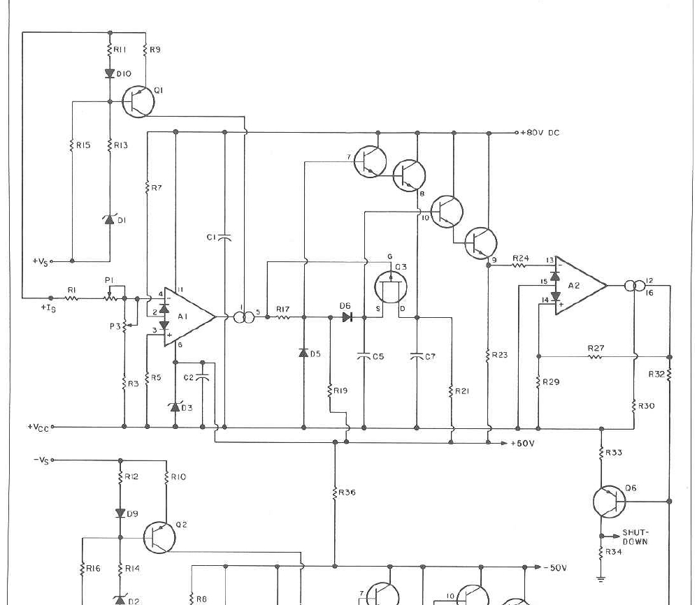

The protection should be designed to prevent the amp to end up in 2nd breakdown. That means you need to 'keep an eye' on the development of the Vce/Ic combination over time and pull the plug when you get close to the danger zone. This takes time, and it is very simple to time-bias this process. If, for instance, you are in a situation where you need to activate the protection after 10mS, you can bias it to 9mS which gives you a leisurly 1mS to activate the protection. There's really not any time pressure here.
What makes the design of such a system interesting is that all of this is dynamic. The Vce/Ic combinatios change continually, and the allowed SOA also varies with the current heat sink temperature. These are interesting issues 🙂

Here is part of the protection system I did in 1984 or thereabouts, attempting to model the SOA. It's rather complex and if I look at it today I'm not sure I still understand what I was doing at the time. But it DID work as designed 🙂
