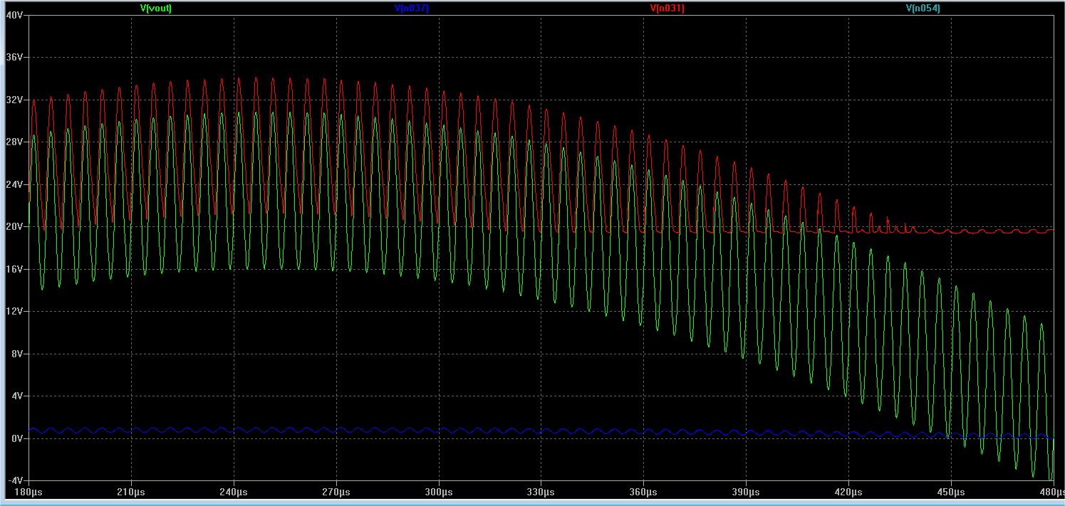

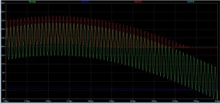

The [clipping waveform] in post # 34 is horrible, by comparison. Of course this is only at 1kHz - the real deal is what happens at 10kHz ;-)
The antisaturation clamp diode approach in Bob Cordell's 35 year old AES paper on his power amp (link), comprising D5, D6, Q18, Q19, works very well in a wide variety of amplifiers ... including folded cascode "one gain stage" power amps. They clip (and recover from clipping) quite beautifully, even at 100 kHz. 10 kHz clipping? Pfffft. The Cordell template gives you the opportunity to experiment with better-than-1N4148 diodes for superb clamping, such as the ones that Giovanni Stochino employed in his 300V/usec power amp.

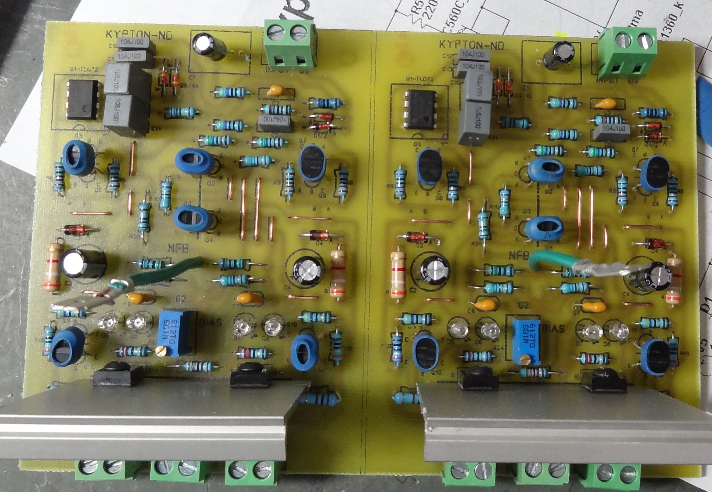

Good for newbie's , why ohh why - is everyone bogged down with the
"blameless". It was the first that I built and sparked further reading
and progress.
Trying to move solid state into new and better stuff (below)
20khz clipping , even 200khz clipping is effortless (and saturation free).
I would of thought the 5th edition and on would of advanced to
what is now available. This forum is the greatest book on the
present state of SS amplification.
Amp in the picture blinks the cascode led's on overload. I have another
that uses a infrared opto (with the other 3 just IR) to average the overload(s)
right at the cascode. Too much and it triggers a SS relay to either cut off
the speakers , or it could even attenuate the input.

What a badly designed audio power amplifier in the video of post #34. It is ill-behaved during clipping and creates tweeter-killing ultra high frequency spikes on the output. Ugh.

You can never escape saturation and storage time if the transistor base is overdriven which is going to happen in the real world. Another option would be to clamp the input signal as the amplifier output starts to clip - I think Bob Cordell did something like this (Klever Klipper?) but for the penny or so you pay for a BAS21J, I think its a good all-round solution.
On low loop gain amps, you don't normally get this problem - eg the class A sx-Amp clips very softly - kind of like tube amp, but the kx-Amp, which has a moderately high loop gain does not clip cleanly without anti-sat diodes (I used 4148 for DIY ease of use in that one).

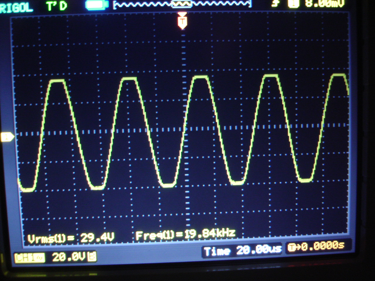

This is clipping of my very simple 120W CFA design with lateral OPS. It does not use any clamp diode, just IPS clips nicely by itself.
Schematic post before.

You need to really overdrive it hard dadod - If the input sensitivity is say 1V, I put 1.2 or 1.3V in so there is a long flat-top period on the output waveform so you end up pumping lots of excess charge into the gain stage transistors - typically the VAS stage.
