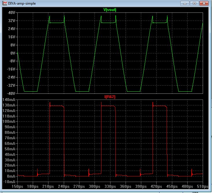

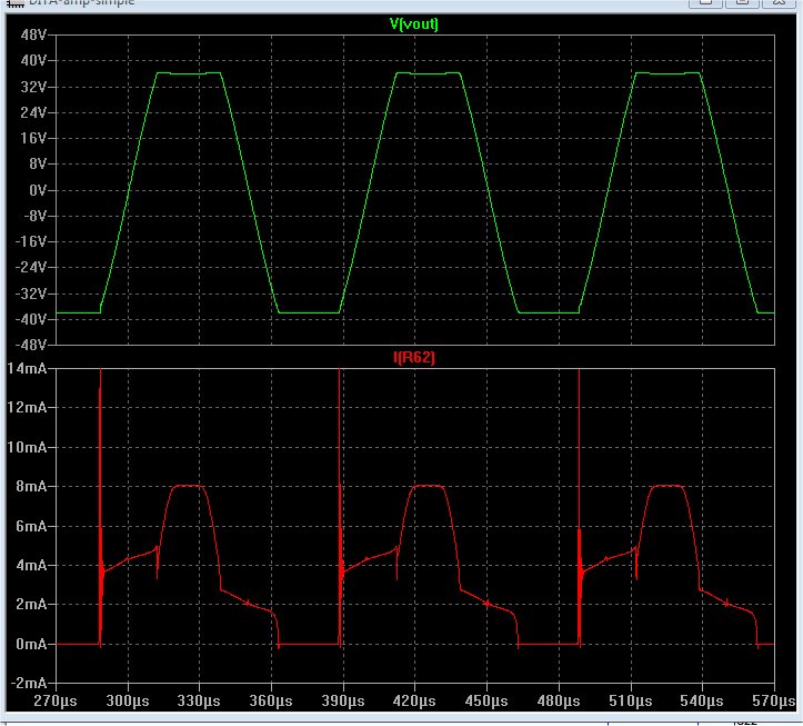

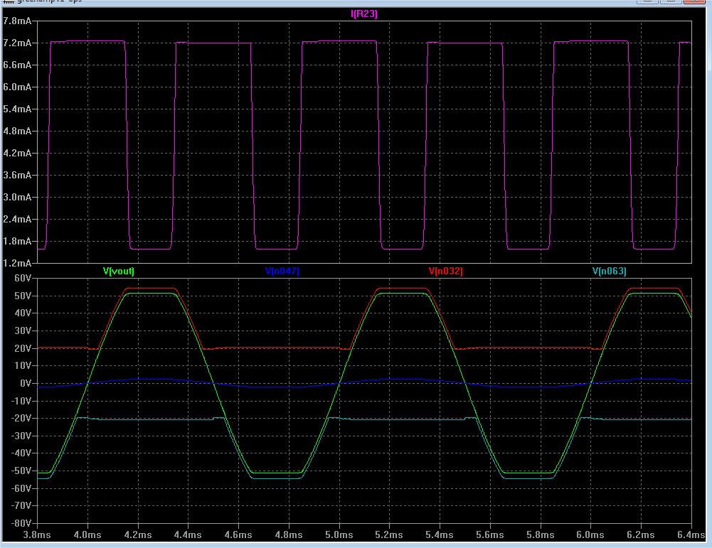

But people DO clip their amps. Best to design with that in mind. Also consider the stress of components when in saturation. Self's "blameless" is among the worst , needs a anti-saturation diode and resistance at the beta enhancement tranny. Still gets hotter at overload. Symmetrical stages are easier to tame , some even clamp saturation. Driving a hungry Subwoofer , this is preferred by me.
Accidents can also happen , too high a input level / or feedback. A amp that is anti saturation might do better and survive.
Below 1 is native clamping , 2/3 is a "blameless" with and without "the fix". Even with "the fix" , the blameless loses phase margin and momentarily oscillates as it recovers from saturation. Not good for tweeters or transistors.
OS

ostripper, that's exactly what I find with plain 'Blameless' in real life. Can you show circuits of your 'fixed' and 'unfixed' amps from which you did those simulation?

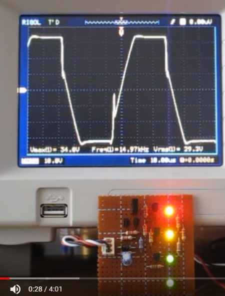

What a badly designed audio power amplifier in the video of post #34. It is ill-behaved during clipping and creates tweeter-killing ultra high frequency spikes on the output. Ugh.
_
APEX amplifier clip
YouTube
The clipping recovery/behaviour doesn't make a lot of difference to whether your tweeter will be damaged. The damage is done by the large amount and high level of high harmonics that are created by the clipping itself.
Of course if the clipping hangs in there for ages, it is made worse, but even when it recovers nicely and quickly, the damage may already have been done.
The amp shown in the video linked to above clips very nicely and cleanly, as well as it can be. Recovers well, no hangover. There are some onsets of oscillations seen which he fixes by apparently playing with the compensation, but the clipping is exemplary. The one in post # 34 is horrible, by comparison. Of course this is only at 1kHz - the real deal is what happens at 10kHz ;-)
