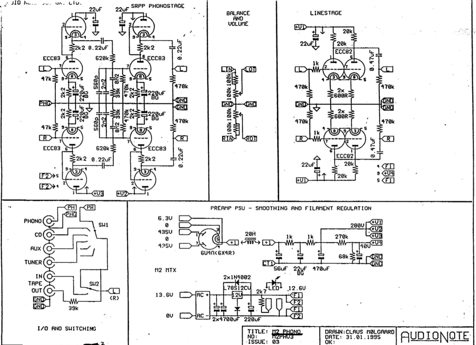

Good day, I would like to increase the gain of my riaa mm. The amp only uses two twin tubes (ecc83+ecc88). Is there any way of doing that ? Unfo I cant find the schematics of the riaa anywhere even if I am pretty sure is taken from the riaa of Audio Innovation P2 using same devices. So let's presume the schematics is the below, what would u suggest in order to increase the 37db gain of present scheme ? Many tnks beforehands.
Ciampa.
I could rewrite and make a new board eventually but I'd need to remain w/in max two devices as filaments psu can only handle two I believe. As a direct plug-in alternative I cd plug another ecc83 for example but wht passive components do I need to change ?
Hi Ciampa. How long are your cables? That design does not work well with long cables as it is.
Replacing the E88CC with another high MU triode will definitely require an additional cathode follower. You could use a MOSFET to do that if space is limiting and we could set it so the circuit draws similar current as it now does. but if you really have an M2 then you have lotsa space to work with. 🙂
If your cables are long, then test it with really short ones... less than 15 cm. If that sounds decent, but you really need to use long cables, then we can easily try a MOSFET follower after the E88CC.

if you want to swap the E88CC then I would also suggest we calculate a correct bias point and appropriate anode load.
A high MU triode like ECC83 as a differential amplifier will not drive anything alone. It needs a follower.
BTW - the combination of ECC83 and E88CC should yield enough amplification for MM. This is why I asked about the length of the cables...
You could replace the E88CC with something else though.. like maybe 5751. but its NOT a drop-in replacement. 😉

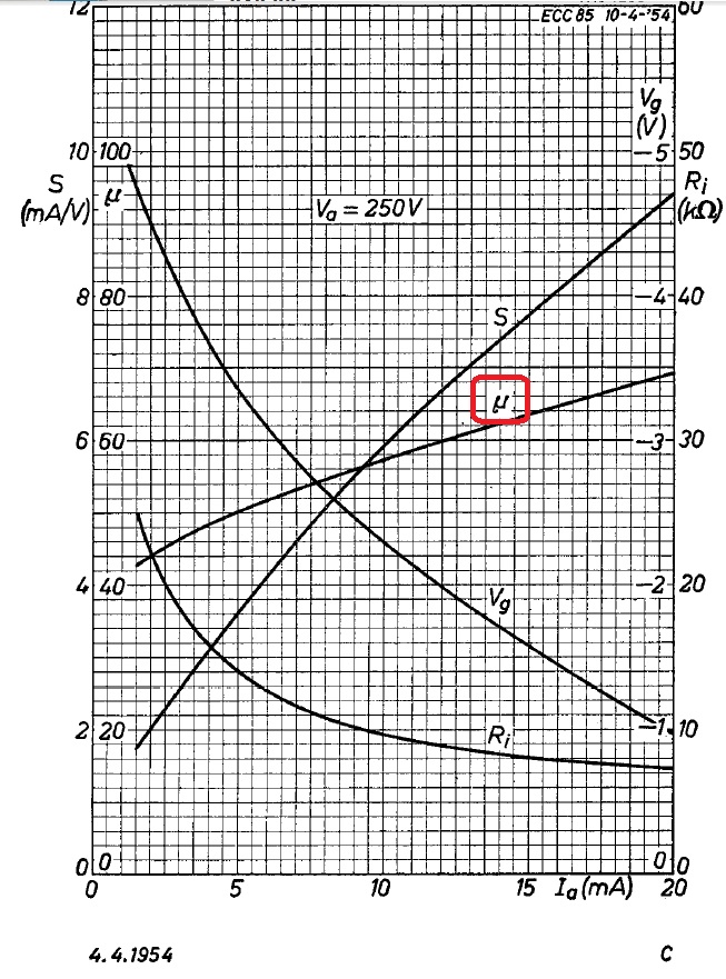

Ok, I don't consider myself an audio snob. But every time I have tinkered with 12at7 and it just never sounded right.
The ECC85 is basically a 12AT7 on a ECC88 base.. its a variable transconductance tube. It works very nice in the AGC circuit in VHF/UHF tuners. I just don't consider it for Hi-Fi any more.
I wouldn't want to mod a really nice audio-note phono amplifier this way. Your choice.
Is your cable long or short? Consider that simply trying a shorter cable might be even easier..
Ciampa.
This is a very unconventional topology!, you could get 38dB gain from two ECC88 tubes, without the use of the ECC83, and the passive network they employed!!
