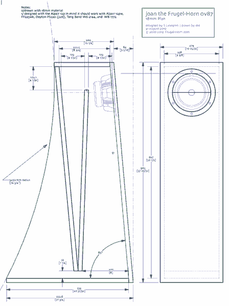

Poke taken to heart. Here is a teaser. Scott is QCing it. This one was a tough one. Took many iterations to get here. Then someone needs to build it to see how well it works.
About 27x96x55 cm (wxhxd)
designed with the Alpair 12p in mind it should work with Alpair 12pw, FF225wk, Dayton PS220 (just), Tang Band W6-2144, and W8-1772
dave

Nice!Poke taken to heart. Here is a teaser. Scott is QCing it. This one was a tough one. Took many iterations to get here. Then someone needs to build it to see how well it works.
dave
I could do a beta build only I don't claim the experience with the type of design to critique them well.
Btw, I also like the driver cut out proximity to the top for doing A12pw with a tweeter/horn super tweeter or ribbon in open air on top of the cabinet.

Ah, I see. Joan of Arc no doubt, given the sweep of the curved back.
Curved back from Ron Clarke…
