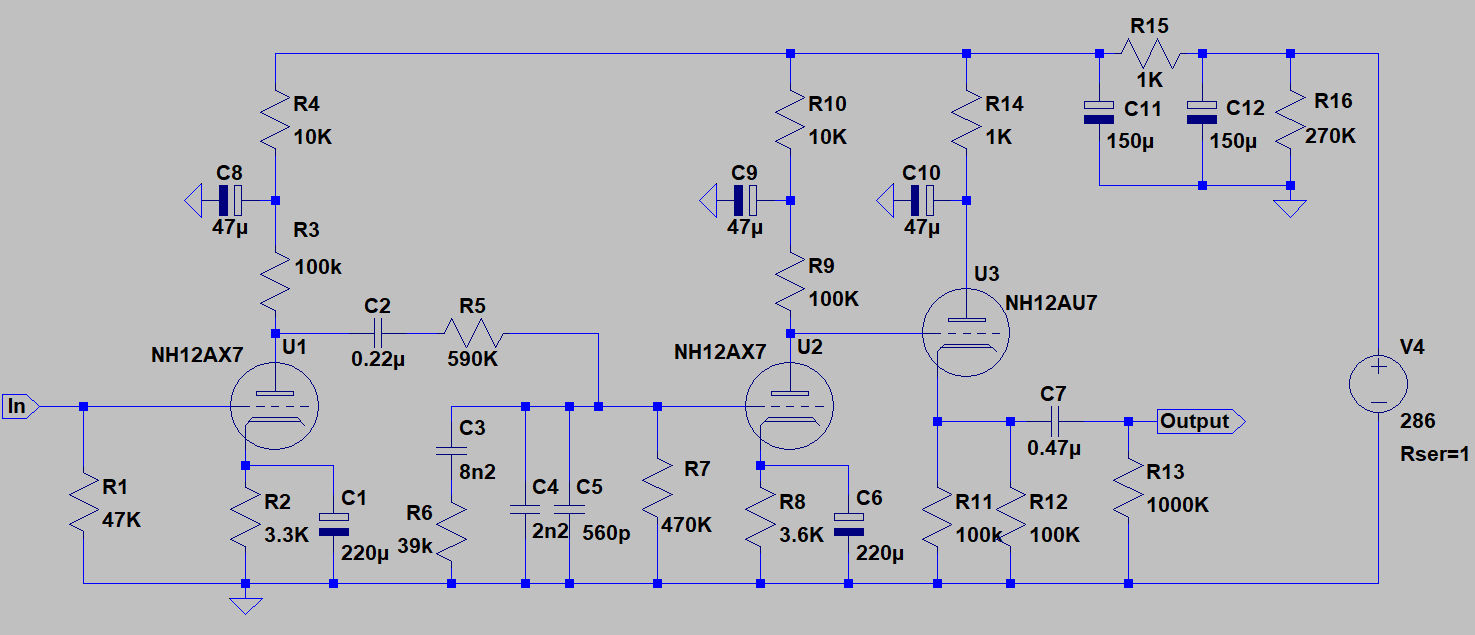

Dear Oracle,
I have an Audio Innovations set, 1x S200 Preamplifier MM model, and 2x 200 MK2 power amps.
I want to install the MC section and upgrade the preamplifier.
I need the schematic for the preamp, does anyone out there have one or know where I can get one?
I already have the power amp schematic.
Thank you

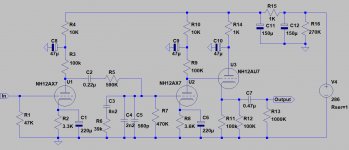

If I remember correctly it was the original AI 200MM schematic.

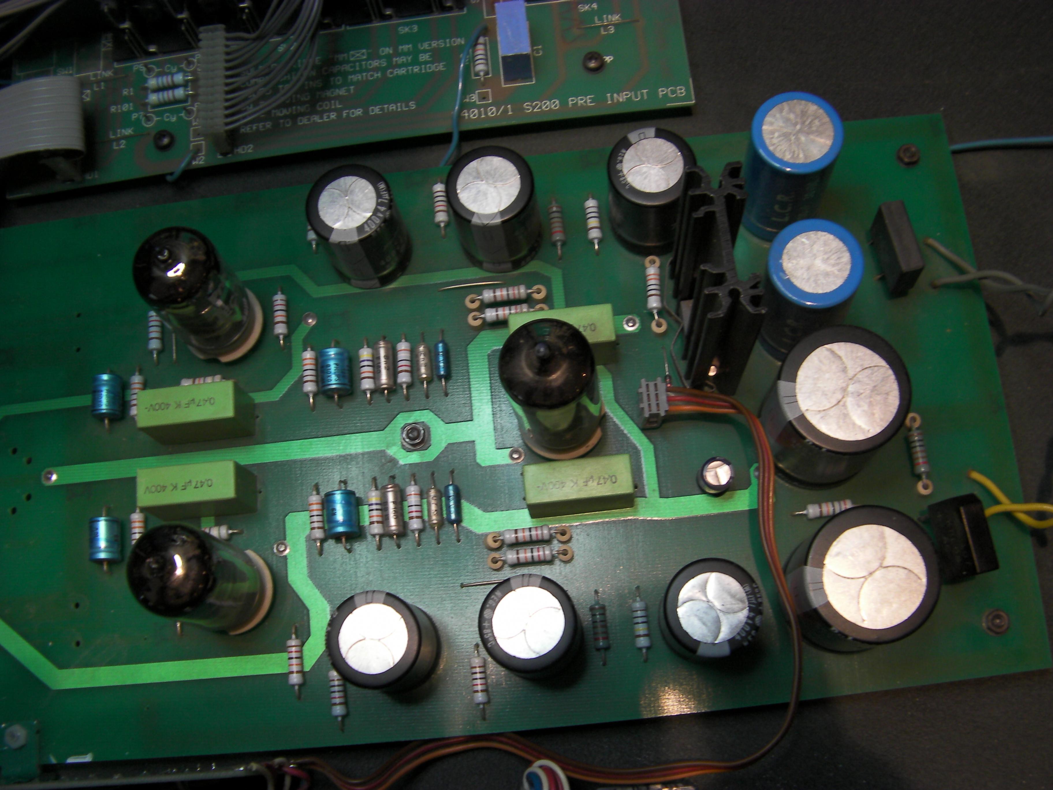

Hi Euro21,
Thank you for the schematic but it seems that it does not agree with what I have on the bench. I notice that my amp has 4x 0.47uF caps and your schematic only 1? I have attached a picture of my amp for clarity. If you have any other leads or schematics that would be great.
best
Steve

LED (green) bias in first and second tubes cathodes
I killed R//C in cathodes, and exchange its to old 5mm green LEDs.
direct phono input
I inserted Cardas RCA sockets in the rear side "MC" holes as direct phono input.
There is a (input) ribbon cable in the front of the main panel.
I killed it, and connected directly to pins the input shielded cable from RCA.
Euro21,
That is great....
Have you a diagram for your LED mod, I do not understand how this works or where it fits in the schematic? Do you mean; replace the 220u cap // 3k3 R and 220u//3k6 R in the schematic with green LEDs? If so, do you not need a resistor to limit the LED current?
