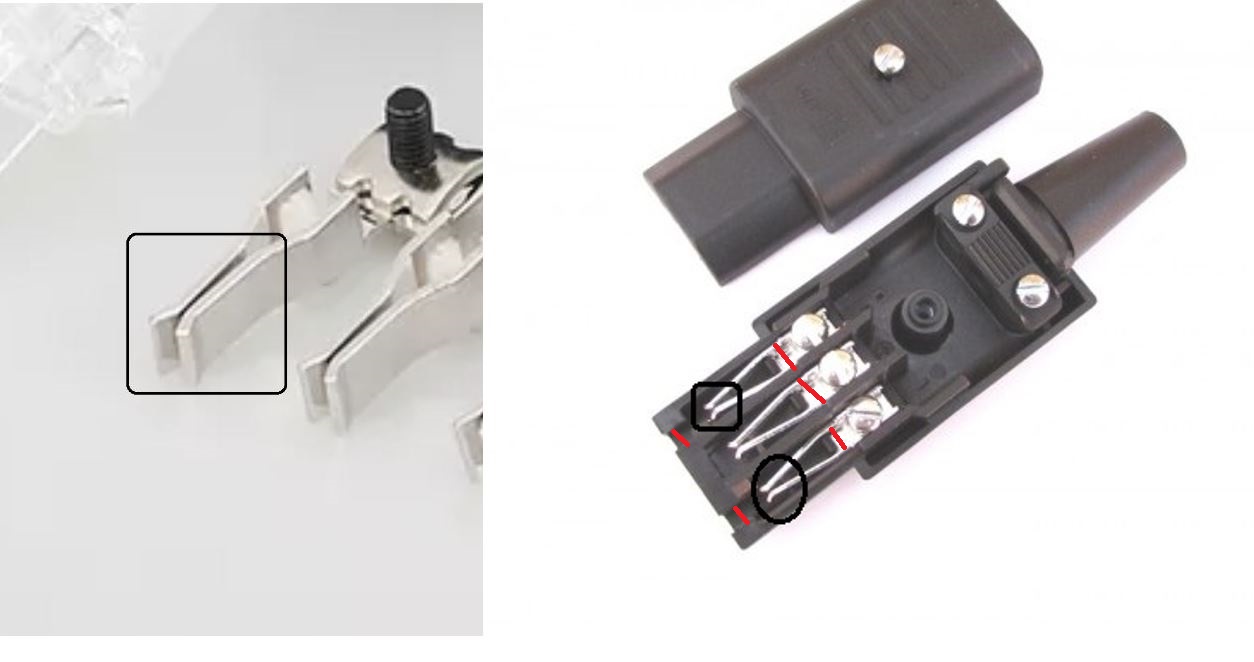

Please see the image below – the contacts show on the left are from a so-called audio grade C13 socket, a standard Schruter C13 on the right – please consider the design of the contact that opens when the male plug is inserted – the male pin will open the socket part but because of its width it doesn’t make contact with the whole internal surface are the V shaped design results in a relatively small contact area. If you observe the contact from the ‘premium’ connector on the left you will see that – due to a different design – the contact area is much greater and therefore better, mechanically and therefore electrically
This may also explain why my original Schruter terminated lead almost pulled it’s self out of the amplifier!
That's an interesting comparison between the "audio grade" and Schurter female sockets.
However, your quest is for an audio grade male IEC socket where the pins would require to have the same standard dimensions as those of a Schurter.
Perhaps that's why IEC male sockets are not a prime candidate for audio grade improvement.
