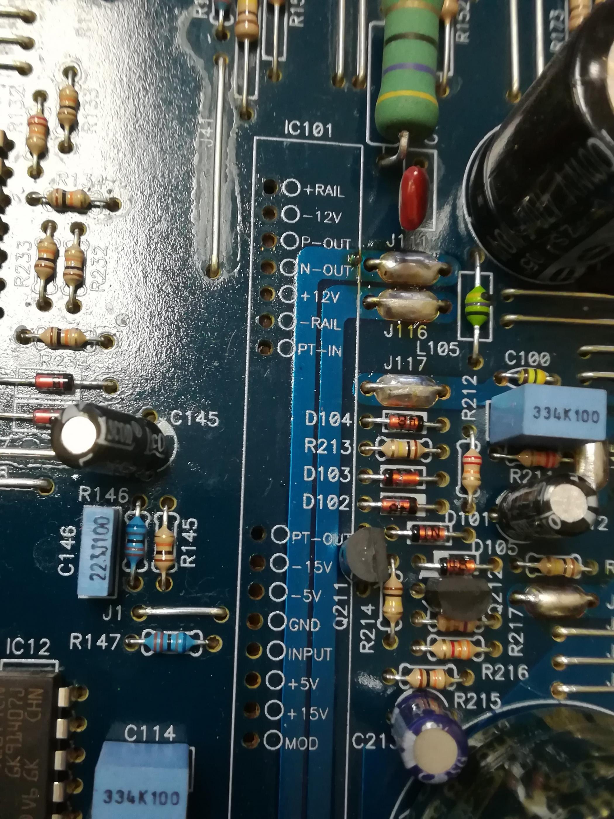

Remove the drivers and check/compare the amplitude on the collector of Q7 and 11. Also confirm that they're swinging to their corresponding rails.
amplitude is still not matching, please see below:
positive rail/drive
neg rail/drive
positive rail/drive
neg rail/drive
Just to confirm, the waveforms on the bases and emitters of Q7 and 11 are of the same amplitude. Is that correct?
And the resistors R22, 29, 13 and 27 are all within tolerance. Is that correct?
Yes the waveforms are of equal amplitudes. The 470 ohm above the transistors are within tolerance, will confirm the rest tomorrow.

Please upload all images that way. All of the other images were lost.
The PT-in will be at the negative rail.
PT-out will be near 0v.
MOD will be a square wave swinging ±5v.
