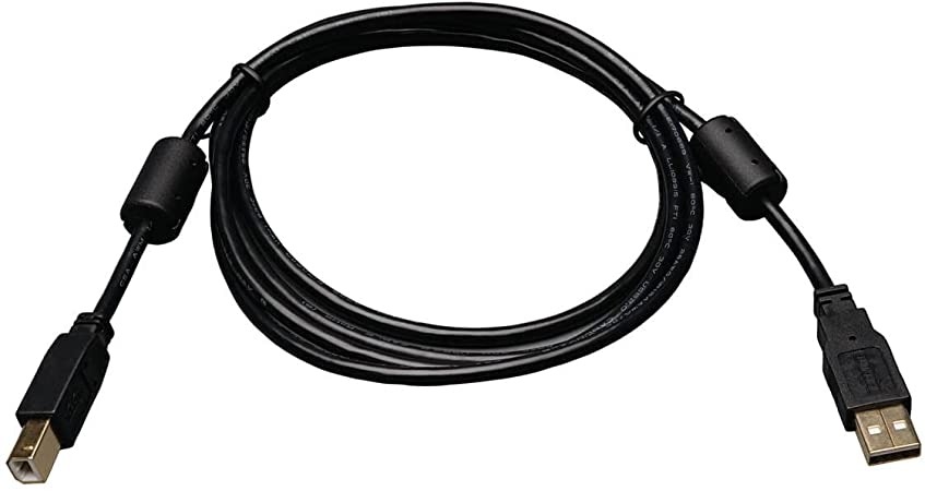

To expand the scope just a bit: I've been happily running my Gustard A18 DAC (AK4499) for a year and a half, using the supplied USB A-B cable.
Out of curiosity, I recently ordered an Aliexpress Hi End 5u 24K Au 4N 99.99 OFC Cu blabla for $25.
I wasn't expecting much, but still I braced myself for a fight because I know from experience differences between cables are not always easy to assess. Wrong! The diff are immediately audible: the original battery charger grade cable has more pronounced, possibly more refined highs, kinda like my ESL57, and the Ali has much fuller mids, which is closer to my Jecklin (RIP) Float electrostatic headphones.
Which is better? I don't know. The Ali cable has been in my system for a while now, but this because I'm too lazy to swap cables.

Out of curiosity? If that's what you call cluelessness....
A 'USB 3.0' cable made of Canare Star-Quad microphone cable? Oh dear...

Another clear case of expectations bias!I wasn't expecting much, but still I braced myself for a fight because I know from experience differences between cables are not always easy to assess.
How experienced audiophiles can discuss sound of cable carrying digital signal is beyond my comprehension.
For a DAC cable to change sound, digital signal content should be changed or resampled. That’s incredible feat for a dumb copper wire while there are error correcting protocols used on USB bus.

USB cables carry +5v and ground in addition to 2-signal wires. A problem that has been seen before is that RFI/EMI can be conducted from the computer ground into a dac. From there it can find its way into analog audio circuitry such as the output stage. For that reason some USB cables are fitted with ferrites. Some USB boards are galvanically isolated and run on clean +5v power from the dac end.
The situation gets more complicated when a dac, or at least some of its USB circuitry, is powered from USB +5v power. IIRC it was KSTR who measured different artifacts at a USB powered dac's audio output depending on where the digital audio data was stored on the computer. A spinning disk drive modulated the computer power and thus the USB +5v more than if the digital audio file was stored on a memory stick.
Given the foregoing, perhaps the cables varied in their performance at frequencies where RFI/EMI was present?
Expectation bias was on your part that such a thing could not ever happen?
Thanks Mark, you beat me to it. 🙂
It's a well known fact the USB cables have a higher than usual sensitivity to noise, e.g. the Murata paper, even though in my case, the DAC has its own power supplies. What really surprises me is the effects of the sensitivity on the voicing of the system. I love snake oil.

Markw4, you present a case on “what evils could happen if ..”.
Any decent DAC has its own PS or has a separate input for 5V supply, so USB cable carries only digital signal.
I don’t always approve ASR approach to sound evaluation, but must agree with them on some conclusions that are not pure subjective impressions or speculations.
It is also well known that D+ and D- should be routed as a 90 ohm differential pair, on the PCB and within the USB cable. But who cares, lets just use Canare Star-Quad microphone cable instead of proper USB cable, because who cares about eye-diagrams, reflections and such when you can have gold plated plugs and fancy looking sleeving. A new level of ignorance when it comes to 'audiophile' cable BS.
If the sound is different with a different cable then the cause may not be known for certain. If you hear it then its obviously real and there is some physical cause. If someone else hears it then they are hallucinating? If so, then maybe it was you hallucinating in the first instance and someone hearing an obvious physical effect. Of course you never hallucinate, only other people do.
