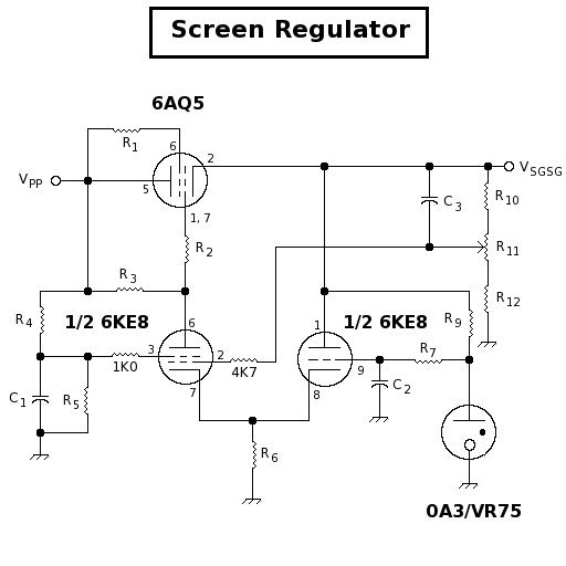

Say what! If the characteristic calls for a Vsgsg= 150V, then best to supply that by means of an active screen regulator. That'll stabilize the screen voltage, and present the screen with a very low AC impedance to ground, both very important for good linearity. For a project I did with 6BQ6GTBs, I included this screen regulator.
