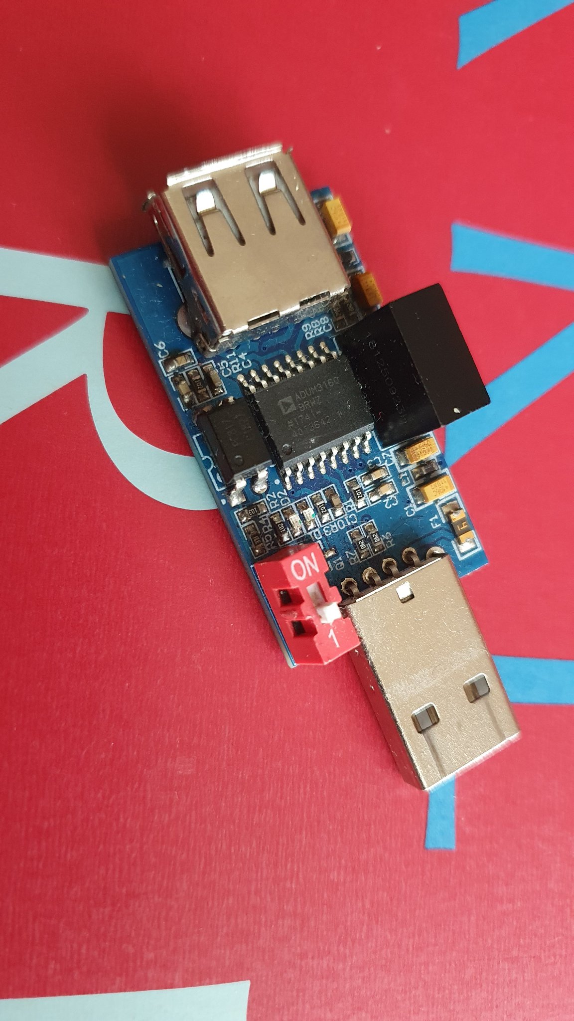

I use a USB isolator for circumvent the problem. Some ADUMxxxx.

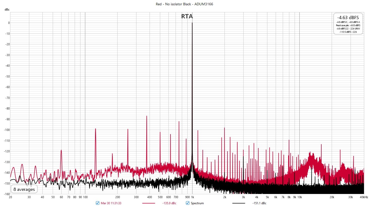

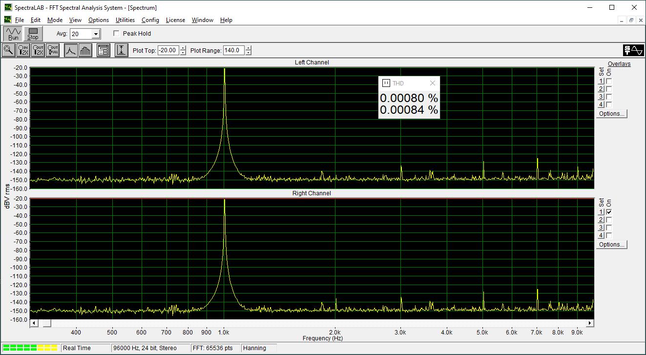

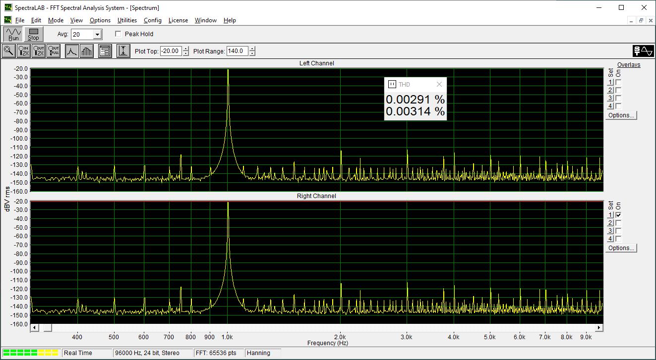

Here's an example of what such an isolator can do. This is a "loopback" between just a DAC and an ADC, both connected via USB to the same computer, with and without the isolator. (The DC power in this case is isolated by using a separate supply for the downstream side of isolator. Some commercial devices use isolated DC regulators, maybe based on SN6505's or similar. Batteries work, too.)
Prior to trying the isolator, I tried using a second computer for the ADC side. It was plugged into a different outlet on a different AC mains circuit. The spectral plot was just as bad, just different in composition. Using a laptop running on battery for the ADC side gave essentially the same result as using the isolator. Using an isolator is way more convenient, at least for me. E1DA sells an isolated version of their Cosmos ADC to make it even more convenient. Also, different DACs gave similar results.

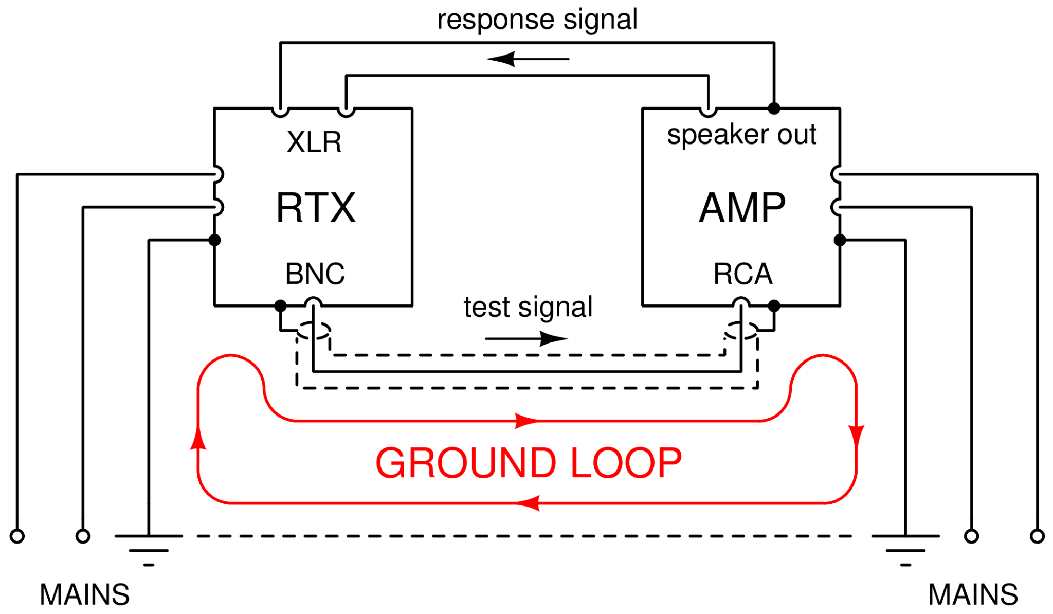

The issue I'm running into is that the pc's USB connector is internally connected to the pc's chassis (and thereby grounded). So by connecting the USB cable to the pc the 10 Ohm resistor in the amplifier is shorted and there is no longer a separation between the audio ground and the chassis ground.

How do I connect a BNC-probe to a balanced input?
Where is the BNC? On the amplifier or on the soundcard?
I guess I should have said differential input to make my point. You'd connect POS to the audio output of your amp, and NEG to the audio GND of the amp. There was an RTX6001 tutorial a while back here on diyAudio, which explained the grounding issue and the benefit of using a diff/balanced input on the soundcard. However, I believe the tutorial went dodo when they upgraded the software/system. I attached a drawing I made back then.
If your soundcard does not have a differential/balanced input, I'd simply lift the chassis ground during the measurements. The amp is on your workbench, and you know the ground is lifted, so you simply keep your fingers off. Put the ground back after the measurements, and before fingers or other vulnerable things get close to the amp.

Problem solved for now using only TR from the 6.3 mm TRS connectors, Tip = hot, Ring = audio ground, Shield not connected. I made a short adapter cable to BNC. Cheapest solution too.
Both my Steinberg soundcards can handle this well and measurements are not affected by doing so (not in RMS voltage, not in the distortion measured).
