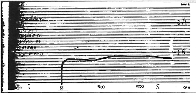

The A9 satisfies all these points well with the partial exception of the third, due to the high polarization (0.42 volts drop on the emitter resistors, 2.6 volts total polarization), and therefore has a small excess of thermal correction with increasing temperature. The demonstration is in the image that shows the trend of the current: the A9 goes to full operation almost immediately; the significant increase in temperature that follows a few minutes after switching on causes only a small and negligible drop in the bias current.”
